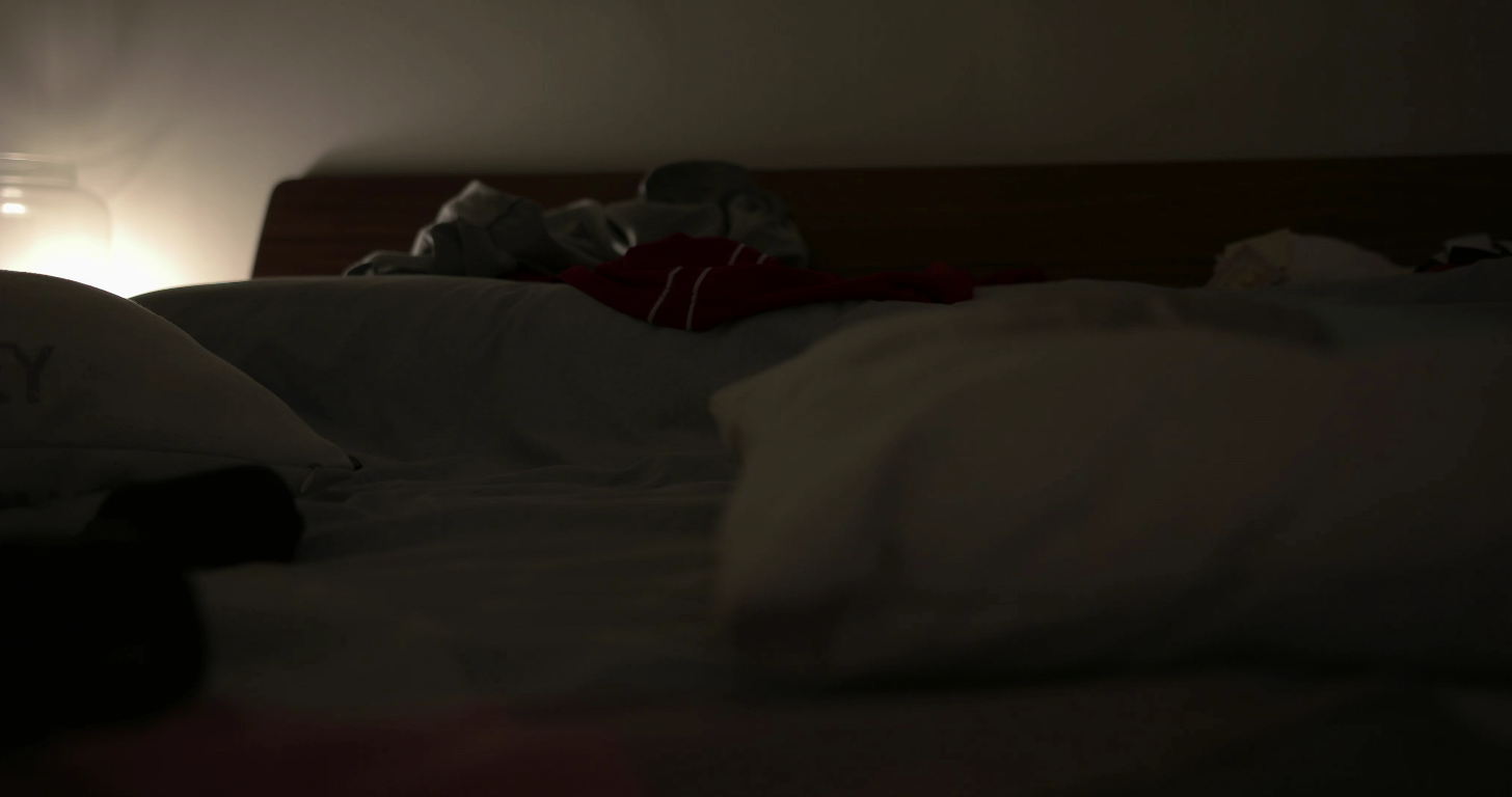

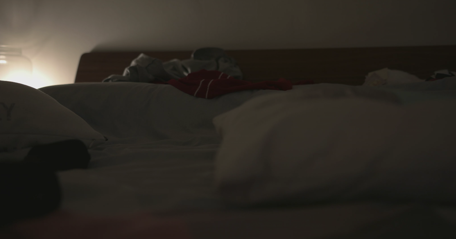

tokhee Posted May 8, 2015 Author Share Posted May 8, 2015 not sure how i can post samples of it since i don't know how i can show what i see on the screen. i tried taking a photo of it from my iPhone, but it looks weird. i grabbed a still from the clip and tweaked the contrast to make one of the images close to what it will look like from the LCD screen.@fuzzynormal i did not shoot any bright lights. i called Samsung and since it's still under their warranty, i will be sending the camera for repair, which i hoped to avoid. Quote Link to comment Share on other sites More sharing options...
