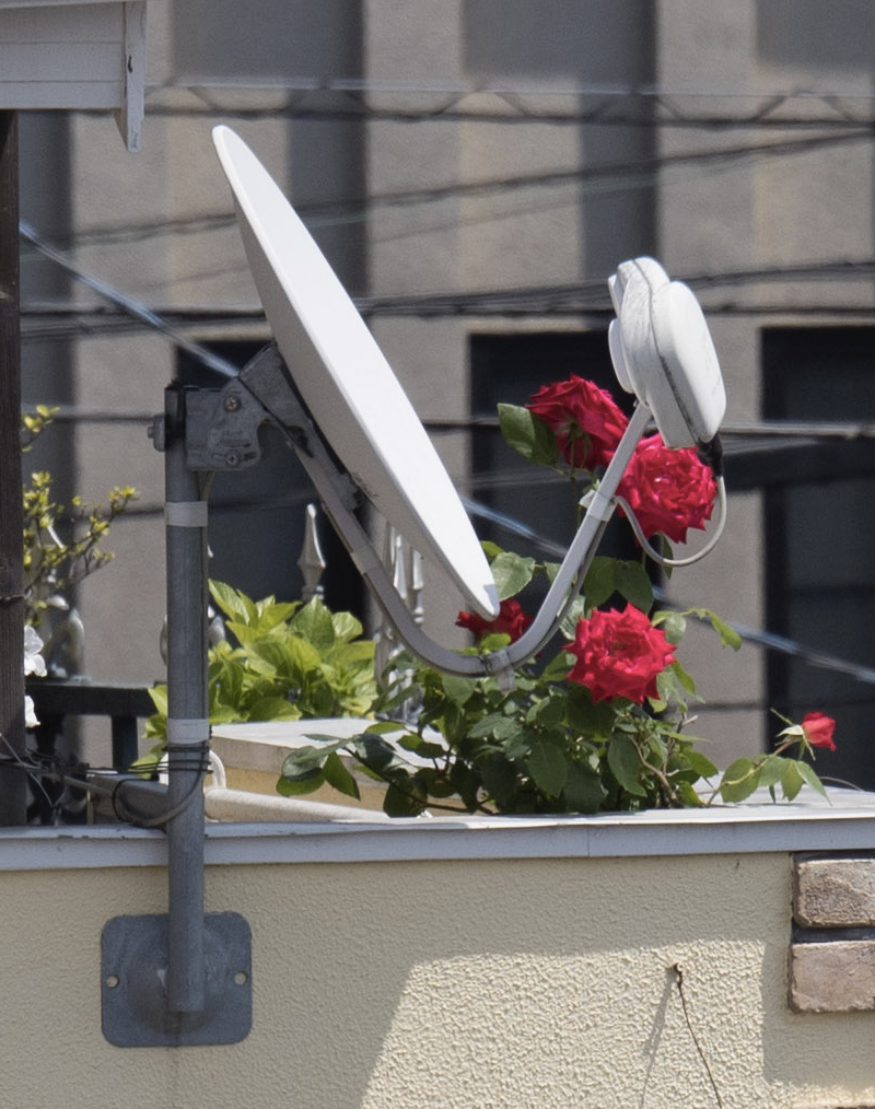

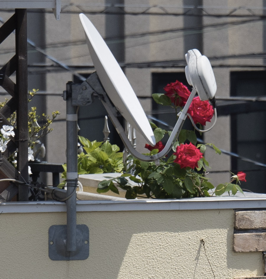

TSV Posted May 10, 2015 Author Share Posted May 10, 2015 It seems that my Kenko PRO ND is making things worse... Look at the screenshot below of a picture I just took.With NDWithout ND Link to comment Share on other sites More sharing options...
