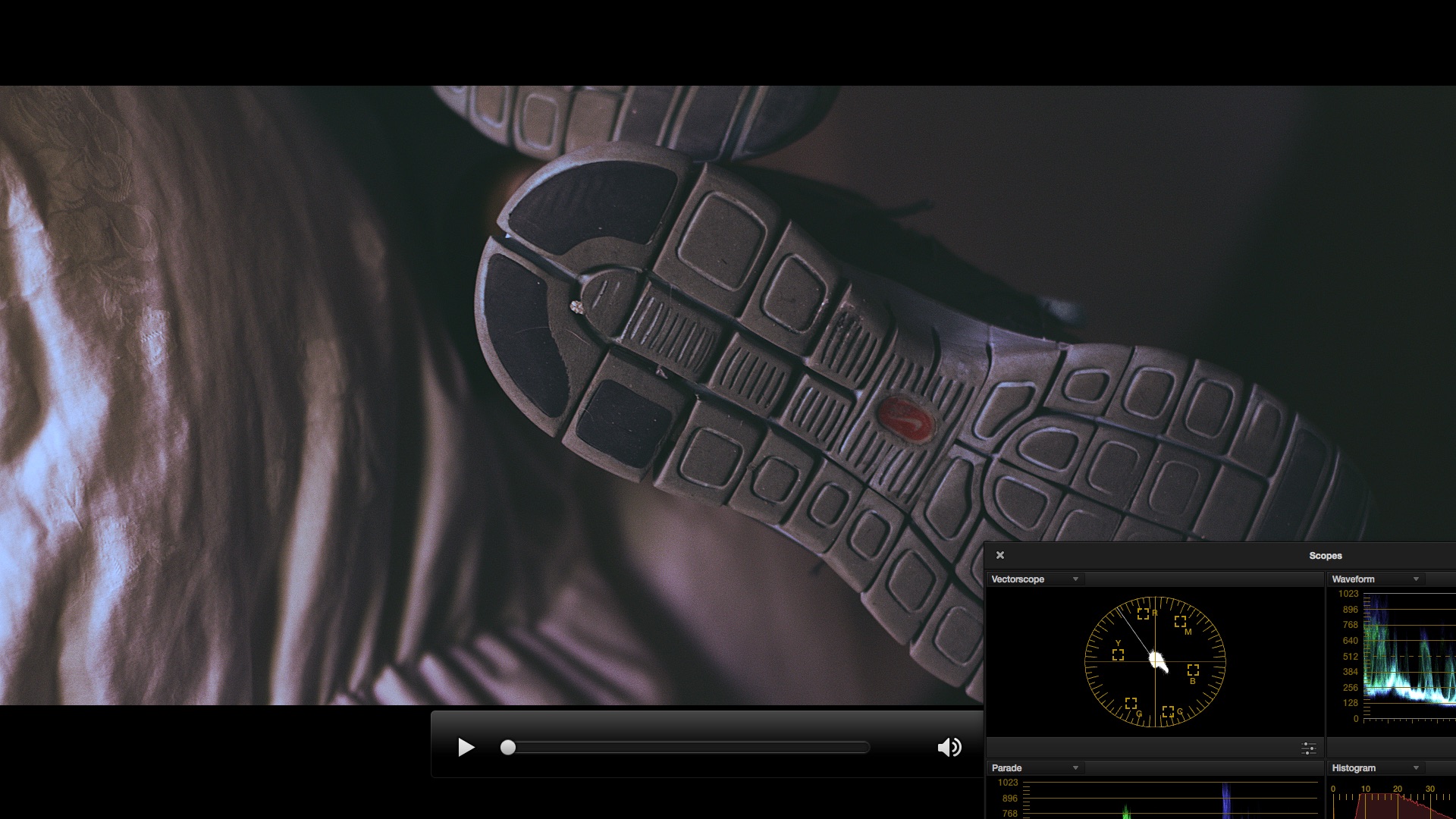

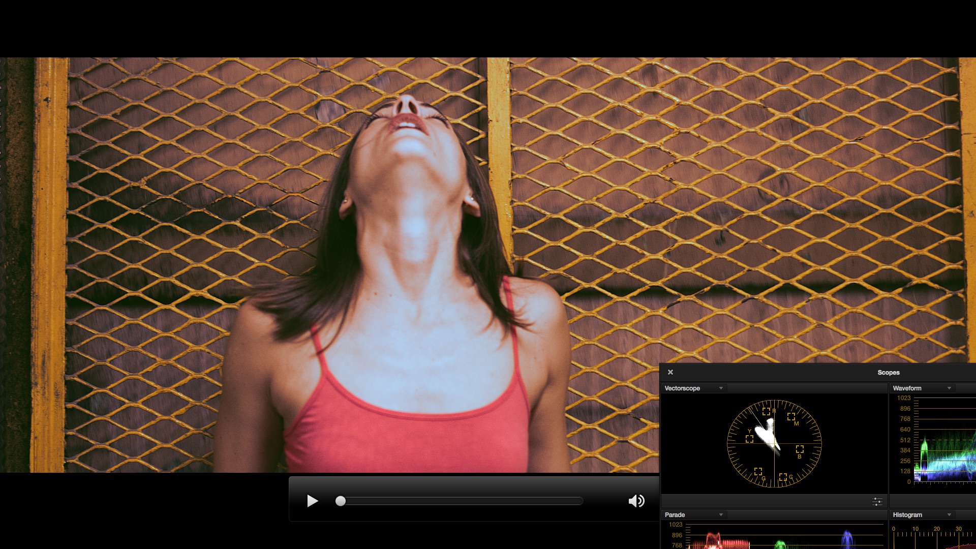

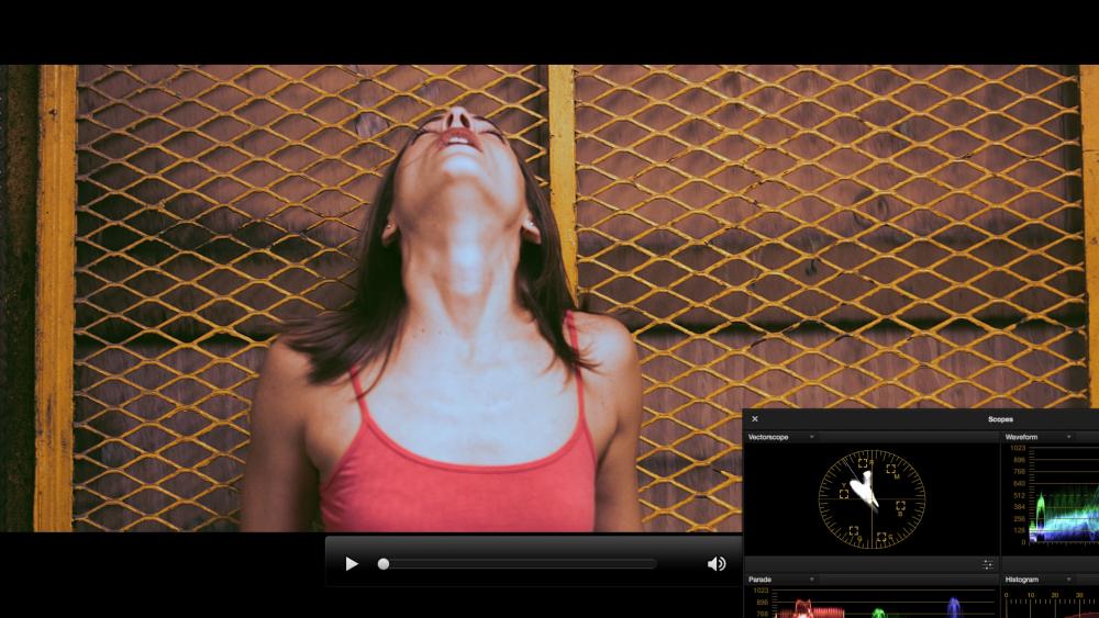

anchoricex Posted May 10, 2015 Share Posted May 10, 2015 Hi all, I've been shooting for fun for a few years and something has consistently baffled me: skin tones. There's an abundance of tutorials on skin tones all over the net, but they don't answer a fundamental question that I'm after:What are skin tones supposed to look like or how do I know what skin tones should look like when I'm grading a video or photo? Instead all of these tutorials just go over how to adjust skin tones, but give me no real way to determine how they should look in the context of the composition.Even when shooting raw and have the most latitude to mess with in post, I've noticed minor adjustments will take your skin tones and throw them out the window, I know people often use mask layers to isolate the skin from the rest of the piece, but when I want to grade to give it a certain look, the isolated skin tones no longer fit the rest of the composition once the rest is graded.Ahead are a couple samples of grading to have a cinematic overall feel/look and the skin tones look exceptional (screen grabs from Anomaly). But how do you know the skin tones fall where they do to fit the rest of the composition? What languages do people use to describe skin tones so that I can better learn to imagine where I want them to be? These frames are brilliant, the skin still looks like skin even though the tones of the rest of the composition have been pushed to feel likely way different then how they were originally shot, but the skin ALSO fits within those scene colors.Typically if I grade something to have this kind of look, the skin tones go with everything else and end up not looking like skin anymore and my photos look like I have live corpses/zombies walking around. I don't know how you're supposed to determine whether or not your skin tones are supposed to be reddish/yellowish/gold/etc in the context of the grade you're going for.I really really apologize if this post is confusing as hell, it's just been frustrating me for a long time now and I'd like to work hard to clear this wall in my pieces. That feeling you get when you're laying on a grass field staring at the stars and trying to comprehend how big the universe must be and your brain just hits a wall, that's how I feel when I'm trying to figure out skin tones. Link to comment Share on other sites More sharing options...
Axel Posted May 10, 2015 Share Posted May 10, 2015 In a perfectly balanced image - in which all colors were neutral ! - the skintones would be exactly on that line:But if your image is cold, warm or whatever, they need to slightly deviate from that line. There is the paradigm preserve the skintones, but if you don't allow the skin to reflect light, you did too much. You make the perfect skintones, then you let them slightly reflect the overall color. Secondary corrections. Link to comment Share on other sites More sharing options...

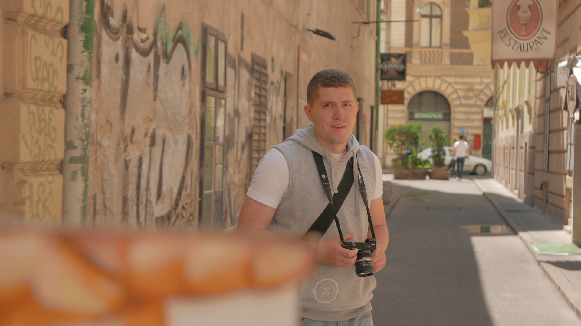

Deadcode Posted May 14, 2015 Share Posted May 14, 2015 Dear All,Could you help me how to fix orange skin tones?Im testing picture profile settings on my LX100, and i find a good one for the dynamic range, but (sometimes) bad for the skin tones.I attached a picture about the problem.You can try youself to grade it, here is the link for the clip: Orange skin toneSettings for the footage:Lx100 @ 75mm F2.8, Standard, -5 contrast, -1 sharpness, -4 NR, 0 Saturation, +-2 shadow/highlight curve, iDynamic: low, -0,66 EV exposure, ISO200 auto shutter, 4K 100Mbps downsampled to 1080p25p in FCPXIf i can fix this problem somehow, this would be my "flat" settings. (maybe -3 to saturation will also help)Simple desaturation in post is not enough, After curves orange comes back Link to comment Share on other sites More sharing options...
hk908 Posted May 14, 2015 Share Posted May 14, 2015 nvm Link to comment Share on other sites More sharing options...
Sekhar Posted May 14, 2015 Share Posted May 14, 2015 On 5/14/2015 at 8:05 PM, Deadcode said: Dear All,Could you help me how to fix orange skin tones?Im testing picture profile settings on my LX100, and i find a good one for the dynamic range, but (sometimes) bad for the skin tones.I attached a picture about the problem.You can try youself to grade it, here is the link for the clip: Orange skin toneSettings for the footage:Lx100 @ 75mm F2.8, Standard, -5 contrast, -1 sharpness, -4 NR, 0 Saturation, +-2 shadow/highlight curve, iDynamic: low, -0,66 EV exposure, ISO200 auto shutter, 4K 100Mbps downsampled to 1080p25p in FCPXIf i can fix this problem somehow, this would be my "flat" settings. (maybe -3 to saturation will also help)Simple desaturation in post is not enough, After curves orange comes backSeems specific to his face and scene, like he's getting the orange from a reflection. If so, you could apply a secondary correction, like below - I just moved the midtones gamma toward blue for his face in SpeedGrade. Link to comment Share on other sites More sharing options...
Deadcode Posted May 14, 2015 Share Posted May 14, 2015 It looks better, If you increase the contrast (with S-curve) the skin tone will be ok? Edit: it works perfectly with s-curve, thank you for the advice! Link to comment Share on other sites More sharing options...
