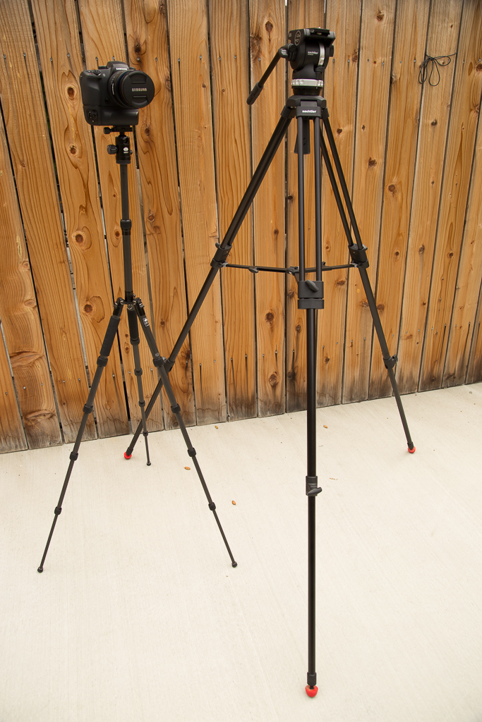

Sekhar Posted May 22, 2015 Share Posted May 22, 2015 Guys, I'm looking for a lightweight tripod, ideally carbon fiber, around 2 lb, 1 foot or so folded, and under $300, with enough load capacity to hold a light camera (mostly NX1 + vertical grip + 16-50). Any suggestions or experiences to share? The Sirui T-025X is looking really good at this point, but I'm little concerned about the max height. Link to comment Share on other sites More sharing options...

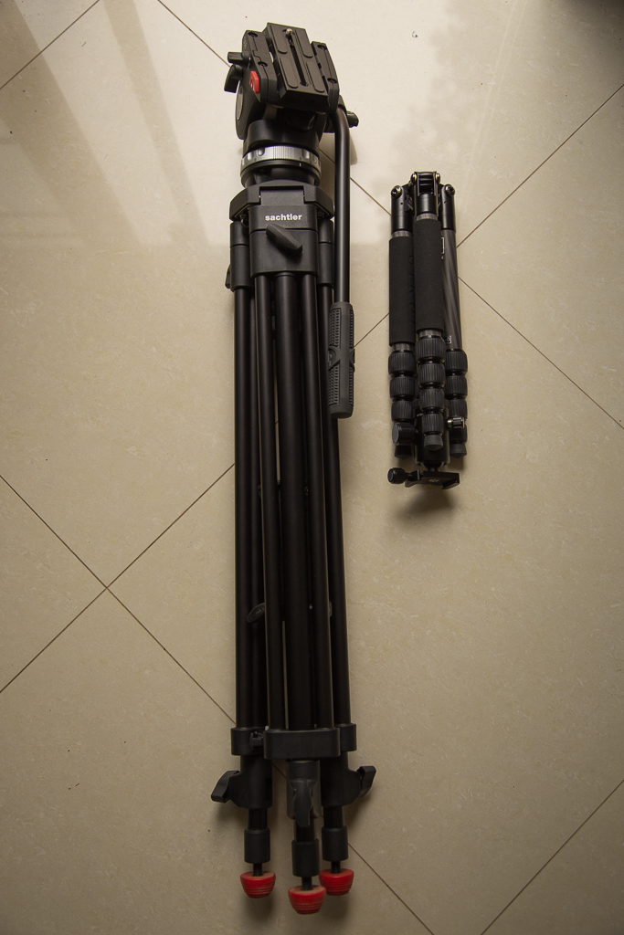

Sekhar Posted May 27, 2015 Author Share Posted May 27, 2015 Just wanted to report back that I ended up getting the Sirui T-025X. It's the lightest and shortest, which were key for me. Overall, the build quality is excellent. The legs are tiny, but if you don't extend the center column, the tripod is surprisingly stable (tried with NX1 + vertical grip + 16-50 as well as 70-200). It's especially strong in controlling twist. I took a (30s) exposure, which seems OK, but will continue to experiment. You can technically do a pan for video, but the movement is a bit sticky and you will see the wobble with long focal lengths, though I got some decent shots with wide angle.FYI, below are the others I researched, in case you're also shopping. TypeLoad (lb)Folded (in)Weight (lb)Min HeightMax HeightMax Height (E)SpecialB&HGiottos VGR8255-S2NCarbon8.815.62.810.656.364.9Monopod, bubble277.00Sirui T-025XCarbon13.211.81.710.248.654.5 234.95Mefoto A1350Q1KAluminum17.615.43.615.453.161.6Monopod, bubble199.00Oben CT-3521Carbon6.614.82.48.849.556.4Monopod, bubble259.95Oben CT-3531Carbon8.815.52.59.353.560.8Monopod, bubble279.95Oben CT-3551Carbon13.2162.6954.862.4Monopod, bubble299.953 Legged Thing EVO3Carbon4413.42.97.4 58.9Monopod, bubble249.953 Legged Thing Punks-RickCarbon2212.62.78.244.356.7Monopod, bubble220.15Velbon Ultra REXi LAluminum8.814.22.93.7 60 N/AAnd below are a couple of pictures comparing the Sirui T-025X with my Sachtler Ace-M to give you an idea of its size (extended and folded). Link to comment Share on other sites More sharing options...
