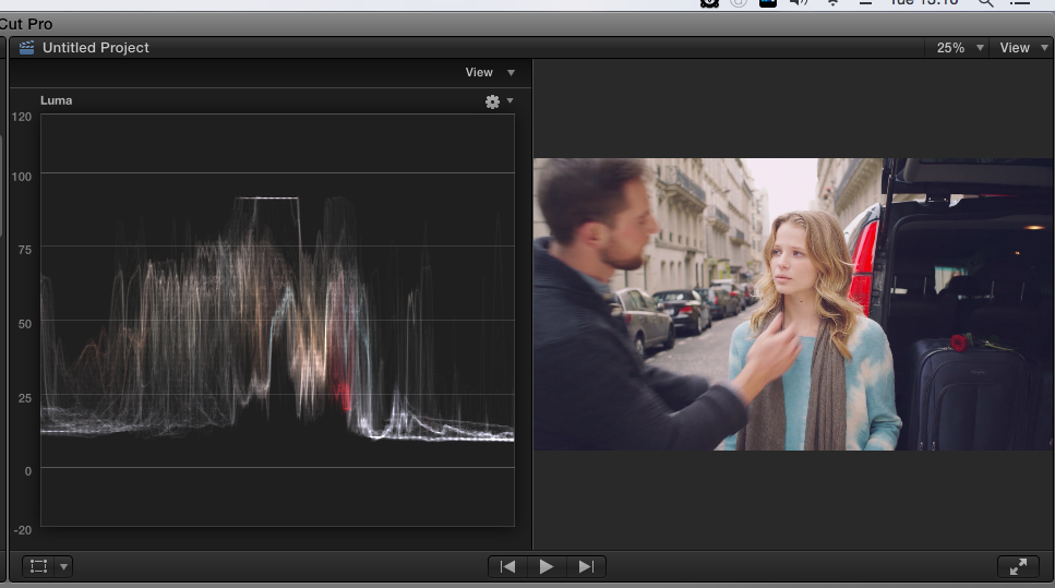

Antonis Posted May 26, 2015 Share Posted May 26, 2015 I recently saw this ad that was directed and color graded by Matthew Firpo: What caught my attention, was the lovely "creamy" highlights and overal color grading of the video.I've seen this look before in fashion videos and, as a beginner in color grading, always wondered how to create it.So far I have been able to determine that the shadows are raised by about 10IRE and the highlights look to be lowered by around 10IRE.Any more tips on how to replicate such a look? Also, would you overexpose in camera when filming for this?The ad was probably filmed on a Red Dragon in raw. But would a GH4 for example (with it's lower DR) be able to get similar color?All advice welcome! René Alan 1 Link to comment Share on other sites More sharing options...

Guest Ebrahim Saadawi Posted May 26, 2015 Share Posted May 26, 2015 In sony vegas pro, I have a plug-in called "Broadcast colour", it's meant to squeez the overexposed areas to under broadcast limit and bring up shadows to broadcast level. But you can choose how much with a slider; it replicates that highlight look, and actually, it fixes ANY bad highlight roll off on ANY camera and makes it look just like alexa/f35 clipping. Smooth cream into highlights (that are clipped of course) Link to comment Share on other sites More sharing options...
Guest Ebrahim Saadawi Posted May 26, 2015 Share Posted May 26, 2015 What it does to highlights is magical, and the waveform does look like the one you posted (it cannot be done with curves/levels it's something else, like a highlight diffusion filter: is this what you mean? Link to comment Share on other sites More sharing options...

Antonis Posted May 27, 2015 Author Share Posted May 27, 2015 Thanks for the replies guys and the examples Ebrahim.The more I look at it, the more I see what a nice effect can be achieved by "squeezing" those highlights.I don't have Magic Bullet, but I played around with some footage in FCPX and saw interesting results.Another bit of progress in learning the different styles of color grading! Link to comment Share on other sites More sharing options...
