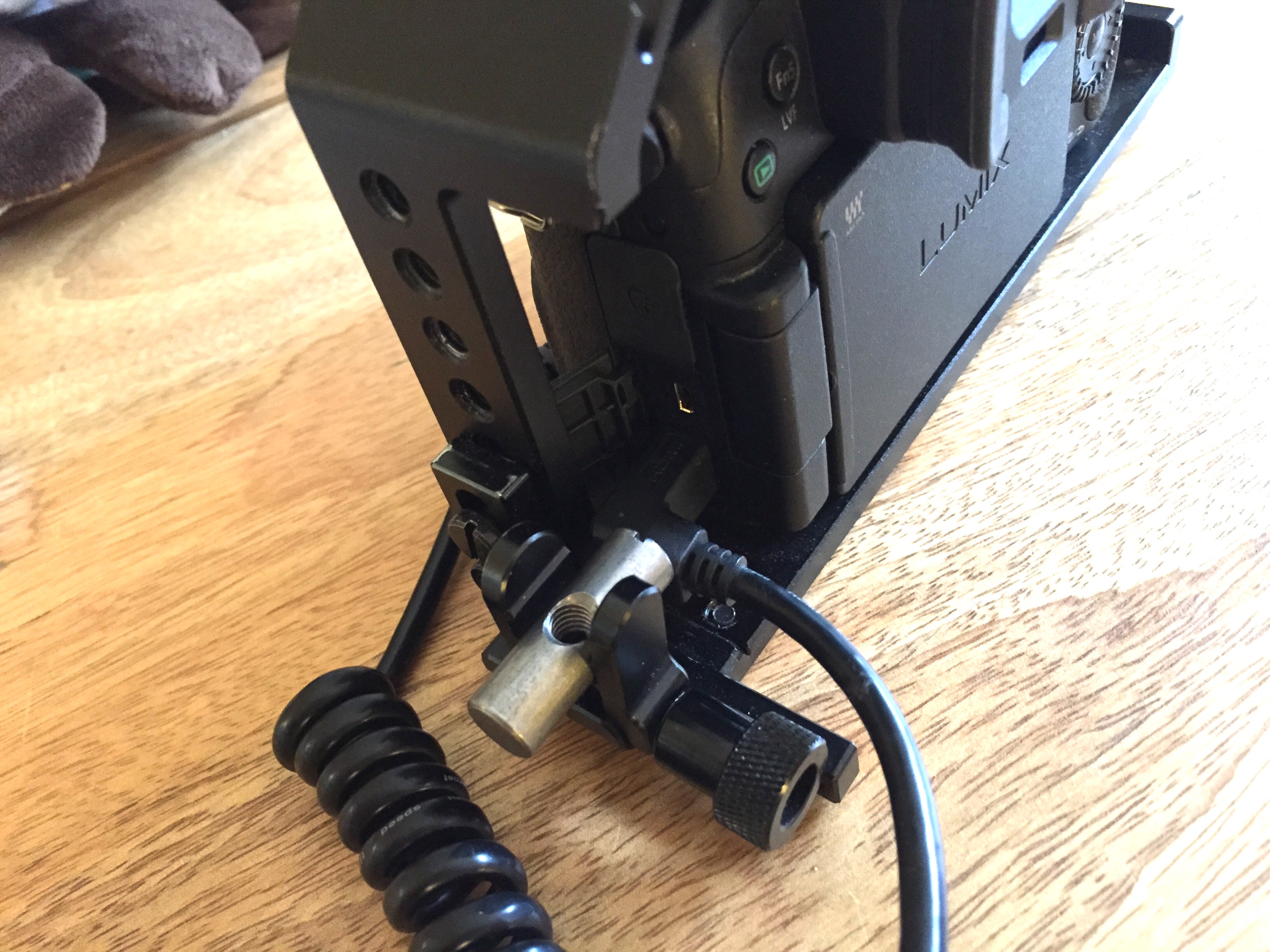

AaronChicago Posted June 5, 2015 Share Posted June 5, 2015 I have seen that cable, but was afraid that the angled micro plug would stand in the way of the door to the HDMI/AV outs on The GH4. What is your experience?It angles away from the door. Do you have a cage for the GH4?I found a rock solid solution for keeping the micro HDMI in place. I use this cage:http://www.ebay.com/itm/FHUGEN-HONU-V2-0-VIDEO-CAGE-Kit-with-Top-Handle-HDMI-Clamp-for-GH3-GH4-A7-A7R-/231330143830?pt=LH_DefaultDomain_0&hash=item35dc59de56I use this HDMI clamp on the side.http://www.ebay.com/itm/SMALLRIG-HDMI-Cable-Clamp-1521-/251981734964?pt=LH_DefaultDomain_0&hash=item3aab482434I simply place a small round metal cylinder (find at a hardware store) inside the clamp and push it against the micro HDMI input. Lock the Clamp. It's super secure. You can basically throw the cage around and it won't come loose. Here is a picture: bluefonia 1 Link to comment Share on other sites More sharing options...

bluefonia Posted June 6, 2015 Author Share Posted June 6, 2015 @AaronChicagoNo, I don't have a cage, but it seems to be a pretty useful piece of gear and has actually been on my radar for some time too. How do you like the Honu, - pros and cons? Link to comment Share on other sites More sharing options...
