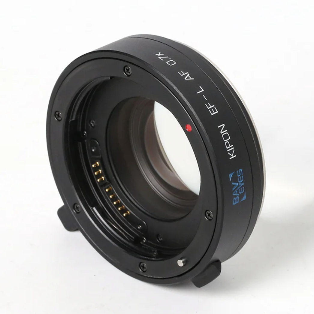

2. I read something about some of the flange/clearance distance not working and hitting the shutter? If so, does the S9 now offer the option for a Speed Booster in S35 mode or is it still too compact to allow for the optics? Sigma FP is OK because of no mechanical shutter?
https://kipon.com/product/ef-l-af-0-7/
https://laowacine.com/product/0-7x-focal-reducer-for-probe-lens/
With the new batch of Mark ii Lumix S camera's I'm hoping cropped 4k/60p will be a thing of the past but since I will be scooping up used first gen models for cheap B and C cameras, I would like some options for adapting/boosting my vintage glass.

As for L mount, Besides Metabones, Laowa has one for their probe lens and Kipon now has a Canon EF one with autofocus. The main issue is the optics hitting the mechanical shutter from what I understand so maybe that’s part of it.
Wow, that one had passed me by as it appears on their website in their shop but not under their product listings in the 0.7x section.
I’d guess that as they state it only works with the FP/L and BM6K that it might also work with the similarly mechanical shutter free S9 as well.
If so that would be a good option for people looking to shoot the higher frame rates offered in crop mode on the S9, albeit it at the expense of a much bigger overall form factor with having to use EF lenses and the adapter instead of the native L mount lenses.
Although foregoing the electronic aspect and just using the EF mount as a bridge it does also offer good options to then mount F, C/Y and R etc.
Good find.
Yes, that was actually what sparked this original post and the title including the S9 in there. I also noticed it’s curious that it’s not listed on some of their product pages. I did just see one sell on eBay for pretty cheap though so I’ll keep my eyes out. I messaged the seller and he said he tried it on the S5 and it definitely hit the shutter. But he used it on the sigma FP with no problems.
