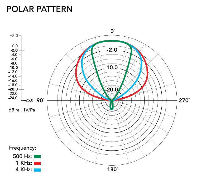

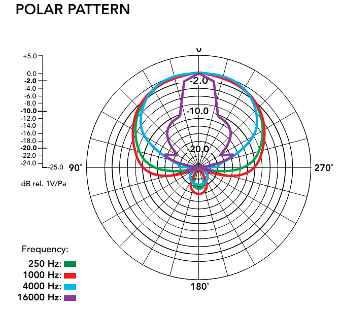

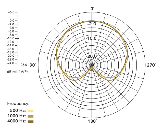

ac6000cw Posted June 19, 2024 Share Posted June 19, 2024 The equivalent of lens 'focal length' for microphones is their 'polar pattern, which their sensitivity to sound versus the angle relative to the direction the mic is pointed. Below is the polar pattern diagram for the stereo Rode VideoMic-X that you mentioned in the first post. The front of the mic is at the 0 degree position, the rear at 180 degrees. It will respond to sound (to some extent) over a range of +/- 120 degrees relative to the forward direction. It is most sensitive to sounds over around a +/- 60 degree range. Because of its polar pattern and because it's a stereo mic, IMHO it and other stereo mics are good choice if you want to record a general ambient stereo sound field. The recording if played back on a normal stereo loudspeaker setup should recreate the original sound field reasonably well, and you'll be able to locate the individual sound sources within the sound field. If you are trying to record (for example) one person speaking and need to exclude as much of the ambient sound from the sides and rear as possible, you would probably choose a mono mic with narrower polar pattern like a super-cardioid/hyper-cardioid/short shotgun mic e.g. the Rode NTG4 below: ...or a more extreme 'long shotgun' mic like the Rode NTG8, with a much narrower polar pattern: lsquare 1 Link to comment Share on other sites More sharing options...
lsquare Posted June 19, 2024 Author Share Posted June 19, 2024 2 minutes ago, ac6000cw said: The equivalent of lens 'focal length' for microphones is their 'polar pattern, which their sensitivity to sound versus the angle relative to the direction the mic is pointed. Below is the polar pattern diagram for the stereo Rode VideoMic-X that you mentioned in the first post. The front of the mic is at the 0 degree position, the rear at 180 degrees. It will respond to sound (to some extent) over a range of +/- 120 degrees relative to the forward direction. It is most sensitive to sounds over around a +/- 60 degree range. Because of its polar pattern and because it's a stereo mic, IMHO it and other stereo mics are good choice if you want to record a general ambient stereo sound field. The recording if played back on a normal stereo loudspeaker setup should recreate the original sound field reasonably well, and you'll be able to locate the individual sound sources within the sound field. If you are trying to record (for example) one person speaking and need to exclude as much of the ambient sound from the sides and rear as possible, you would probably choose a mono mic with narrower polar pattern like a super-cardioid/hyper-cardioid/short shotgun mic e.g. the Rode NTG4 below: ...or a more extreme 'long shotgun' mic like the Rode NTG8, with a much narrower polar pattern: You guys are amazing, especially the last two posts. It has dramatically improved my understanding of mics, believe it or not. I guess I'm looking for an all-in-one mic, but I guess that doesn't exist. Bringing multiple mics will be an issue due to space and weight. For camera lenses, I have mostly settled on zooms and all-in-one zooms for versatility and weight savings compared to bringing multiple prime lenses. Link to comment Share on other sites More sharing options...
ac6000cw Posted June 19, 2024 Share Posted June 19, 2024 47 minutes ago, lsquare said: I guess I'm looking for an all-in-one mic, but I guess that doesn't exist. Bringing multiple mics will be an issue due to space and weight. There are a few camera-mount mics around like the AT8024, which combine a mono cardioid mic with a mid-side mic and are switchable between mono and stereo - https://www.audio-technica.com/en-us/at8024 (I've never used it so no idea what the sound quality is like). That will plug directly into the 3.5mm mic jack on the camera if you want to keep things as light/small/simple as possible. As an alternative, if you can take two mics, I'd be tempted to take maybe a stereo Rode Stereo VideoMic Pro for the 'ambient sound' situations, plus a mono Rode VideoMic NTG for when you need a more directional, more focused mic. Both will plug directly into the camera and are lightweight (about 100g each), not huge and not too expensive. Again, I've not used either mic so can't comment on the sound quality. If you're going to be recording outdoors a lot, make sure you have decent furry windshields/windsocks for the mics - you'll definitely need them at some point... lsquare 1 Link to comment Share on other sites More sharing options...
