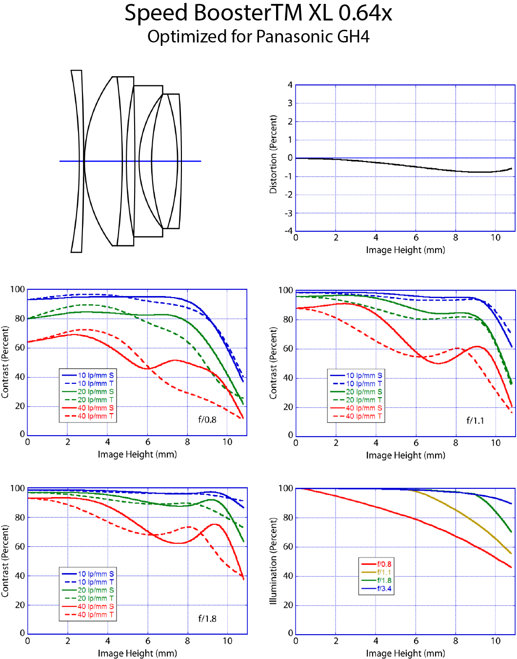

Brian Caldwell Posted June 6, 2015 Share Posted June 6, 2015 Your're correct: the Speed Booster XL is really a dedicated GH4 focal reducer. The design is very similar to the BMCC version, but I squeezed out a bit more than a millimeter of extra space to clear the GH4 shutter, and, as you surmised, optimized for the thicker filter stack. In addition, the coverage was enlarged to encompass the entire m43 image area compared to the smaller BMCC sensor. However, I tuned the performance to be really good over the reduced area Cinema-4k mode of the GH4.High optical performance at extreme apertures are what this new Speed Booster is all about. Metabones seems to be having technical difficulties getting the full press release up on their website, so I'll show the data here. As you can see from the MTF curves, even at f/0.8 the contrast and resolution are extremely high out to an image height of 8,7mm, which corresponds to the Cinema-4k mode image circle diameter of 17.4mm. Beyond that point the performance drops gradually to the corners of fullframe m4/3, but is still pretty good. nahua, IronFilm, Jimbo and 2 others 5 Link to comment Share on other sites More sharing options...

Julian Posted June 7, 2015 Share Posted June 7, 2015 When 1.28 is more or less equal to 1... how can 0.07 difference be a dealbreaker?Like Rudolf I don't get the excitement. A 35mm ff becomes a 51,520mm on m4/3 instead of the 57,155mm equivalent on m4/3. That's a 5,6 mm difference. To get the same effect with the "old" Speedbooster you have to step approximately 21 cm backward, that's around 2/3 of a foot. I doubt anyone would notice the difference in a real world scenario unless you shoot on the edge of a rooftop.I agree the difference of 0.07 is not such a big deal, but imo the 'normal' EF - MFT Speed Booster is already a great product. This just makes it better.The difference is more relevant for wide lenses. Because you now get the same crop factor as any aps-c camera, you can use all lenses 'as intended'. The Sigma 18-35mm for example. With the 0,71x Speed Booster, you get a 31-60mm equivalent (4K UHD), with the 0,64x you get the 28-55mm equivalent. 28mm vs 31mm is noticeable. It's not only about subject distance, but about a certain look and perspective.On top of that, you'll get an extra 1/3 stop of light. It's not much more expensive than the 0,71x SB either. So, that's what makes me - as a GH4 owner - excited.Thanks Brian! Cinegain and nahua 2 Link to comment Share on other sites More sharing options...
