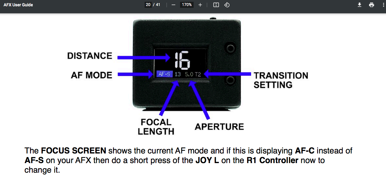

Super Members BTM_Pix Posted July 8, 2024 Super Members Share Posted July 8, 2024 32 minutes ago, eatstoomuchjam said: The AFX sounds great, but I don't really see any place where I could purchase it. Assuming that you are cda-tek as well as btm_pix, there are reference to firmware and documentation on the home page, but otherwise there seems to be a BlackMagic-focused focus unit which also looks nice, but wouldn't be useful for me. Yes, I'm me on here and the designer for them when I'm not on here! The AFX sold its production run out (the webpage shows the original Android/Tilta fusion product) and then the COVID supply chain nonsense kicked in which hit us over a couple of components so we paused another run and then have now moved on to other products. 32 minutes ago, eatstoomuchjam said: Your offset parameter sounds nice, though I'd be guessing at the value since I don't usually carry a ruler on me. 😃 Well, its moot now but with an AFX you always have a very accurate tape measure sitting on top of the camera 🙂 eatstoomuchjam 1 Link to comment Share on other sites More sharing options...
