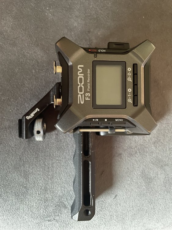

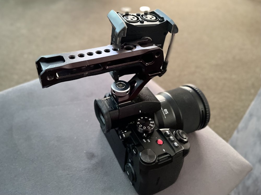

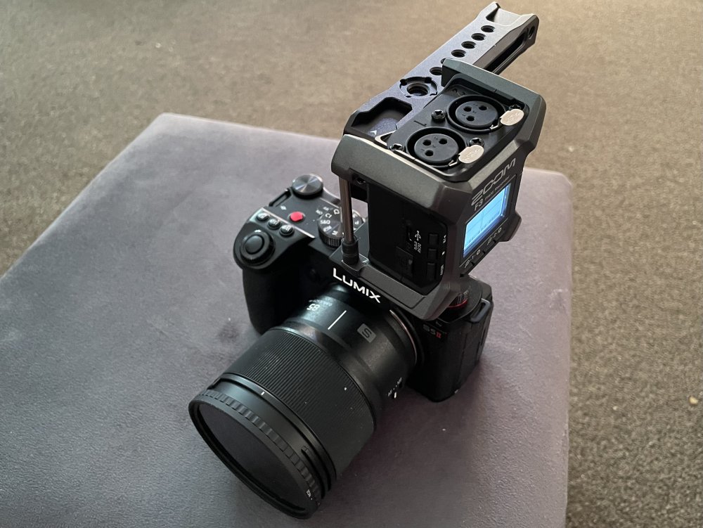

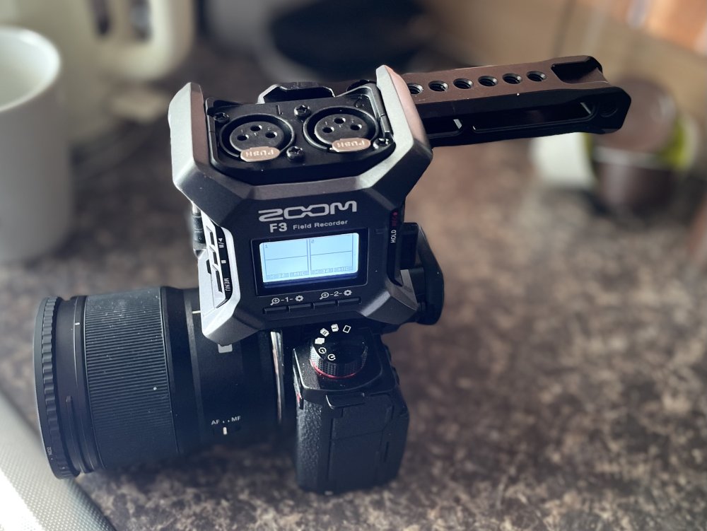

Super Members BTM_Pix Posted July 15, 2024 Super Members Share Posted July 15, 2024 For anyone looking to a roll your own version of these top handles, here is my S5ii and F3 handle. Advantages are cost, 32 bit float, wireless sync with the UltraBlue and flexibility in mounting orientation and position (XLRs up and mounted forward in my case). Downside is that the F3 has a pair of mounting bars to enable it to be strapped to a pole or a wrist and they make it awkward to mount with a regular 1/20 to 1/20 screw from the handle to it base so I need to get a longer one at some point. Downside is presuming Zoom might have been silly enough to not make the mounting bars removable. bjohn and IronFilm 2 Link to comment Share on other sites More sharing options...
eatstoomuchjam Posted July 15, 2024 Share Posted July 15, 2024 Looks like you can remove the rods based on what I can see from skipping around this video. BTM_Pix and IronFilm 1 1 Link to comment Share on other sites More sharing options...
Super Members BTM_Pix Posted July 15, 2024 Super Members Share Posted July 15, 2024 Take away that downside and put down that hacksaw for me then. IronFilm and eatstoomuchjam 1 1 Link to comment Share on other sites More sharing options...

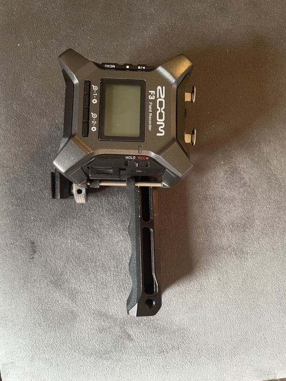

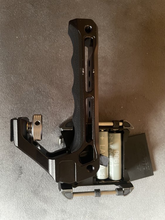

Super Members BTM_Pix Posted July 15, 2024 Super Members Share Posted July 15, 2024 Loosen it one turn from this original orientation (XLRs up) Gets you to this (XLRs down) Then the battery tray is accessible on the other side like this, so you the don’t have to remove the F3 from the handle to change batterries. KnightsFan 1 Link to comment Share on other sites More sharing options...
