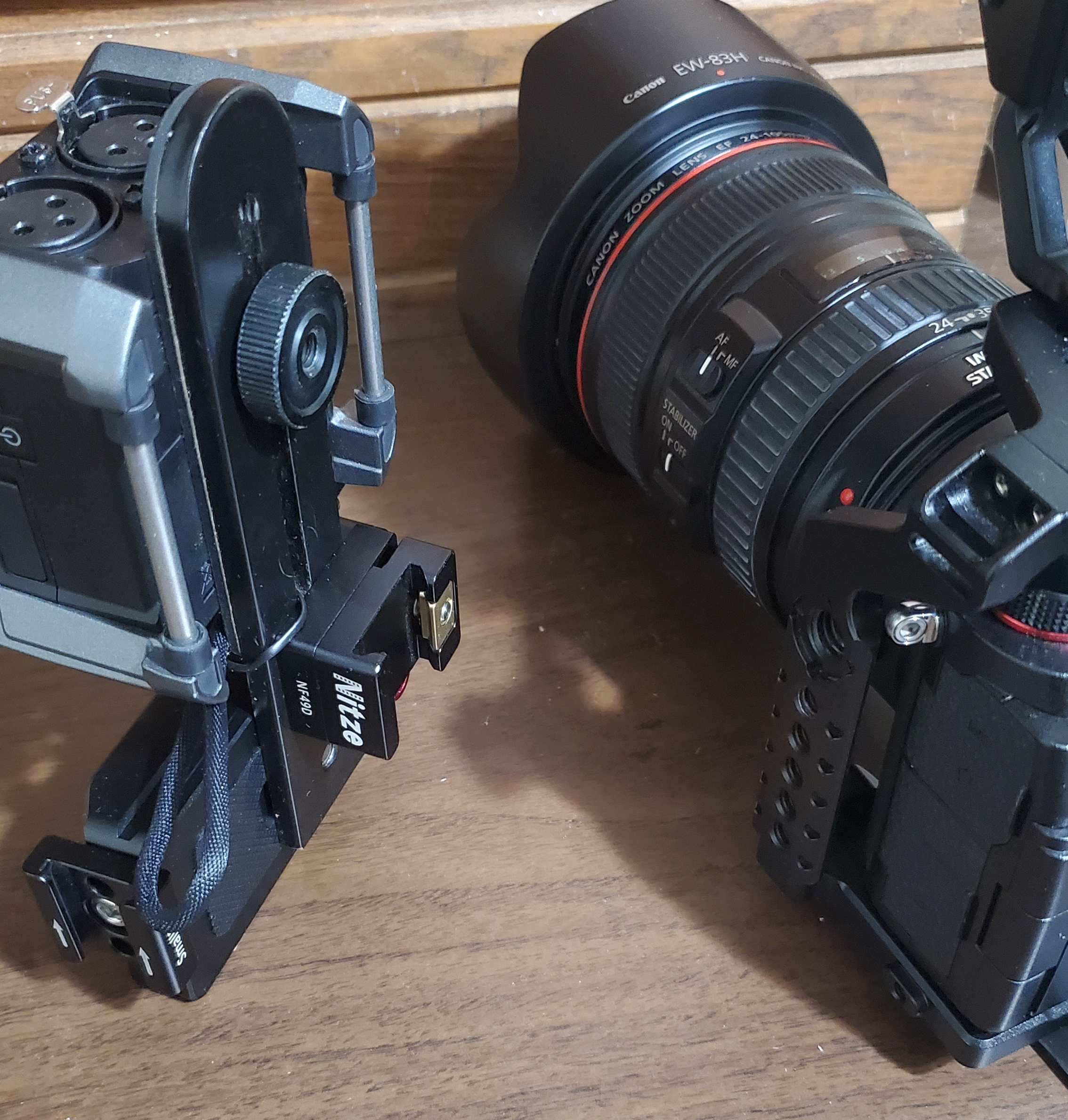

Ty Harper Posted July 16, 2024 Share Posted July 16, 2024 58 minutes ago, KnightsFan said: I get a couple hours on the F3, max. Not enough to get through an 8-hour shoot without changing them. I mean it would be okay to use AA's exclusively, but considering the placement of the battery door, and my preference for completely solid rigging, it's sort of a pain to change them at all. I think I would be annoyed having to move things like @BTM_Pixshowed, and then tighten it back down and all (not to say it's worse, just that it's not for me). This is my setup now. The F3 and battery plate are bolted onto a bracket with a NATO clamp on the other side. For all-in-one setups, I slide it onto the camera cage. For separate audio, I also have a NATO rail on the boom pole, so we can quickly move the whole unit from camera to boom. It would be nice to shave the NPF's weight but the ease of use wins out for me at the moment. Yeah def gotta do what makes sense for your workflow. I get by np with this being the consistent core of my setups - so obviously very easy to swap batts out. KnightsFan 1 Link to comment Share on other sites More sharing options...

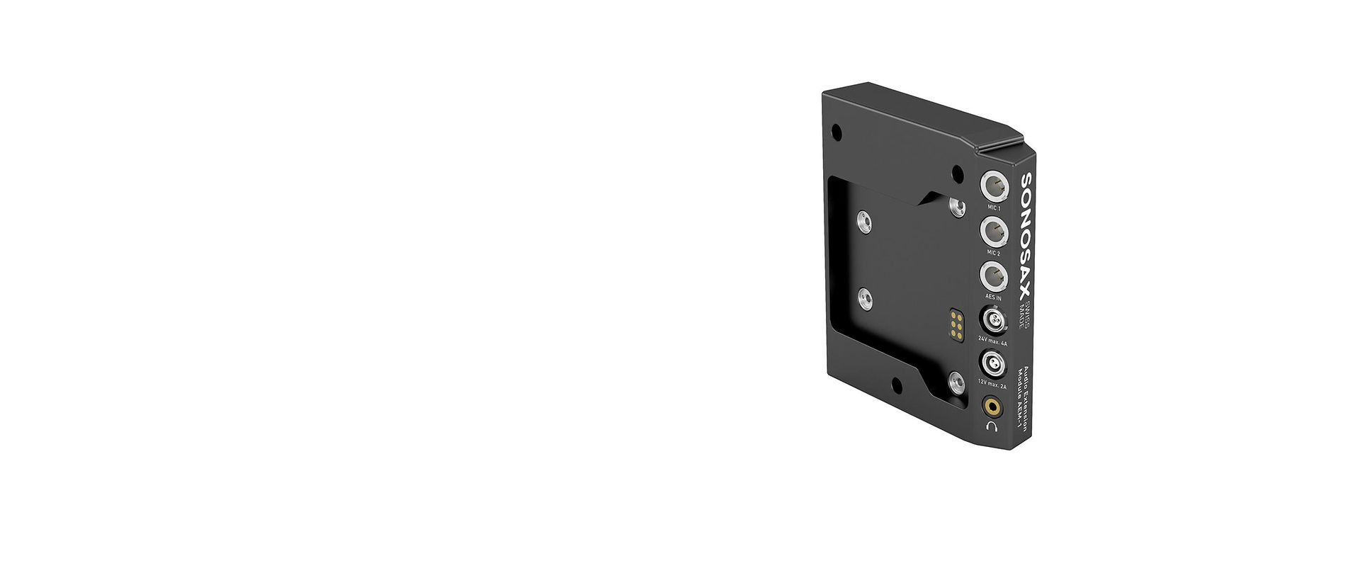

IronFilm Posted July 16, 2024 Share Posted July 16, 2024 15 hours ago, bjohn said: It's very expensive, but the Sonosax M2D2 is a small, extremely high-quality preamp that has two mini-XLR inputs. It outputs line-level stereo analog to a camera; it also outputs a digital signal via USB or AES. It has some of the best preamps and converters available anywhere. It's powered by one battery and can run for hours even with phantom power on both inputs. Sonosax doesn't sell a camera mount for it but you can download a 3D-printable file for one from their website. I use it mainly for music recording (I recorded our last album with it) but might use it for video one day. There is a Sonosax M2D2 on eBay I've been eying for a while, but I just can't justify the cost vs the AJA quadboxes I already have. Am glad ARRI went with Sonosax for the ARRI 35: https://www.arri.com/en/camera-systems/camera-components/aem-1 11 hours ago, KnightsFan said: @BTM_Pix how do you deal with the f3's short battery life? I have my f3 attached to an npf battery sled, but it's bulky. I wouldn't mind changing AA's every few hours, but the battery door isn't accessible when mounted like that. If you're using V Locks, get yourself a D-Tap to USB-C cable? Link to comment Share on other sites More sharing options...

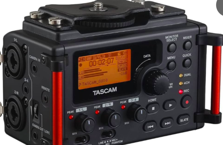

EduPortas Posted July 16, 2024 Share Posted July 16, 2024 What? No love for Tascam's DSLR recorder? Menus are close to impossible to understand but lots of YT videos out there to make it work. Link to comment Share on other sites More sharing options...

KnightsFan Posted July 16, 2024 Share Posted July 16, 2024 16 hours ago, Ty Harper said: Yeah def gotta do what makes sense for your workflow. I get by np with this being the consistent core of my setups - so obviously very easy to swap batts out That's not a bad setup. I'd like to swap my setup with a plug on transmitter with 32 bit internal recording. That would be even better as a quick-swap between camera and boom pole, and provide easy battery access. So hopefully my bulky setup is temporary anyway. Link to comment Share on other sites More sharing options...
KnightsFan Posted July 16, 2024 Share Posted July 16, 2024 12 hours ago, IronFilm said: If you're using V Locks, get yourself a D-Tap to USB-C cable? I use npf (pic on page 1) with usb power. Honestly if the battery door were more accessible I would just deal with swapping rechargeable AA's. Link to comment Share on other sites More sharing options...

newfoundmass Posted July 17, 2024 Share Posted July 17, 2024 On 7/16/2024 at 1:37 AM, EduPortas said: What? No love for Tascam's DSLR recorder? Menus are close to impossible to understand but lots of YT videos out there to make it work. It's old and the pre amps are pretty crappy. Link to comment Share on other sites More sharing options...
EduPortas Posted July 17, 2024 Share Posted July 17, 2024 1 hour ago, newfoundmass said: It's old and the pre amps are pretty crappy. Better than most DSLRs, though. Link to comment Share on other sites More sharing options...
IronFilm Posted July 18, 2024 Share Posted July 18, 2024 18 hours ago, newfoundmass said: It's old and the pre amps are pretty crappy. The preamps are great for its (very low) price. Much better than the Zoom H4n, or DSLR preamps. Link to comment Share on other sites More sharing options...
newfoundmass Posted July 18, 2024 Share Posted July 18, 2024 3 hours ago, IronFilm said: The preamps are great for its (very low) price. Much better than the Zoom H4n, or DSLR preamps. Crappy probably wasn't the right word to use on my part. I wouldn't say they're great, though. There are better options out there for not that much more money, that have better preamps and features. The Portacapture line from Tascam are much better and competitively priced, for example. I have the x8 and it was a game changer for me as a one or two person crew. I wouldn't recommend the H4n (including the latest version) either. Zoom has essentially released the same recorders, preamps and all, repeatedly over the last decade plus with only minor improvements. To Tascams credit they've at least avoided that and just kept the same pieces of kit for sale. I can respect that, because at least they aren't trying to sell their customers the same recorder with minor feature upgrades every 5 years. Still though, can't say I'd recommend the DR-60 or any of that generation of recorder. Save up a little more money and get something better. Most cameras today have "good enough" preamps, I think. I use the XLR adapter on my S5s and S5II X and am quite satisfied with it. There are obviously instances, especially with older cameras, where the camera preamps are bad but we're actually quite fortunate that they've gotten as good as they have. We're a long way from the T3i. Link to comment Share on other sites More sharing options...
IronFilm Posted July 19, 2024 Share Posted July 19, 2024 12 hours ago, newfoundmass said: Crappy probably wasn't the right word to use on my part. I wouldn't say they're great, though. There are better options out there for not that much more money, that have better preamps and features. Yes... but also no. What if a person wishes to spend less than $200 new? (or the equivalent lower amount, if buying secondhand) Let's also pretend too that 24bit matters to the user. Is there anything better than the DR60D? Nope! What if you go up to $300? $400? Nope. (assuming you don't need the extra channels of a DR70D) It takes spending six hundred dollars before you truly get something better than the Tascam DR60D I'm afraid. For some people that's "not that much more money", for others that's "a lot". 12 hours ago, newfoundmass said: The Portacapture line from Tascam are much better and competitively priced, for example. I have the x8 and it was a game changer for me as a one or two person crew. Handheld recorders though are poor ergonomics for on set usage. But yes, I can't help but wish, what if Tascam had put the guts of the X8 instead into the form factor of a DR701D / DR680 / HD-P2 instead??? 12 hours ago, newfoundmass said: I wouldn't recommend the H4n (including the latest version) either. Zoom has essentially released the same recorders, preamps and all, repeatedly over the last decade plus with only minor improvements. Ehhh... that's true for the H Series from Zoom. But Zoom has been doing fairly well in continuously improving what's on offer with the F Series. (but I do wish a F4n existed! And I wish there was a big leap in improvements from the F8 to the F8n Pro) 12 hours ago, newfoundmass said: To Tascams credit they've at least avoided that and just kept the same pieces of kit for sale. I can respect that, because at least they aren't trying to sell their customers the same recorder with minor feature upgrades every 5 years. Still though, can't say I'd recommend the DR-60 or any of that generation of recorder. Save up a little more money and get something better. Sadly Tascam has discontinued most of their recorders from the pre / early F8 era. The only field recorders they've kept are the Tascam DR60D (the mk2 version) and the DR70D. Wish they'd kept the DR701D, it could have undercut even the cheapest of the Zoom F Series (the F6). Perhaps they could have released a DR701D mk2 that added the buzzword of "32bit" but otherwise kept mk2 identical to mk1. Or maybe a Tascam DR680mk3 that was identical to mk2 but added timecode support. Or kept around the Tascam HS-P82 but kept on slashing the price, if they priced it at say US$2K then it maybe could have still competed in a niche against the Zoom F8n Pro and Sound Devices MixPre10. Or updated the Tascam HD-P2 to a HD-P2 mk2 (or perhaps it should be an "HD-P4", as I'd imagine the mk2 should simply add a couple more channels of recording to make it relevant in the modern world of today. As two channel recorders are not much use now). 12 hours ago, newfoundmass said: Most cameras today have "good enough" preamps, I think. I use the XLR adapter on my S5s and S5II X and am quite satisfied with it. There are obviously instances, especially with older cameras, where the camera preamps are bad but we're actually quite fortunate that they've gotten as good as they have. We're a long way from the T3i. Panasonic is kinda the exception, they don't prioritize audio, but at least they usually treat it a bit better than some other brands do. Such as Canon, who still don't have any XLR accessor yet at all for any of their mirrorless cameras. Link to comment Share on other sites More sharing options...
IronFilm Posted July 19, 2024 Share Posted July 19, 2024 5 minutes ago, IronFilm said: It takes spending six hundred dollars before you truly get something better than the Tascam DR60D I'm afraid. Wanted to add "...without having to compromise in some other area" but the editing time ended seconds before I could submit. Link to comment Share on other sites More sharing options...
