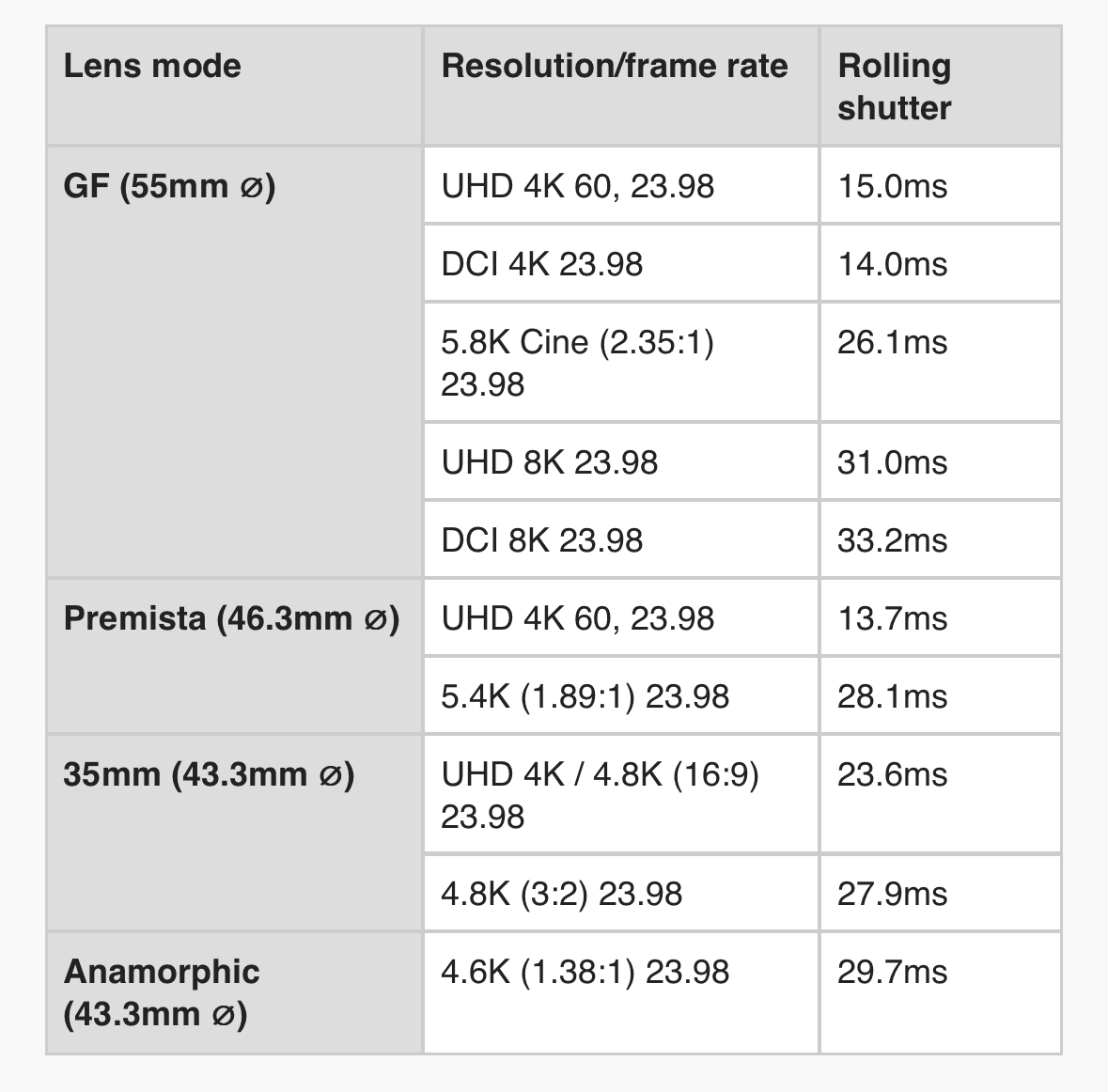

Rolling shutter is really going to be your enemy here. If you’re not shooting with much movement you might be able to deal with it. GFX 100ii is the first GFX to finally have decent video specs using the full sensor width but readout speeds are still just too slow. You’ll have to stay in 4k mode to see the most usable results.
“In 14-bit mode, the sensor takes around 164ms to read its full 102 million pixels, so it's not plausible that it's using all its pixels to produce most of this footage, even if you assume a drop to 12-bit sampling for video.
The 8K modes are the ones that appear to be sampling every pixel (seemingly from a fractionallyless than 8K region, and upscaling) and these have the worst rolling shutter despite using the smallest crops of the sensor. So it's reasonable to assume the other modes are pixel-binning or line-skipping to some extent.”
As mentioned above, you should definitely rent one and play around to make sure you’re getting what you want. For me I was excited to pick one up and use all my Mamiya 645 lenses for doc work but the deeper I dive into the specs, the more I realized it’s just too soon. For the money I would get a used Sony A1 and a Ninja Ultra and have fun with that for a while.
The “Medium Format Look” is an interesting combination of factors and a much heated debate surrounds it. I don’t want to get into here but suffice to say, you can achieve very similar if not the same results with the right combination of lenses on a nice full frame sensor like the Sony A1. There are alsoa lot of advantages to full frame sensors for video and I’m personally waiting for a couple more GFX iterations before making that deep investment for video.
