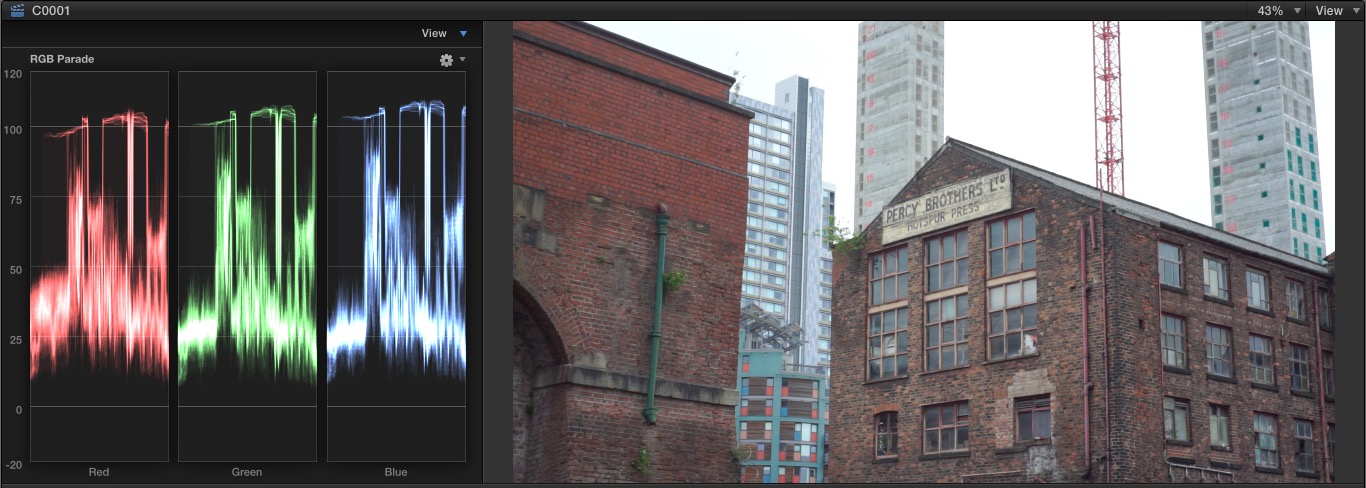

utsira Posted June 19, 2015 Share Posted June 19, 2015 Based on very early tests, yes, there appears to be a lot of usable detail above 100%.One annoying thing about this is it does make the zebras less useful if you're using them for expose-to-the-right shooting (ie set them to 100+ and expose so that zebras only show in the centre of bright highlights with no detail). I have them set to the highest setting (100+). IIRC all of the sky was zebra-ing in the below shot, and there's clearly usable detail there (so if you normally shoot with zebras on 80%, you should probably set them to 100+ to get an 80% effect). They should give us as a "120+" zebra setting (on the other hand I suppose it's nice to have some lee-way if you think you have accidentally over-exposed). Link to comment Share on other sites More sharing options...

utsira Posted June 20, 2015 Share Posted June 20, 2015 You should read the comments for that article, eg:Certainly in FCPX no data is being thrown away, and it's just a case of bringing the highlights down about 8 percent. If you look at the scopes in the shot above, there's no clipping there, the detail in the 100-110% range is fully recoverable. Link to comment Share on other sites More sharing options...
