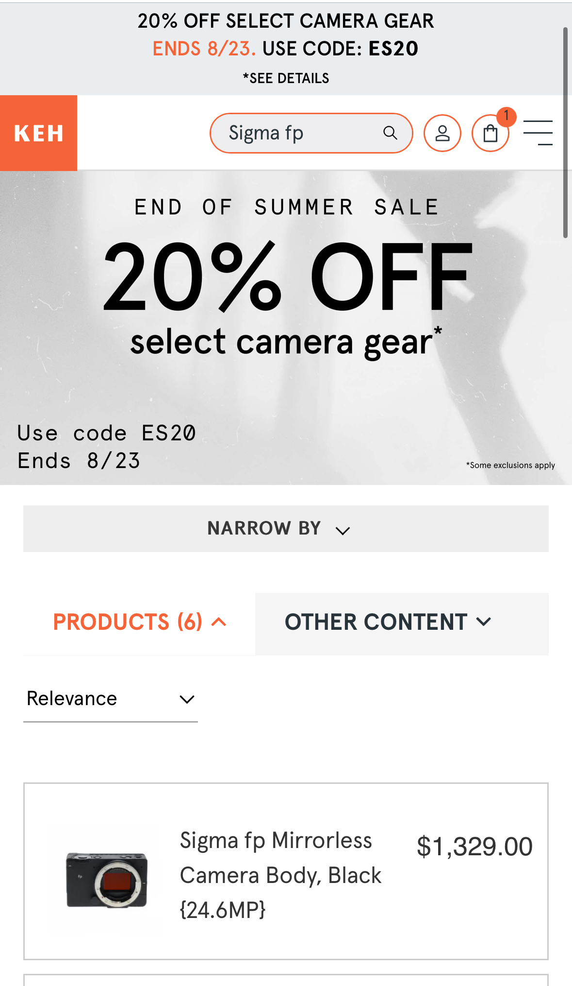

Ninpo33 Posted August 22, 2024 Share Posted August 22, 2024 Have spotted a couple Sigma FP’s at $950 U.S. this week. Exciting times for anyone like me who couldn’t justify the price tag a few years ago but now wants to dip their toes into a cinematic RAW workflow. Plenty on KEH, eBay and Japanese sites hovering right at $1,000. And the FP-L can be had for $1,500. There’s a big 20% off sale at KEH right now as well so plenty of great deals for the next few days on slightly used equip. Now if they would just give us an open gate or Anamorphic friendly crop for 1.5x - 2x and I’d be really happy. eatstoomuchjam 1 Link to comment Share on other sites More sharing options...

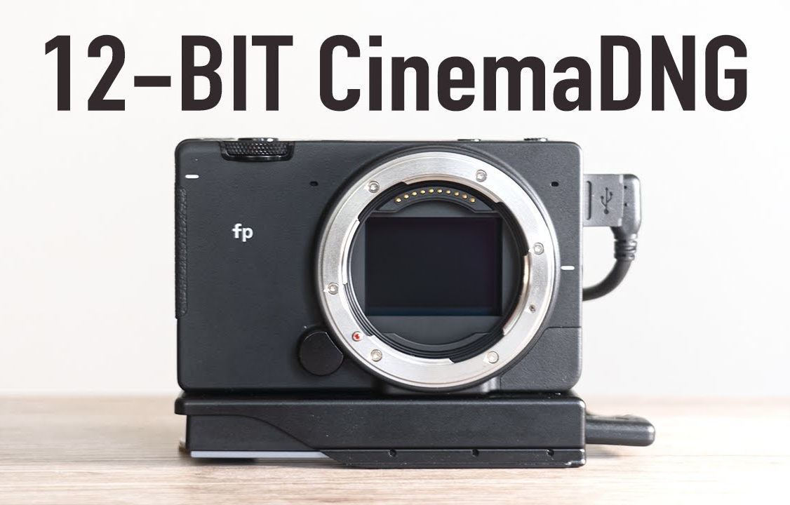

Ninpo33 Posted August 22, 2024 Author Share Posted August 22, 2024 1 hour ago, eatstoomuchjam said: FWIW, you can record in anamorphic-friendly modes on the fp, but you can't do it in raw (so you'll be limited to a mediocre h264). The trick is to use the director's viewfinder feature. 😃 Yes thanks. I consider the FP a camera that really shines in 12 bit raw but everything else is kind of crap. There is a really nice new SSD sled for NVME SSD’s from 52 Weeks that’s a tiny little package for raw shooting. I think at below $1,000 it’s a fun little camera. Link to comment Share on other sites More sharing options...
eatstoomuchjam Posted August 22, 2024 Share Posted August 22, 2024 Agreed that everything other than 12-bit raw from the fp is a bit crap. It also has a fairly dim non-flippy screen which requires using an external display, add-on EVF unless you want to sit directly behind the camera and hoping that you're not outside on a sunny day. Bottom mounted sleds can be a bit tricky because you'll either need to make it taller to handle 1/4x20 or lose the tripod mount. It looks like 52 Weeks went the route of losing the mount, but making the sled Arca-compatible. That can work, but only if you're the kind of monster who puts on their tripod mount sideways (making the use of almost any video-friendly tripod head pretty awkward, since the Arca Swiss mount on them is usually front-back vs side-side). Anyway, that sled is not too dissimilar from the DPL solution. You might also consider their "FP mate" side-mounted SSD sled option which won't need a cable and which also doubles as a weird/awkward left-side hand grip. https://darkpower.aliexpress.com/store/1102339831/pages/all-items.html?productGroupId=40000005805009&storeId=1102339831&sortType=bestmatch_sort&shop_sortType=bestmatch_sort Ninpo33 1 Link to comment Share on other sites More sharing options...

inde Posted August 23, 2024 Share Posted August 23, 2024 Privately, under US$1000 is the price for these at the moment until some youtuber decides they are the most bestest undiscovered thing since sliced bread. again.. However, one thing that turns me off these (I almost bought one) is the opaque workflow required in Resolve. On the BM forums there are some informative posts but it's unclear to me still what the recommended workflow is. I don't want to get into it but this is what Sigma has put on their blog. What is annoying is this tutorial is not clear or, as I understand it, even a proper color managed workflow. If you take a Sigma FP sample DNG into Resolve it's fine and I love how it looks set to clip in the raw tab. I guess I am just saying it would be a lot clearer if Sigma and BM would together and just say, 'this is the process..'. I think behind the scenes they have worked it out because of the seemlessness of Resolve (18.5.1). It's just all a bit opaque. After trying out the various workflows, I am happy with both CDNG and Braw. I don't need full frame so I've stayed away. P.S. Sigma is probably the coolest most amazing photo company eva 🥰. The lenses are amazing, I've never had a bad one. The short films they've produced are great, this one is drop dead gorgeous. I'm just having a moan about how Sigma CDNGs and Resolve work together. IronFilm 1 Link to comment Share on other sites More sharing options...
