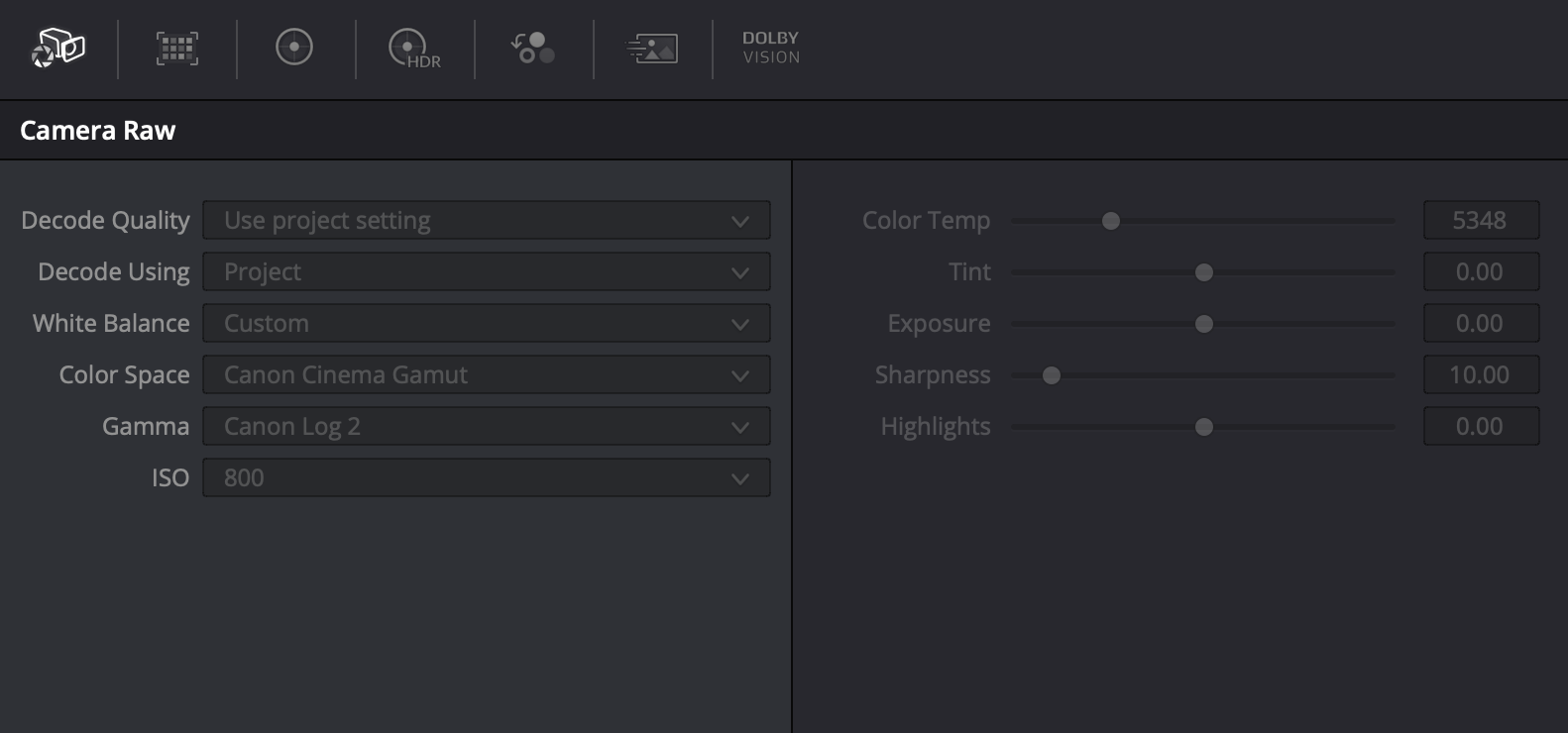

Hello! Have you tried lowering the sharpening Davinci applies when processing SRAW? It will likely reduce the moire. By default, in the Camera RAW settings (on the Color Page; see image), it's set to 10 which tends to be a bit strong and give the image an over-sharpened appearance. Try 0 or 2.
I find it helps a lot.
