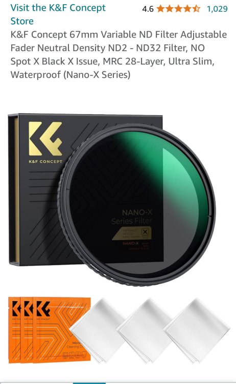

Super Members BTM_Pix Posted September 5, 2024 Super Members Share Posted September 5, 2024 This one works well for me. Link to comment Share on other sites More sharing options...
