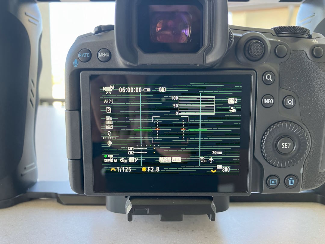

herein2020 Posted September 18, 2024 Author Share Posted September 18, 2024 4 hours ago, gt3rs said: Correction it seems the same and many have this issue: https://www.dpreview.com/forums/thread/4773815 I will try the above settings to see if it happens again. That is a good find, I think it is all related. I tried power cycling a few times today but it would not do it, I am trying to recreate the issue so that I can create a video of the problem to send to Canon. The two times it happened to me I hadn't pressed record yet. Also, switching to photo mode restored the back screen, but it went black again when I switched back to video. Link to comment Share on other sites More sharing options...
herein2020 Posted September 18, 2024 Author Share Posted September 18, 2024 Ok, I am reaching the point to where I have to say this camera is not ready for commercial production use. I had a full day commercial photo/video shoot and I made it through the shoot but I have lost all trust in the camera. Black Screen - this happened again on the shoot, pretty much every shoot it happens once. The video will not display only the photo back screen will display. This time I took a picture of it. Playback - After taking a picture then hitting playback it randomly will not show the last image taken, it will usually show the one before that or a random one, very annoying to keep asking the talent to pose again because I have no idea if the last image was a keeper. Auto Focus - This is the second shoot where it stops focusing. AF stops working at least for video and I have to restart the camera. Link to comment Share on other sites More sharing options...

herein2020 Posted September 18, 2024 Author Share Posted September 18, 2024 59 minutes ago, eatstoomuchjam said: Canon Rumors mentioned today that a firmware update was expected this month. Canon should also send a check to you for kindly beta testing their camera for them. Yes I saw that as well. CPS told me its a HW issue and I need to send in the camera....I'll wait until the FW update to see if things improve. It's insane to me that issues this major and this common made it through to even v1.0 of the FW. eatstoomuchjam 1 Link to comment Share on other sites More sharing options...
gt3rs Posted September 19, 2024 Share Posted September 19, 2024 9 hours ago, herein2020 said: Yes I saw that as well. CPS told me its a HW issue and I need to send in the camera....I'll wait until the FW update to see if things improve. It's insane to me that issues this major and this common made it through to even v1.0 of the FW. HW issue? It seems a typical buffer corruption issue... purely SW... but let see.... The picture that you posted is what happens to me, so far only in 200fps but I do shoot mostly in RAW. AF never stopped in my case, and I shoot 3 TB of video so far, all using AF. Was it with the adapter or RF? If it is with the adapter, then it seems to have an issue with it as first the aperture and now the AF both that needs camera+adapter+lens communication. Link to comment Share on other sites More sharing options...

herein2020 Posted September 19, 2024 Author Share Posted September 19, 2024 17 minutes ago, gt3rs said: From Canon rumors so it is a rumors 😉 Update: Canon has started to install firmware v.1.0.1 on serviced Canon EOS R5 Mark II camera bodies. This update looks like it addresses an issue with the screen going green when shooting video. I sent Canon a video of the problem and they have stated that it is an electrical HW defect, I am working with my retailer to either return it or exchange it. I am fortunately still within the 30 day window. I strongly recommend that if you can return or exchange yours that you do so before it is too late or you will need to file a warranty claim later if FW can't fix it. If I wait to see if the new FW update fixes it, I will be past my return window. I think after an exchange the 30 day return window resets so I will have peace of mind from that regards, unless of course the new one is worse. Link to comment Share on other sites More sharing options...
