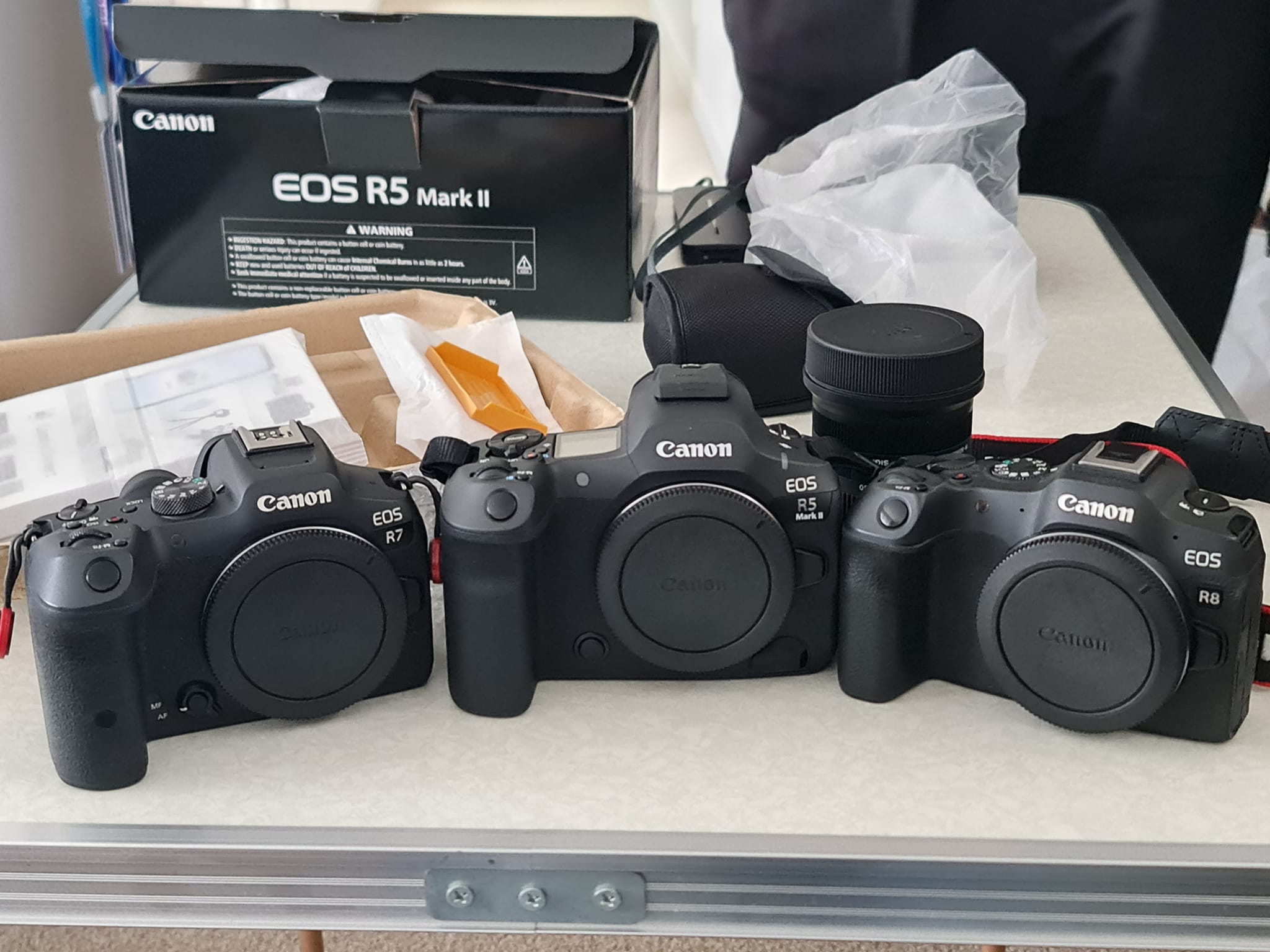

ntblowz Posted October 5, 2024 Share Posted October 5, 2024 I can feel the weight difference of R5II after using R7 and R8 for a while. If I still use the R5 then they are quite similar in weight. Link to comment Share on other sites More sharing options...
