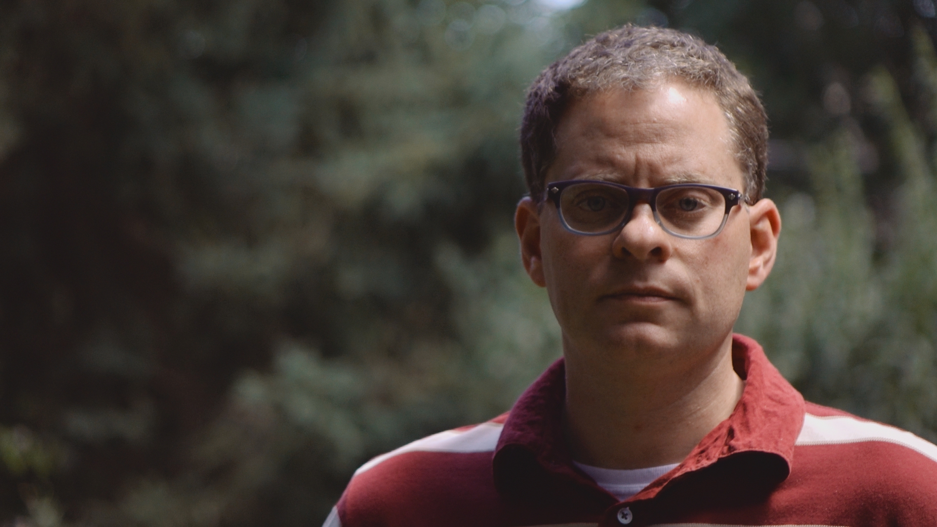

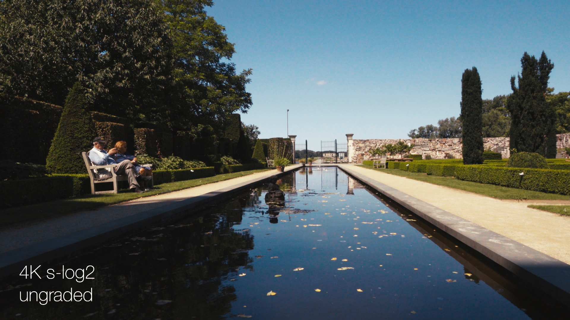

Mat Mayer Posted July 22, 2015 Share Posted July 22, 2015 This is the test footage I have been waiting for; ungraded S Log 2 in 4K. Camera still, outdoors: Eric Westpheling 1 Link to comment Share on other sites More sharing options...

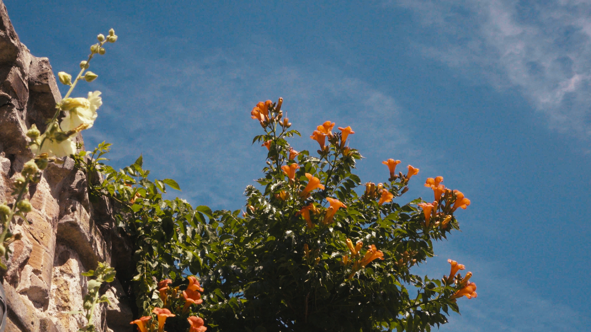

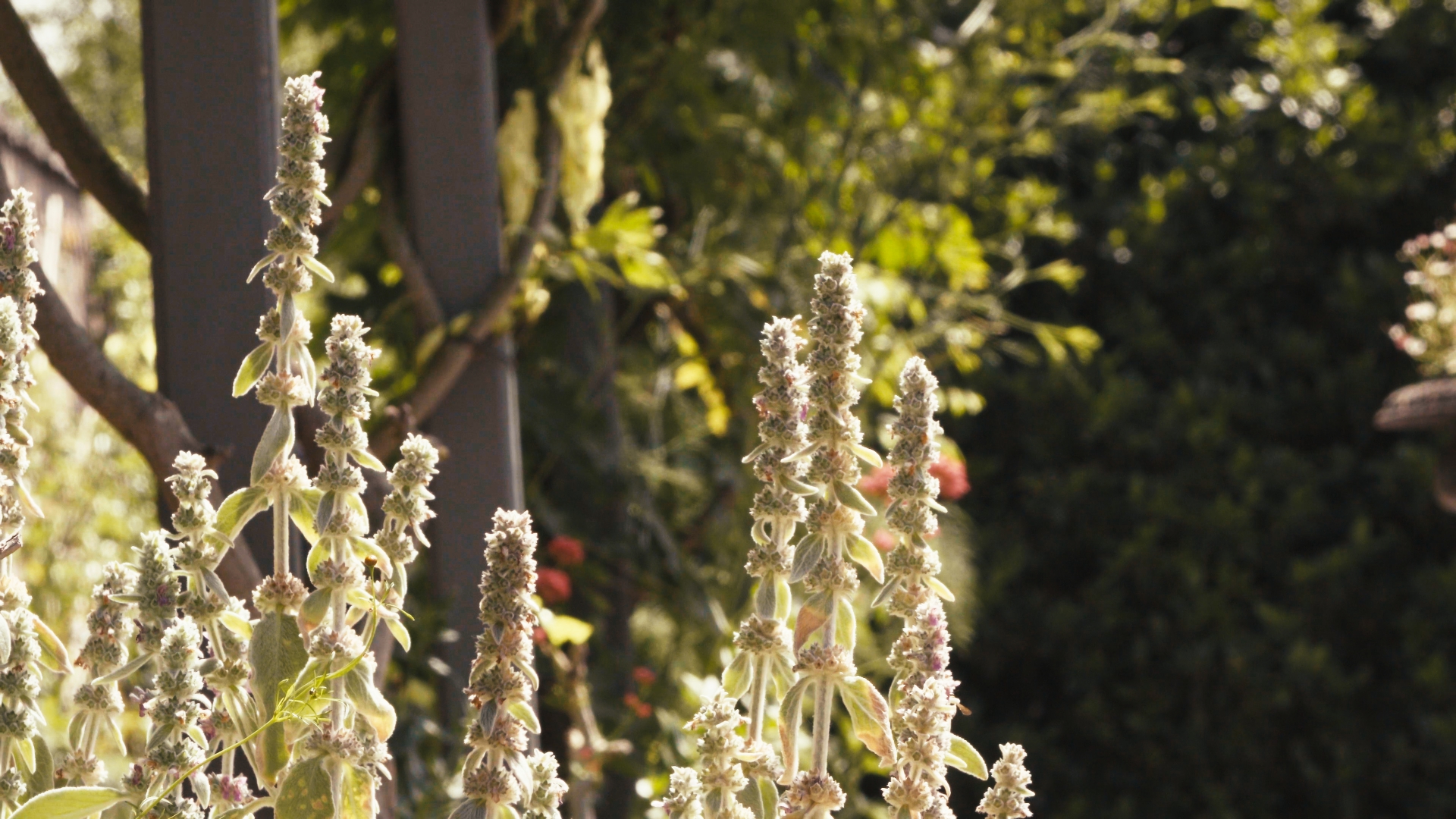

Guest Ebrahim Saadawi Posted July 22, 2015 Share Posted July 22, 2015 Thanks for sharing!It's interesting to see what shallow depth of field looks like with this camera. It's better then I imagined it would be. Though from the looks of it, it only works in situations where you've got the subject close to the lens. And in the example the bokeh seems a bit busy with the blueish outlines.Though technically a great camera, I'm still not convinced about the shallow DoF. At least when compared to a larger sensor.To get a hard number on it, the depth of field equivalent on a 5D (we all shot on one at some point) is about F8 throughout the range. So as you know, a 50mm F/8 lens on a 5D is a pretty deep look. But if you go to the longest end, a 200mm F8 lens on a 5D is pretty shallow. To give the information out there, there are three elements that control depth of field. 1- Aperture 2- Focal Length 3- Distance to subject We don't have great no. 1 (aperture) on the RX10, it's f8. So you're going to have to play on the two other elements to get a shallow depth of field. Meaning, increasing focal length, and decreasing subject distance.In short, you zoom in as far as possible, and get as close to the subject as the minimum focus distance allows. This is how we used to do it on the good old days before the 5D, go back and zoom in with that DVX100! IT IS a limitation on the RX10 that you will never get the shallow aesthetic you get with a s35 and a 50mm F/1.8, or 85mm F/1.8, that kind of look. I would not use the RX10 as a sole camera for narrative work, I'd definitely use it as an A camera but make sure to have even a s35 d3300 + 50mm F1.8 for those epic close ups when needed as a B camera, while the RX10 handles those wide detailed shots and long shots, handheld (IS), zooming, high DR scenes, etc. Just not alone for narrative/music work, depth if field is quite deep unless you really zoom in and get too close. Link to comment Share on other sites More sharing options...

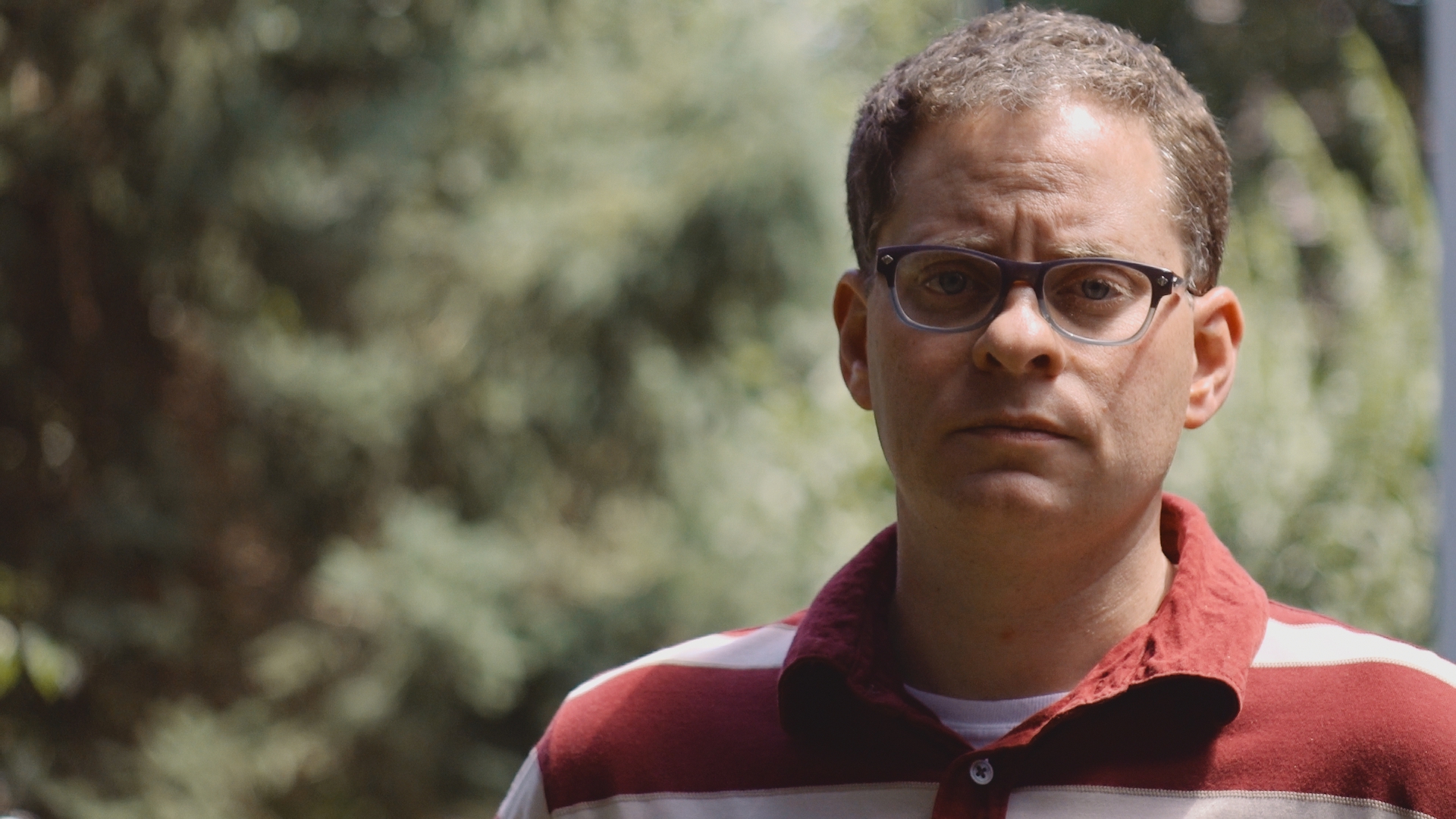

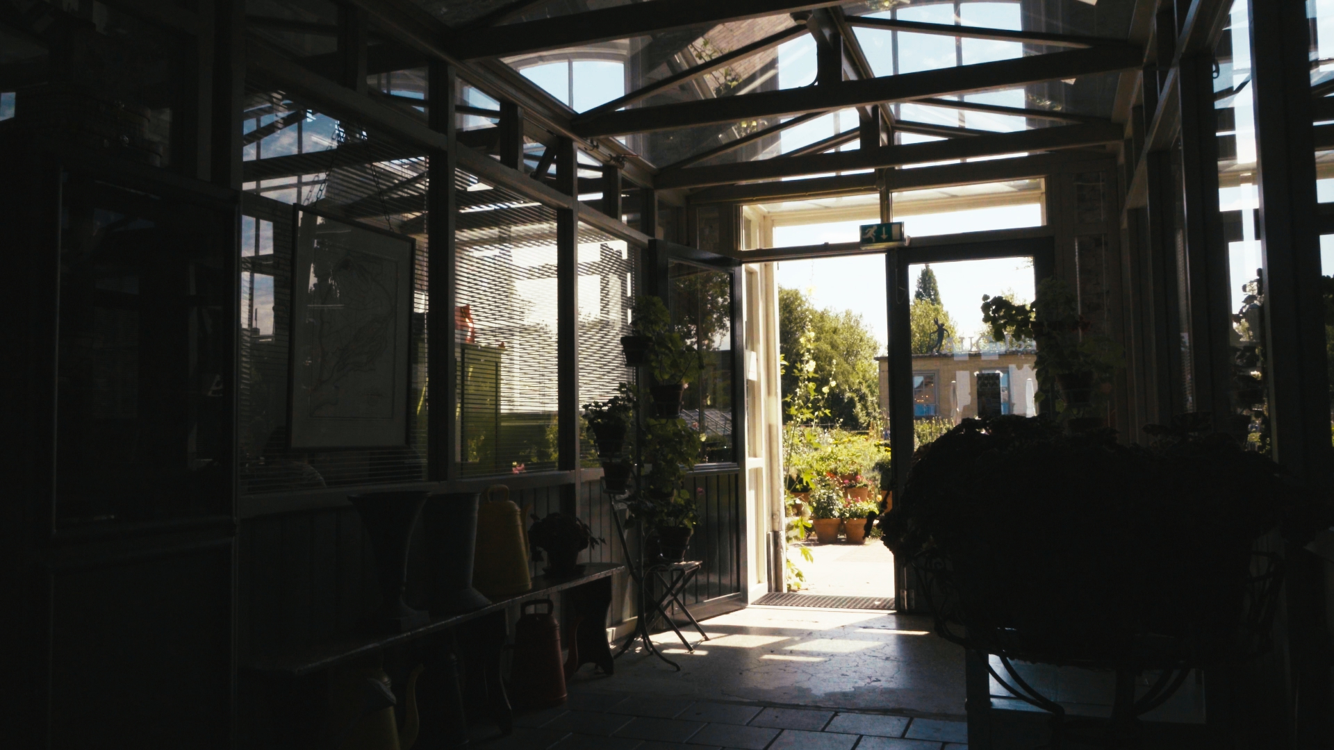

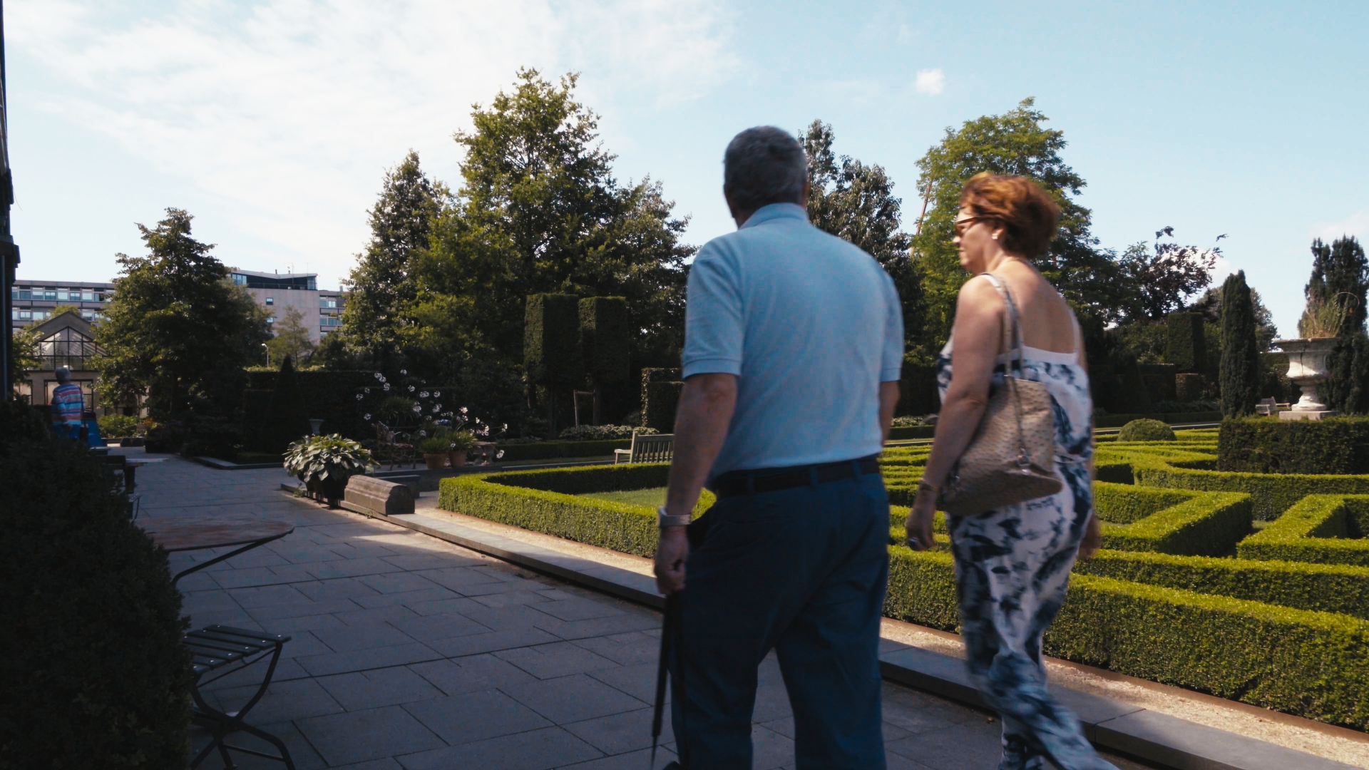

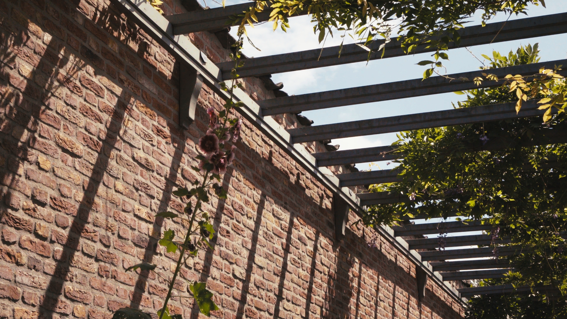

Guest Ebrahim Saadawi Posted July 22, 2015 Share Posted July 22, 2015 This is the test footage I have been waiting for; ungraded S Log 2 in 4K. Camera still, outdoors:This certainly doesn't look good downloading the ProRes Vimeo file.It's very soft, not organic soft, but mushy soft. And colours, this is typical a7s colour science, spot on. (whatever that means to you). It does downscale to 1080p with sharpening and makes very clear 1080plooking at 4K 1:1 Very mushyHowever downscaling to 1080p and grading and sharpening gives sharp 1080p (these results look worse in compression than the originals due to EOSHD web upload)It feels like I am grading my A7s S-Log files but just noisier, same colours, resolution, gamma, dynamic range, same ''image feel and aesthetic''.@There are compression artefacts due to vimeo upload so I ignore that, but resolution and colour science are always pretty well conveyed through vimeo and youtube 4K.Perhaps something went wrong with his pipe-line from shooting to post to uploading. So will reserve judgment entirely, just grabing whatever 4K S-Log files I could find and getting a first impression, not a real impression. Link to comment Share on other sites More sharing options...
vaga Posted July 22, 2015 Share Posted July 22, 2015 There are also seems to be some banding (Could be because of compression) Link to comment Share on other sites More sharing options...
Eric Westpheling Posted July 22, 2015 Share Posted July 22, 2015 This is the test footage I have been waiting for; ungraded S Log 2 in 4K. Camera still, outdoors:Here are some graded versions of this footage. A compressed version is available to download from vimeo. Just playing around, but it looks very nice. agolex, vaga and Mat Mayer 3 Link to comment Share on other sites More sharing options...
