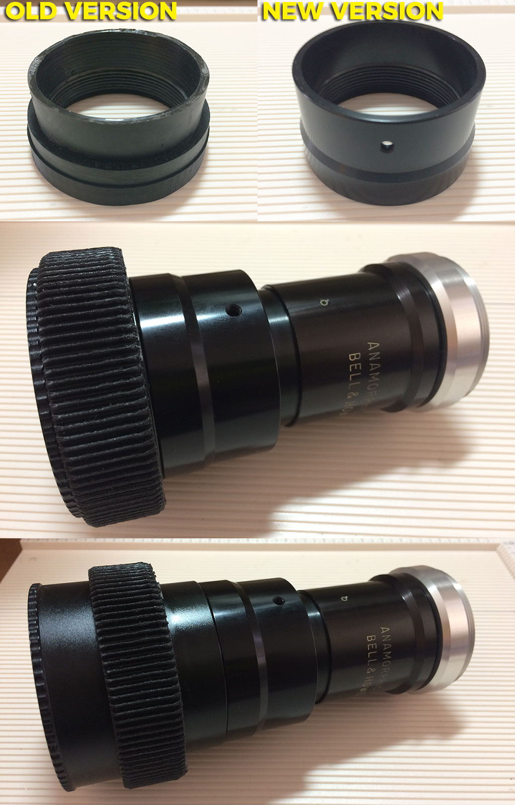

Bold Posted May 19, 2017 Author Share Posted May 19, 2017 On 4/27/2017 at 9:45 AM, Bold said: I've decided to bite the bullet, and engage a machinist to create an aluminum part to replace my polyurethane. Well that cost more than I had hoped, but the new machined aluminum collars fit great, and have been dropped off for anodizing. Now I just need to order some lock screws. Once I get everything back, I will post pics of my B&H mod Mk II. Should be ready by the beginning of June. nickgorey and Tito Ferradans 2 Link to comment Share on other sites More sharing options...

Bold Posted May 31, 2017 Author Share Posted May 31, 2017 Just got my new machined parts back from anodizing. Here's a quick tease: The fit & finish on these things is pretty darned good. I'll post more details once I've had a chance to kick the tires. livetheshot, Dr. Verbel' and Tito Ferradans 3 Link to comment Share on other sites More sharing options...
Bold Posted July 3, 2017 Author Share Posted July 3, 2017 Here is some crappy test footage I've made using my B&H mod. The first test uses a 14mm helicoid, with the original polyurethane/prototype housing: The second test uses a 30mm helicoid (which allows focus down to about 8-9 inches) and a custom-fit aluminum housing that replaces the polyurethane: All footage was shot using my beloved silver Helios-44. Except for a few underexposed shots where I boosted the brightness, all footage is straight out of the camera & unaltered (I'm far too new at this to attempt color grading, anyways). Dr. Verbel' and Timotheus 2 Link to comment Share on other sites More sharing options...
