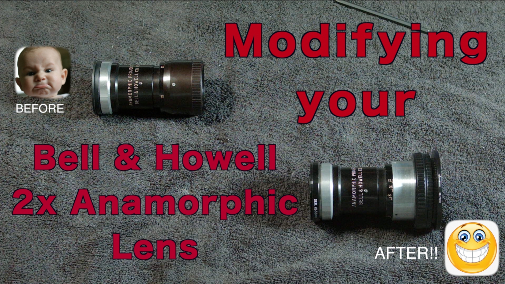

Paul Kepner Posted March 1, 2021 Share Posted March 1, 2021 If you have one of the small Bell & Howell 2x anamorphic lens and want to modify it to make it more usable then you need to watch this tutorial video. I tried to cover exactly how to modify it in detail and close up so you will feel confident in converting your lens. If you have any questions at all leave a comment on the video or here and I will do my best to try and answer them for you. https://youtu.be/_oONjRSZ7_k Link to comment Share on other sites More sharing options...
