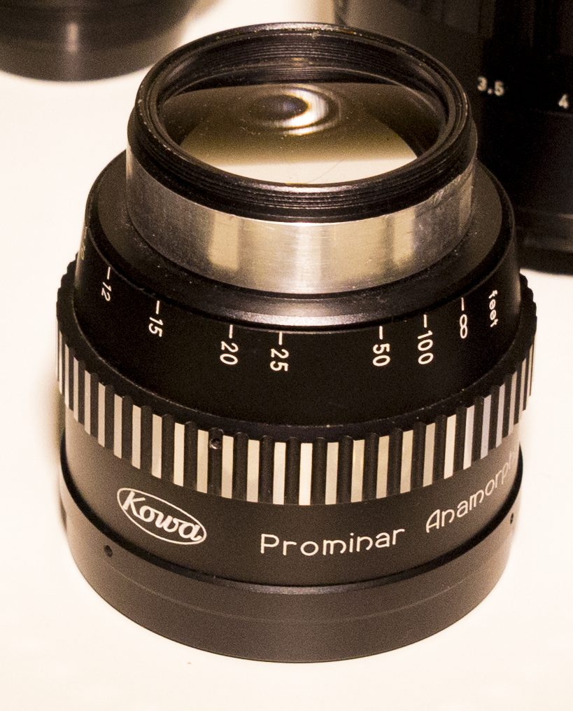

Distant Signal Posted July 22, 2015 Share Posted July 22, 2015 Will this adapter work with a Kowa 1.5x? I own the Anamorphic-35 Prominar. Link to comment Share on other sites More sharing options...
Zak Forsman Posted July 22, 2015 Share Posted July 22, 2015 no reason it shouldn't. you might need a Redstan clamp to give yourself some threads to screw it on though. Link to comment Share on other sites More sharing options...
