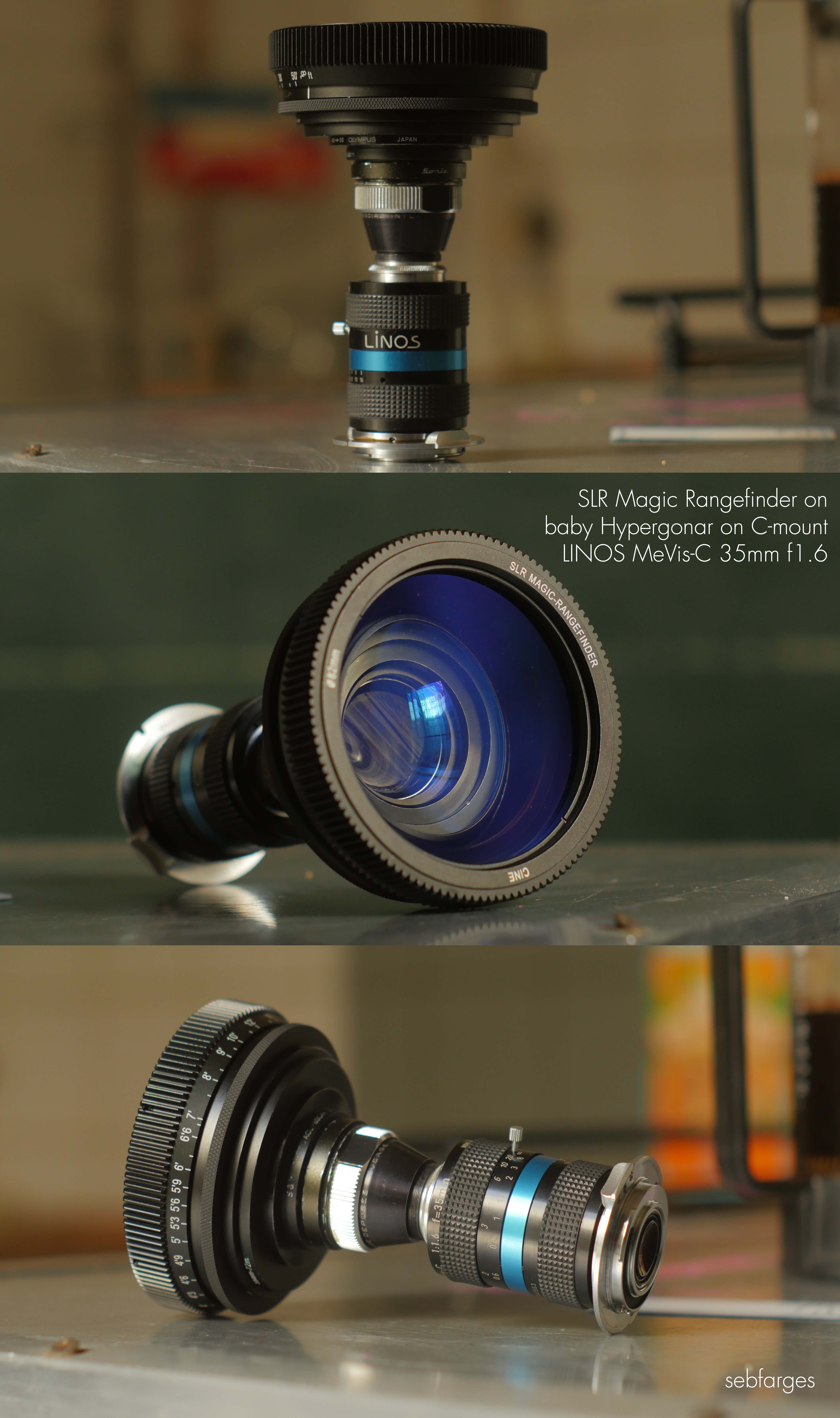

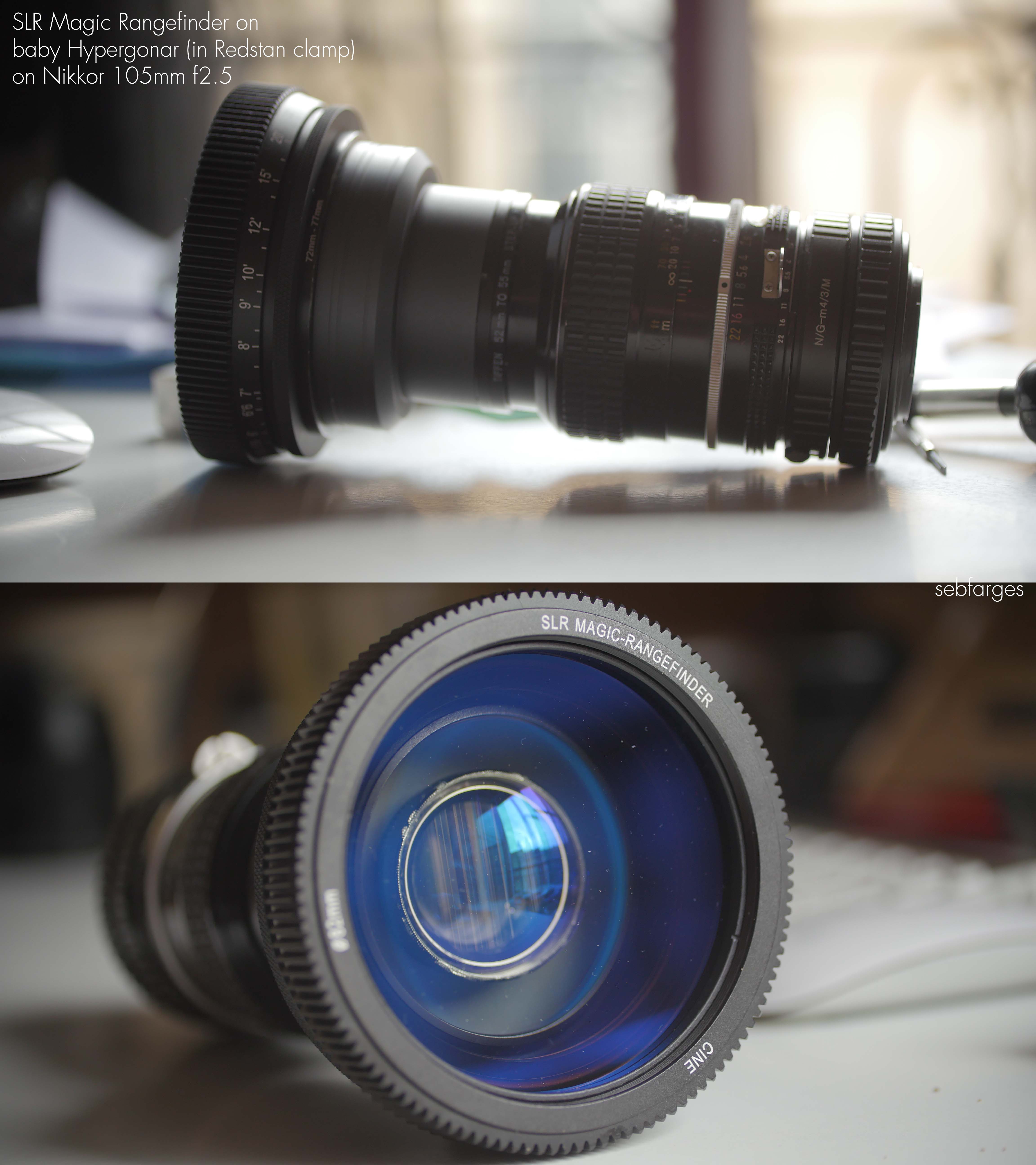

Sebastien Farges Posted July 23, 2015 Share Posted July 23, 2015 Yes it could be great in a mini version ! Ian Edward Weir, dahlfors, sudopera and 1 other 4 Link to comment Share on other sites More sharing options...
