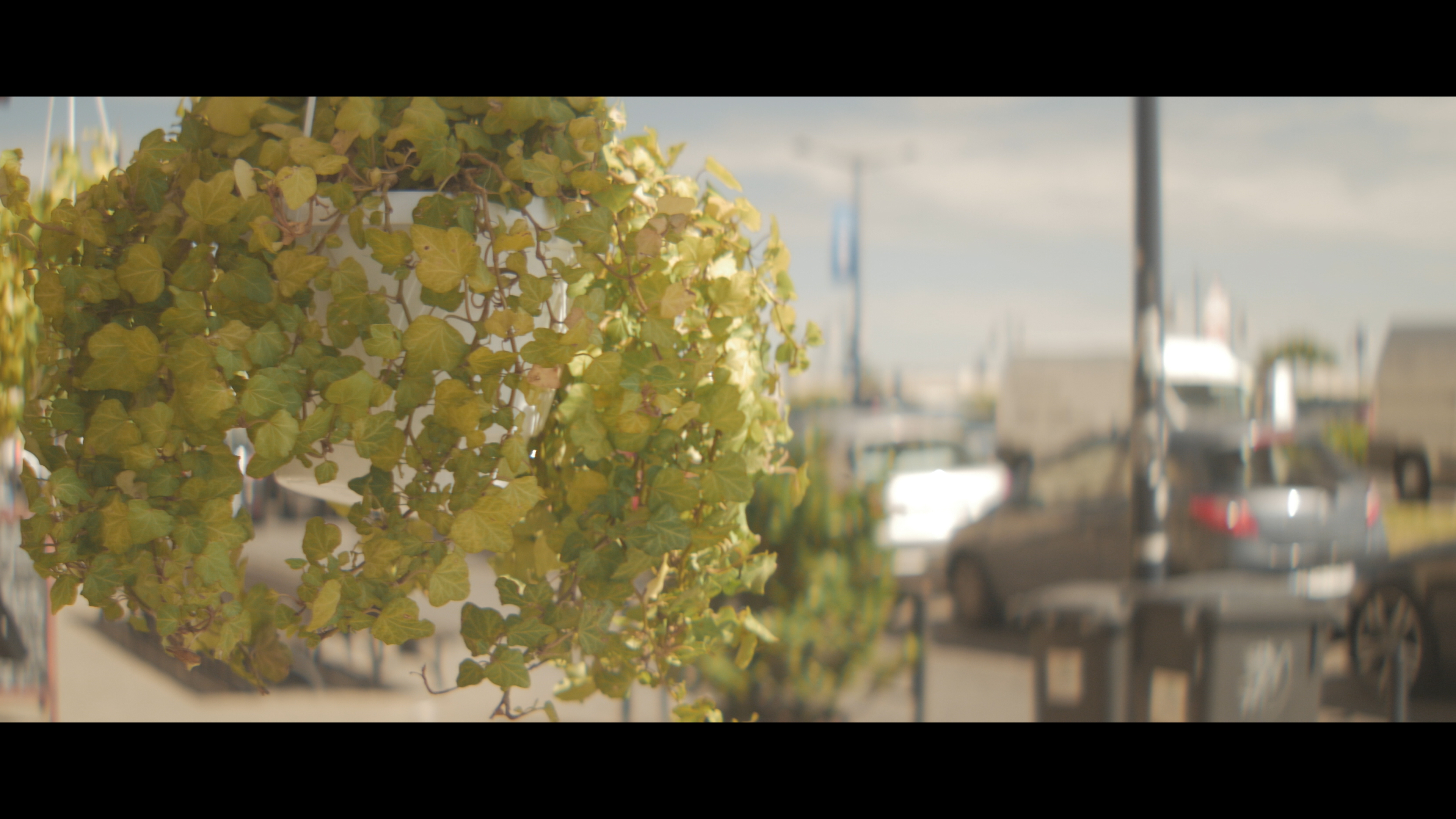

Zak Forsman Posted July 23, 2015 Share Posted July 23, 2015 a few more clips. forgive the camera bounce on the focus pulls, I hadn't had my coffee yet. Markus Houy, sudopera and Julian 3 Link to comment Share on other sites More sharing options...

Zak Forsman Posted July 24, 2015 Share Posted July 24, 2015 one thing i know for sure is there will be no witness marks on the budget version. not sure what else might be stripped away. here's some more clips I shot a couple hours ago. Caleb Genheimer and Ian Edward Weir 2 Link to comment Share on other sites More sharing options...

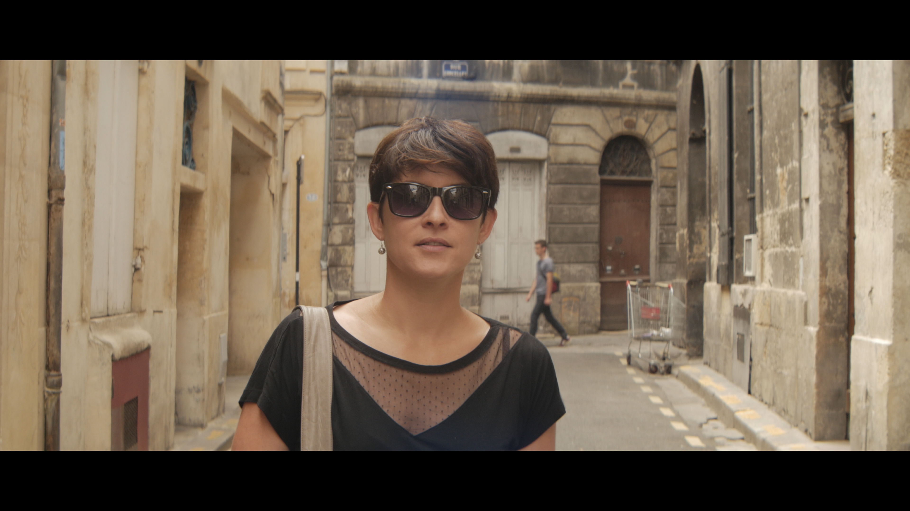

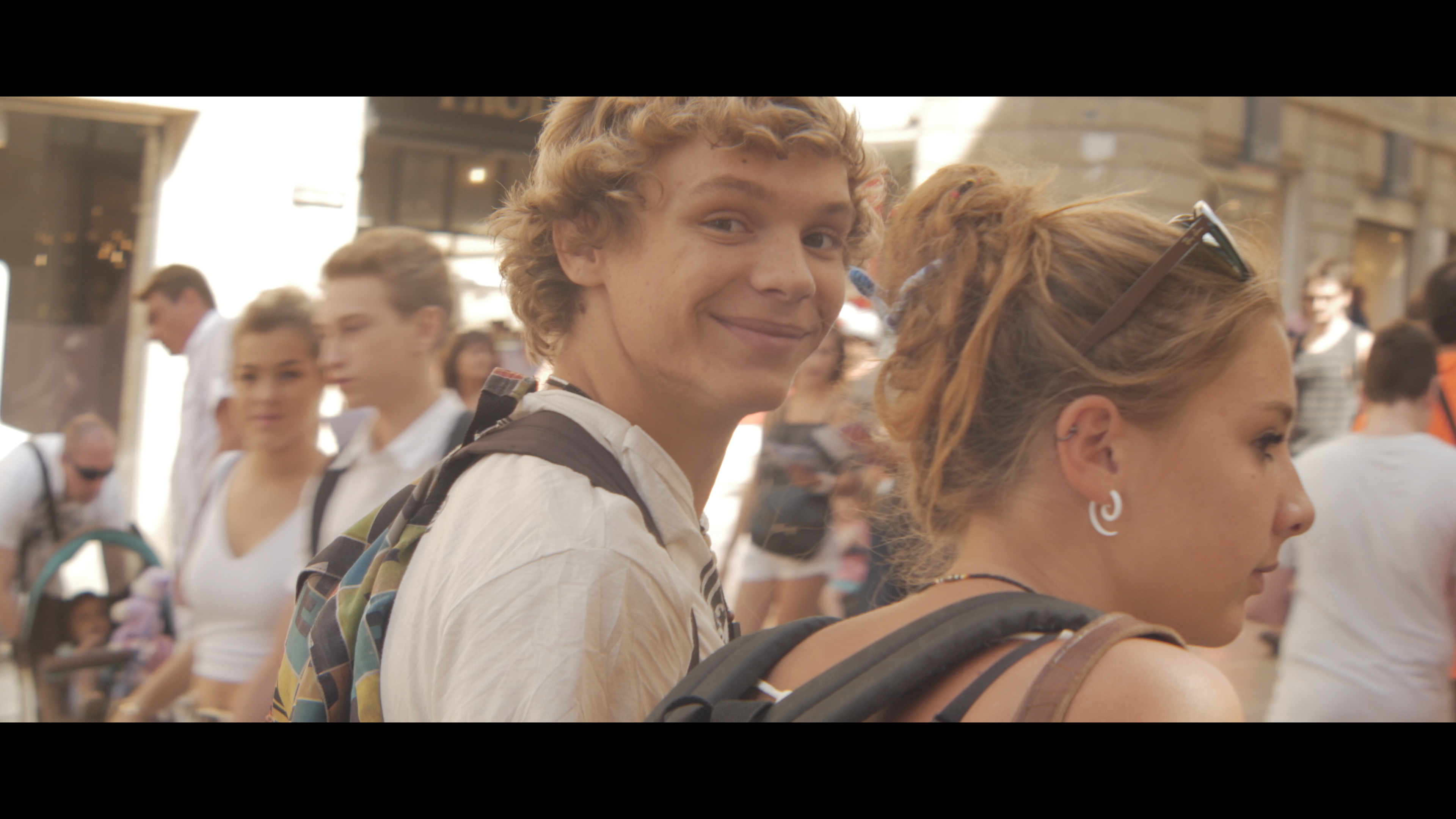

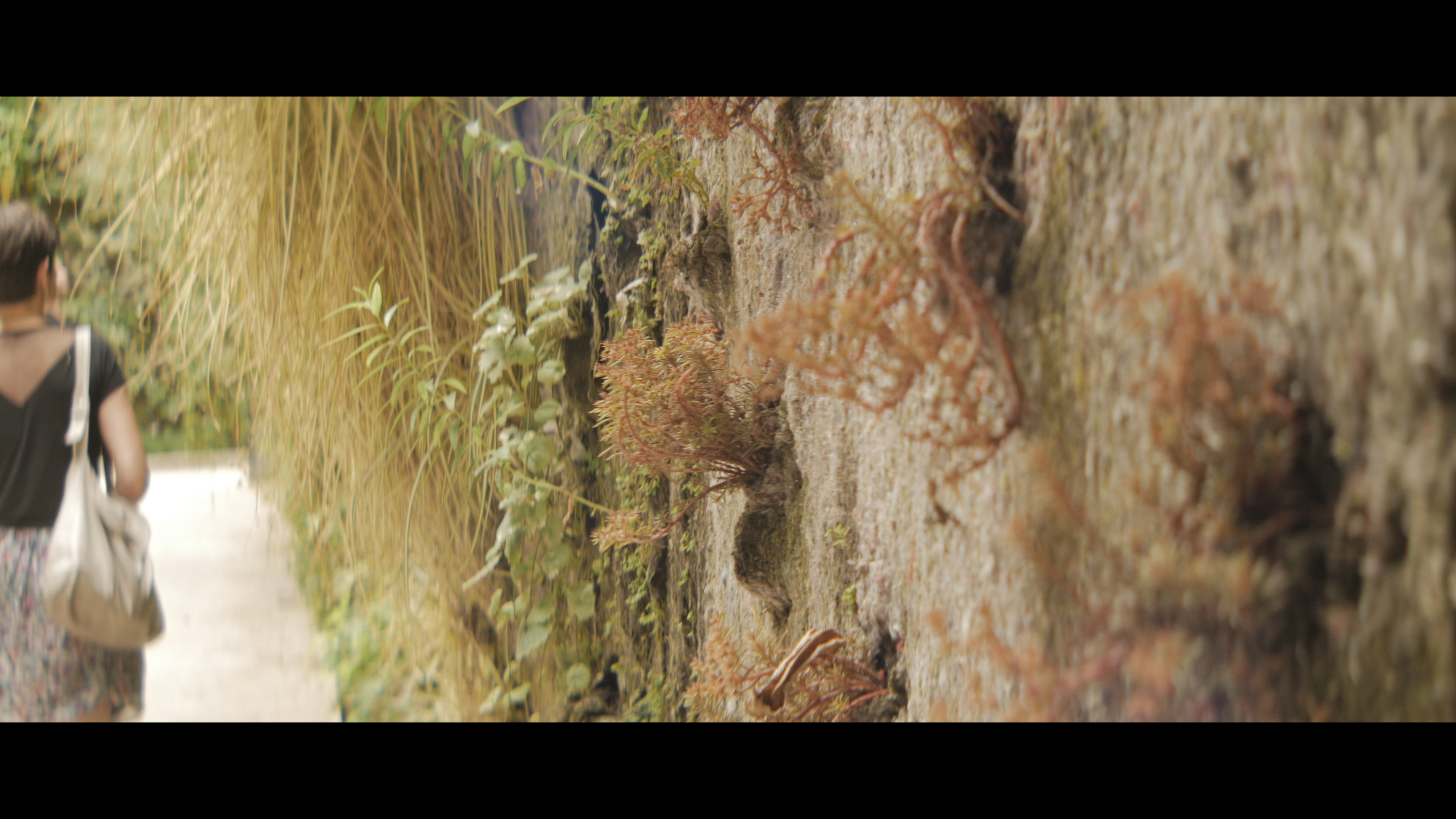

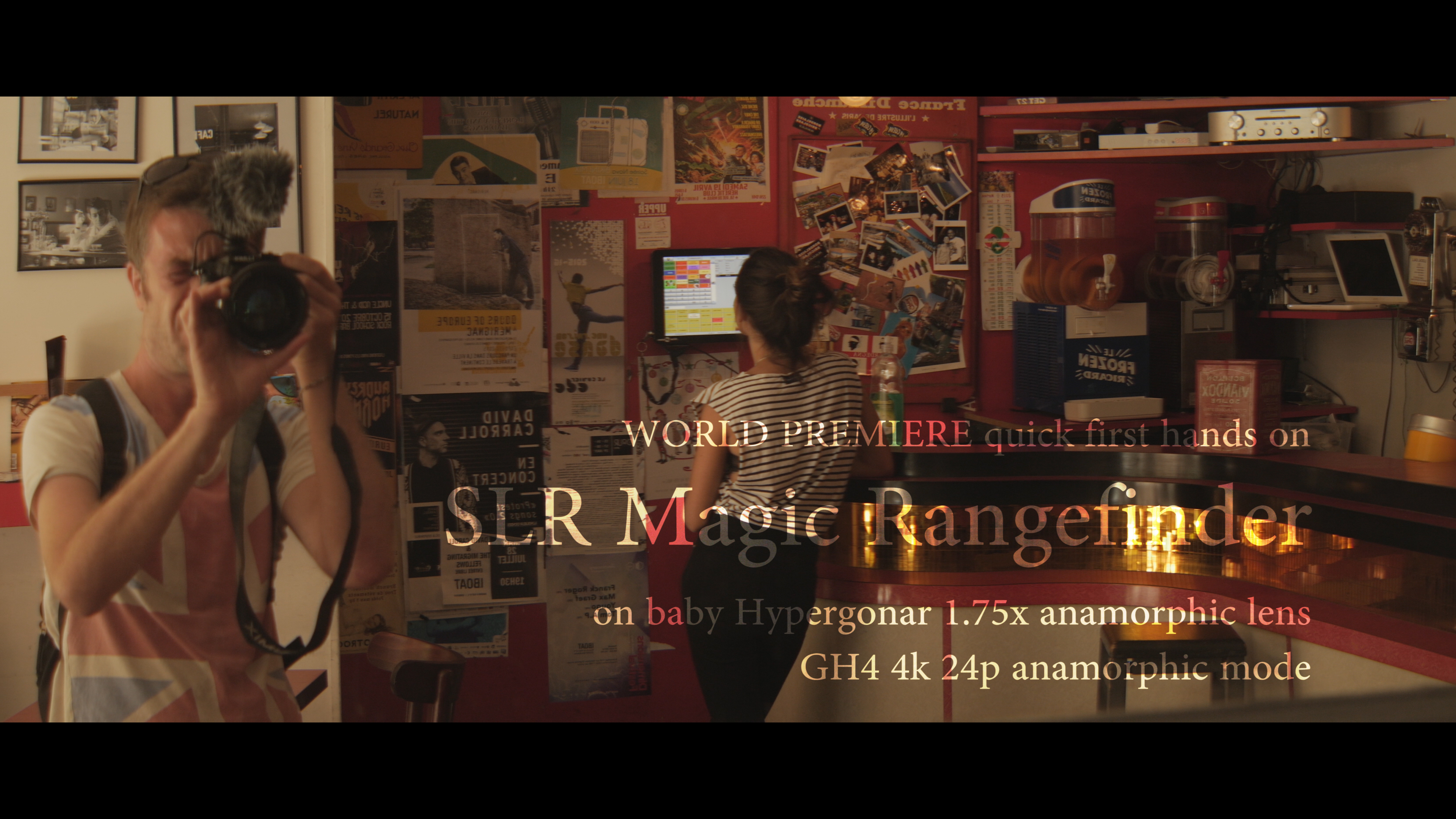

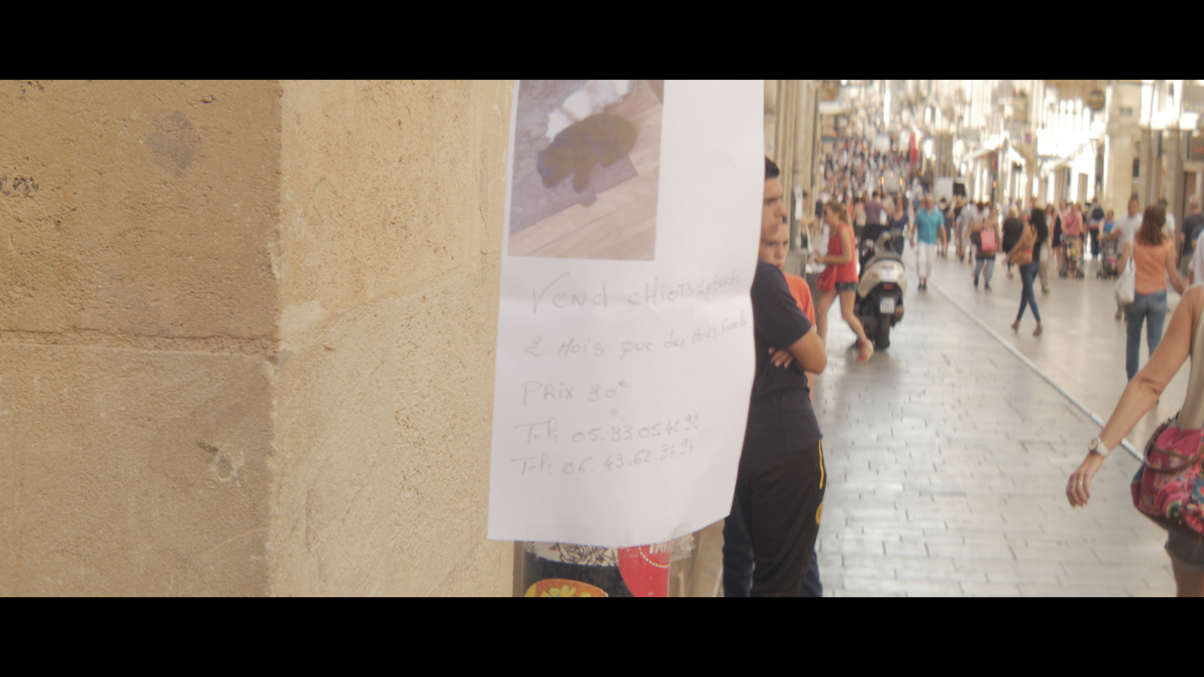

Sebastien Farges Posted July 24, 2015 Share Posted July 24, 2015 SLR Magic Rangefinder video stills from movie upcoming at the end of the day Ian Edward Weir, MattH and Julian 3 Link to comment Share on other sites More sharing options...
DBounce Posted July 24, 2015 Share Posted July 24, 2015 On 7/24/2015 at 11:19 AM, Sebastien Farges said: SLR Magic Rangefinder video stills from movie upcoming at the end of the day I was just about to type that it looked soft, but these stills make me want to reserve judgment until I see more footage. If it can hold its sharpness I'm all over this thing. If not it becomes more of a special use device. Link to comment Share on other sites More sharing options...
Guest Ebrahim Saadawi Posted July 24, 2015 Share Posted July 24, 2015 Yes soft and hazy, flarey, with a local low contrast filter streaks.Perhaps it's the nature of the taking lenses used here I hope. Thanks for the stills @Sebastien Farges What are the lenses and how much of optical change did you notice? Link to comment Share on other sites More sharing options...
