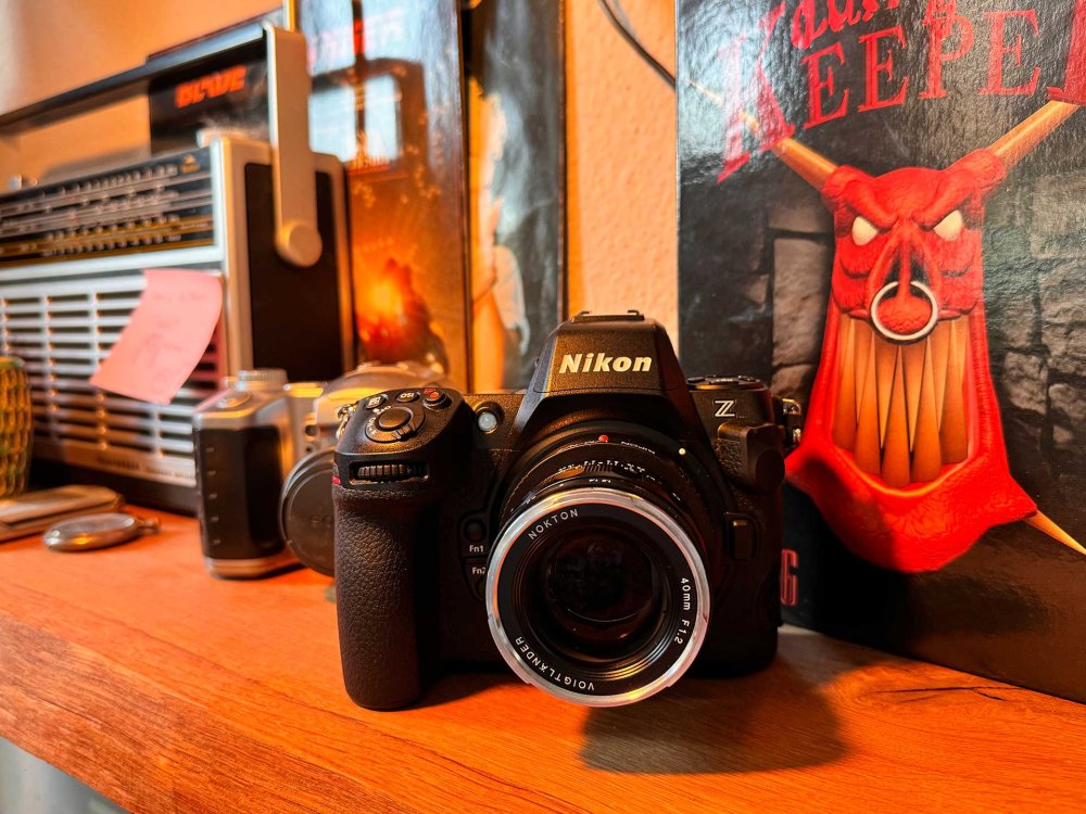

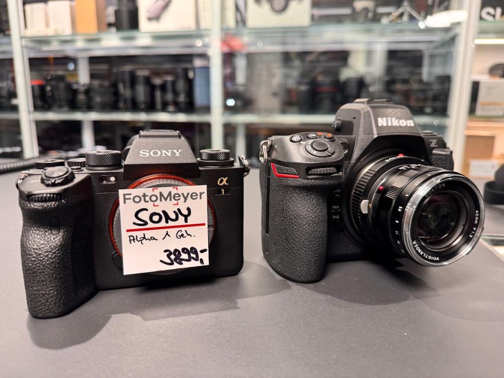

Administrators Andrew Reid Posted yesterday at 11:45 AM Administrators Share Posted yesterday at 11:45 AM 🤯 So some early doors impressions of the Nikon... It's been out a while so I won't get into the specs again. The overwhelming impression is that Nikon are mad bastards. It's as if they have taken the Z9 and gone... right let's make this better and reduce price by a lot. Everything about it I prefer to the Z9. The price, the size, the newer features and firmware updates since launch which I am discovering for first time since I sold my Z9 a couple of years back. Size wise, it's barely larger than my EOS R5. Weight is impressive given the slightly oversized body vs the Sony cameras. It feels chonky but light at same time which is a nice feeling. I am reminded how well the Nikon Z mount filter stack works at fast apertures. The manual glass I have like the Voigtlander 40mm F1.2 VM is like a different lens on the Z8 compared to the EOS R5 and Sony a7 IV. The glowing edges are gone at F1.2 and less fringing too. F1.2 looks almost as good as F2! I have gone deep into the menus and decided that there's absolutely nothing missing. The different levels of compression for both RAW stills AND RAW video is refreshing especially coming from Panasonic where's there's only ProRes RAW with very large file sizes or uncompressed Cinema DNG on the Sigma Fp-L. Nikon with the RED patent clearly will lead the RAW video codec race for perhaps the next 10 years or more. I want to do a comparison in 4K (where you can toggle between pixel binning / oversampling!) between the higher bitrate N-RAW and 700Mbit/s smaller file size N-RAW. Of course ProRes RAW is also in there. No mechanical shutter doesn't seem to be a problem so far and you can make it do a cute beep when taking a shot instead of a tacky fake shutter sound. Rather a quiet or optionally silent stills camera than one with a loud average shutter clack... although I will one day miss the 'feel' of a quiet mechanical shutter with a satisfying heft. X-H1, Leica SL2, GFX 100, to name a few. There are still a few mechanical sounds coming from the Z8. And one of them is actually quite annoying... It parks / locks the IBIS mechanism to save power / protect the camera every time you enter the main menu. It parks it with quite a loud clank and unlocks with a similar clank when it activates again. Wish there was a way to turn that off without disabling VR. The only other mechanical part is the sensor protection curtain which comes down at power-off, but you can choose whether to have that off or not. The EVF is enormous. In optical terms the best I've ever used. In resolution terms, perhaps not the absolute most detailed but right up there. Can you use it for manual focus at F1.2 without peaking? Absolutely. There's not this feeling you are looking through a tunnel. It's smooth, high contrast, a big FOV flat with no distortion. The rolling shutter appears to be a complete non-issue and there's no crop whatsoever in 4K/120p. Not tried the 8K/60 yet. I have a few 512GB CFexpress cards to test. Got a feeling I might need to go bigger. I am glad I resisted the tempting Nikon Zf. Only thing I am unsure about is whether the Z8 shares the same level of locked-down IBIS performance in video mode as the Zf, as that was quite incredible. Also tested the Nikon 28-200mm travel zoom which has been reduced recently to around 650 euros. I am surprised how small it is and how light. Sure, it's slow at f4-6.3 but it seems pretty sharp and nifty as a shot getter. The 28-75mm F2.8 Nikon Z is also incredibly small and light for a bright zoom. Not tried the Sigma ART E-mount range yet via the Megadap adapter but those are next up. newfoundmass, Ninpo33, ita149 and 1 other 4 Link to comment Share on other sites More sharing options...

Administrators Andrew Reid Posted 17 hours ago Author Administrators Share Posted 17 hours ago 2 hours ago, Davide DB said: Whan you can, would you mind to share a couple of raw clips shot by you so I can see how they its on my workflow? This is the plan. I have shot some various formats today around the Tiergarten in Berlin... Most cinematic duck shot ever. Will upload later to a Google drive folder. I am very happy with it so far. There are a few quirks, nothing major. Finding myself nailing manual focus on the Voigtlander 40mm at F1.2. So the slightly lower-resolution EVF vs Z9 might actually help, as it has a bit of aliasing on the focus plane. The main LCD is sharp as tack. Mega detailed and bright. Small thing but you can't assign movie recording to the movie recording button. Better explain further... In stills mode the movie recording button acts as a func. button, none of the functions are to start/stop movie recordings in stills mode. So it's a good job it has that quick to reach stills/movie lever isn't it? Size is fine. Weight is barely any different to the Sony a1. I actually prefer the ergonomics especially in cold weather with gloves. Incidentally the a1 itself popped up later in the day on same shelf I picked Z8 from yesterday. For a good price too. It's a bit smaller, but it feels just that little bit more dated compared to the Z8 with just a little bit less charm. Still a damn good choice for under $4000 though. Davide DB 1 Link to comment Share on other sites More sharing options...
Administrators Andrew Reid Posted 17 hours ago Author Administrators Share Posted 17 hours ago I asked Foto Meyer if they had any S1R II as well. Apparently they sold out within days, but it's not clear whether this initial shipment was 3 units or 300. So will have to wait a bit longer to try one. By the way I did notice again how soft the Leica M mount lenses inc. Voigtlander were on the Sony at fast apertures vs the Nikon Z8. Link to comment Share on other sites More sharing options...
