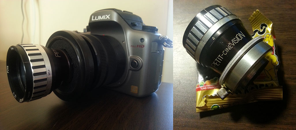

Julian Posted July 27, 2015 Share Posted July 27, 2015 I love the Moller, I don't have one though. I'd pay a lot for it if it was single focus... I think it's the best baby for sure.I'm the lucky owner of a Petit Cinevision. It's probably not the best baby in town, but I love this little lens. Since I picked it up in 2013 I have never seen one again and it is impossible to find something about it on Google. A real unicorn! I really have to take my baby out sometime again... Hans Punk, dahlfors and Bold 3 Link to comment Share on other sites More sharing options...
Rudolf Posted July 27, 2015 Share Posted July 27, 2015 Hey Julian, your Petit Cinevision must be really one of the rarest anamorphic adapters out there and I remember the discussion about it here on the forum back then... And YES - you should take it out as the image looks very good! BTW the focusing with the Bolex-Möller is so easy because you can just grab both taking lens and the Möller and focus both at the same time. This works because the throw of the Möller from 1m to infinity is only about 90º (from 0.5 to 1m it is another 90º) But this doesn't work with Nikons of course... but great with Canon FD for example. Julian 1 Link to comment Share on other sites More sharing options...
Hans Punk Posted July 28, 2015 Share Posted July 28, 2015 Yes, the CineVision 8mm is a pretty wonderful lens.Mine is not branded 'Petit' though...but it is the same tiny size. I've only ever seen the 2x versions appear on ebay once every year or so, the 1.5x model seems to be even more scarce. Below is old and boring video from mushy h264 from 7D, would really shine on a GH4 methinks.Far right of this pic, shows how tiny it is Julian 1 Link to comment Share on other sites More sharing options...
Julian Posted July 28, 2015 Share Posted July 28, 2015 Didn't know there is a 2x version. That would be even better on the GH4 in anamorphic mode! Hans Punk 1 Link to comment Share on other sites More sharing options...

valid Posted July 29, 2015 Author Share Posted July 29, 2015 That Cinevision looks great! Hans - is that a tiny taking lens attached to it? (the zebra ring)Does anyone have any experience with the yashica 8 or sankyoscope? Link to comment Share on other sites More sharing options...
Hans Punk Posted July 29, 2015 Share Posted July 29, 2015 Zebra ring was from part of an old m42 extension tube that was repurposed to make the focus ring on the CineVision easier to rotate once in its custom made mounting collar. These smaller 8mm scopes pose a few mounting issues sometimes, but nothing that a bit of igininuaty or Redstan could remedy. Not tried Sankyoscope, but Yashica looks the closest to the CineVision in terms of design and size, so I'd expect that to deliver similar results but I have a hunch that the CineVision types have higher grade optics. valid 1 Link to comment Share on other sites More sharing options...
