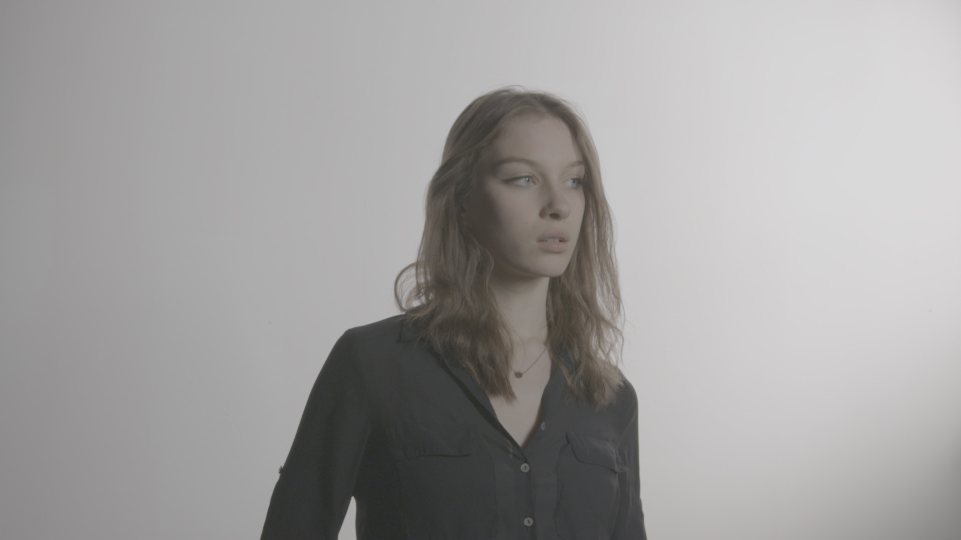

Oliver Daniel Posted July 31, 2015 Share Posted July 31, 2015 I'm surprised at the lack of chat about how lighting affects color rendering. Yes, there are a lot of sloppy grades out there for the A7S, but how many of these people used the ISO function to digitally enhance the lighting on their subject? Probably many. I did a test with the A7S with a model and used the ISO to expose the image. Then I did the same but used 2 LED 1x1 and a Dedolight as a kick instead of boosting ISO. Surprise, surprise - the colour and overall image quality was a million times better! While this is blindingly obvious, I see a lot of critique on the quality of camera footage from tests, yet these tests didn't utilise the simple practice of using proper light sources. So when we say LOG is crap in 8bit, what footage are we talking about? I expect it will look like a cocktail of sick, shot at 80,000 ISO on the A7S. Also how many know how to expose a log image properly? It's very tricky until you "get it". I get it wrong often, lots always to learn. My opinion, 8 bit is mostly fine for log - just don't expect it to work wonders in certain conditions. Use decent light sources, expose properly, set up the WB correctly and results should be great! Canon has better log than Sony (based on color) and the major difference with 10bit for me are smoother gradients, deeper colors and greater tonality. kidzrevil 1 Link to comment Share on other sites More sharing options...
