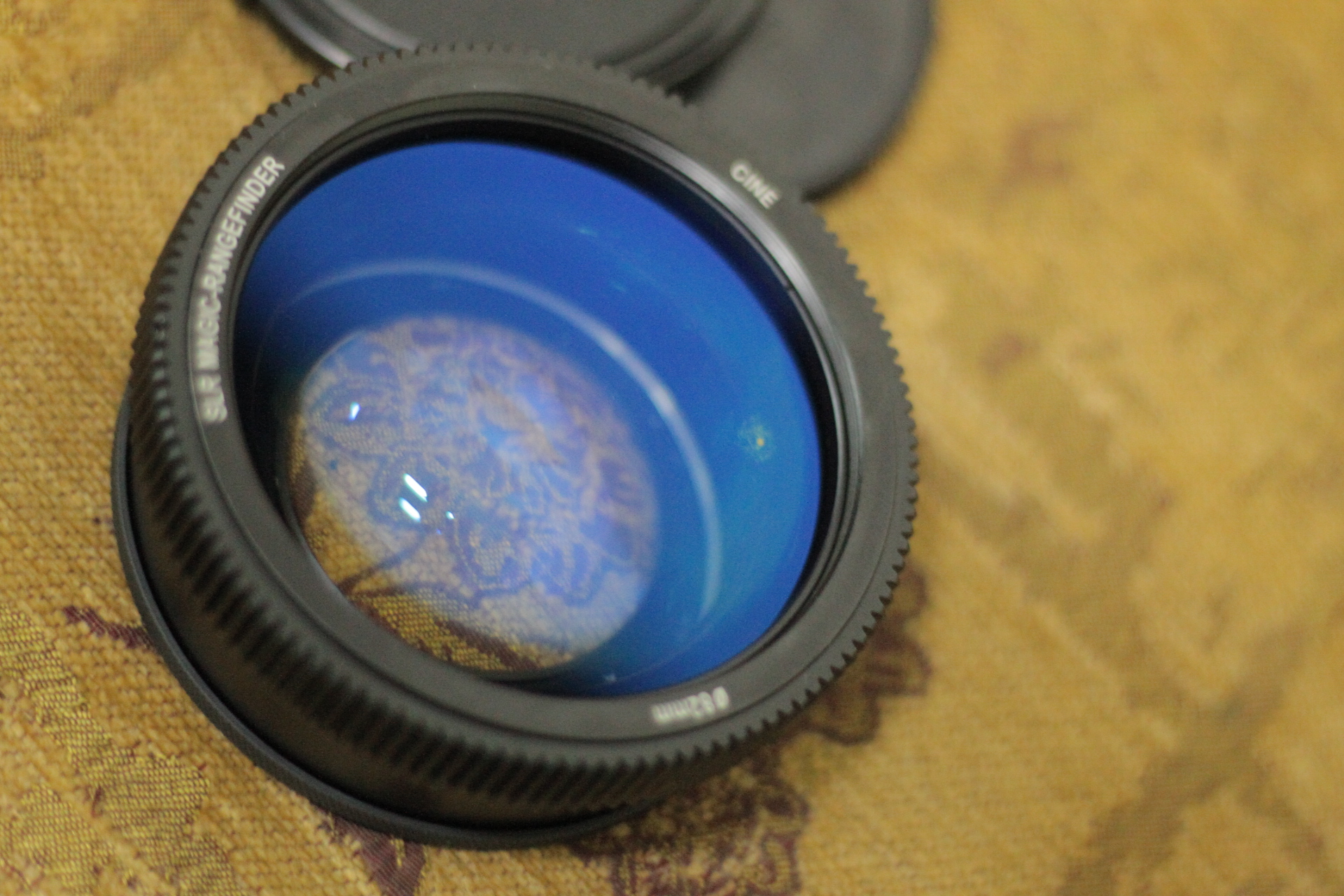

Guest Ebrahim Saadawi Posted August 2, 2015 Share Posted August 2, 2015 Just arrived today, and as soon as those step-up rings to attach it to all me glass arrive I'll begin testing. The one lens that I have with a 77mm thread, the ef 16-35mm 2.8, shows some initial findings:The rangefinder makes the lenses wider, by more than 2 mms at least, which does make a difference with a 16mm (positive or negative). The glass elements are huge and coated with a markedly blue coating material, giving the lens all blue flares that look pleasing to me, it seems intentional, as the colour matches anamorphic flare colour. I love the flares on it but not everyone.It's bigger and heavier and better build thank you think, it really screams pro cinema grade, the focus ring is exactly similar to the Canon CN-E lenses, but a bit more stiff than CP.2s. Link to comment Share on other sites More sharing options...
Guest Ebrahim Saadawi Posted August 2, 2015 Share Posted August 2, 2015 So I see is flares, lots and lots of flares subtle colour coldness. Intentionally searching for a spot where flare is over the topBefore AfterThis the most extreme situation keep that in mind. I actually like it but that not for everybody. (Also note on the antique TV, there's a markedly wider field of view with the Rangefinder) Link to comment Share on other sites More sharing options...
