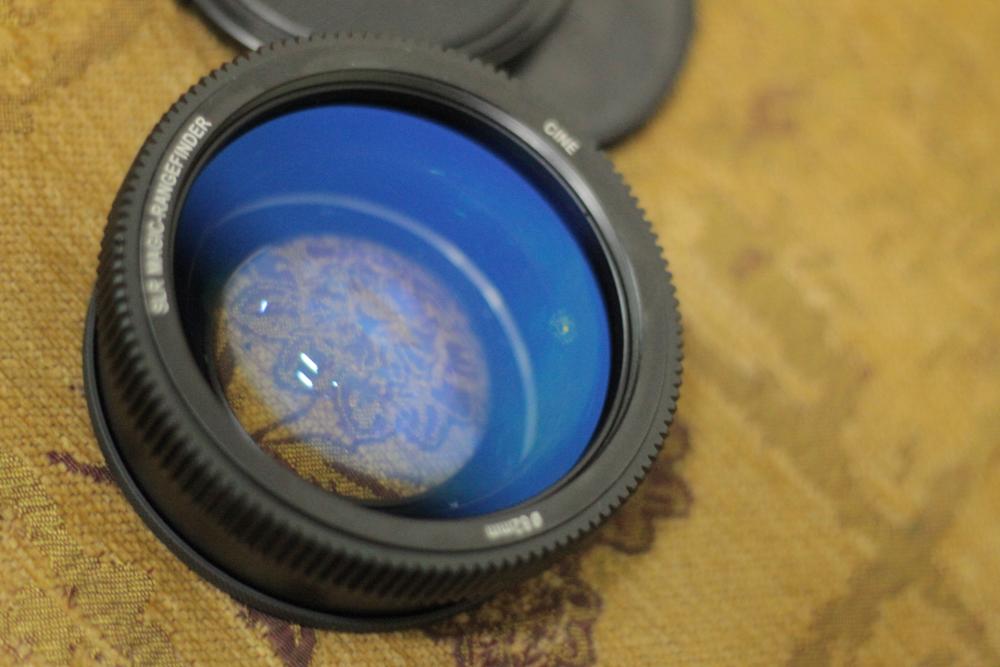

Guest Ebrahim Saadawi Posted August 8, 2015 Share Posted August 8, 2015 I was shooting with the RG today on my Nikon D7100 coupled with the 24-120mm F4 out on the streets, real world experience with it for the first time so I noticed something, The focus ring on the Rangefinder has inconsistent resistence throughout the focal range. Being loose-est at MFD and stiff-est at infinity. I took the rangefinder off and took it back in the lab to see if it was something I am just imagining but yes even when not attached to a lens and pointed 90° to the gravity center, the focus ring is loose from 3'6 to about 5'9 percisely where it becomes considerably stiffer, has more resistence, and it even becomes slighty loose-er/smoother again staring from about 8' to infinity, but still markedly more stiff than the MFD to 5'9 range.Overall whilst shooting it required marked muscle force variation from my part to keep it consistently focusing while following a subject. I then tried and handed it to one of my employees, a physician with no knowledge whatsoever of what a lens is, and I asked him to turn the focus ring and see if there's inconsisteny, he gave me the exact same numbers. I expect this is a intended design for some reason I am simply uninformed about?or the fact that simply the prototype model have been abused therefore gathering dust/grease before I recieved it?Or perhaps a design flaw caused by the changing in the focus ring position while focusing, being farthest from the mechanical body at MFD range. I would love to hear other testers thoughts on this (Andrew Reid, Zac, Sebastian, anyone) and whether this is something you see in your samples. Link to comment Share on other sites More sharing options...
Zak Forsman Posted August 9, 2015 Share Posted August 9, 2015 yes, the resistance is inconsistent, but only slightly so, on mine. but like the softness and the chromatic aberrations it introduces, these are the minor sacrifices you make for something that is half (and potentially one-quarter) the price of The Rectilux -- the optics of which are far superior and don't introduce any additional image degradation beyond what the taking lens and scope would have on their own. In fact, I was able to easily disassemble my Rectilux and grease it to a resistance level of my liking. I would have no hesitation recommending the Rangefinder to someone who is looking for a balance of price and "good enough". For that reason, they will likely sell a gazilion of them. But if price is not an issue and you want the best, get the Rectilux. Link to comment Share on other sites More sharing options...
nahua Posted August 9, 2015 Share Posted August 9, 2015 @Ebraham - Mine is fine. If yours is stiff then send it back to SLR Magic. This is a pre-production model and it will have problems. I had problems with my prototype 1.33x Anamorphot, sent it back and got a newer version no charge. So contact Andrew and let him know the problems. They always had excellent customer service. Link to comment Share on other sites More sharing options...
Guest Ebrahim Saadawi Posted August 9, 2015 Share Posted August 9, 2015 Thank you Zak and Nahua for the quick reply. Zak please report this to Andrew too, I did, lets see if there's more complaints from the testers. The resolution and CA minor changes are not bothering me even one bit, actually loving them in 4K, and flaring is gorgeous. I accept those. It's such an innovative product. But I am not sure customers will accept an inconsistent resistant cinema focus ring. SLR Magic smaller lenses focus rings are perfect, this needs to be fixed before production if it's not yet. Must be fixed. It's a cine grade focus ring, must be consistent and linear. It's a small inconsistency but enough to annoy me today while shooting, the good part is it smoothly gets stiffer, not abruptly at a point, so I was able to memorize and be able to adjust my palm muscle force according to the ring resistence to get smooth pulls. A buying customer will not be as tolerant as I am as just a prototype tester though. Link to comment Share on other sites More sharing options...

AaronChicago Posted September 23, 2016 Share Posted September 23, 2016 Bringing this thread back from the dead. I'm testing the Rangefinder this week with a Takumar 50mm and Singer 16D. One thing I noticed is that when comparing the RF on and off, it really distorts the background vertically, through the RF. It's not subtle either. When the rangefinder is off the image is pleasant and looks like typical anamorphic distortion, but when the RF is on it's like I stretched everything vertically. Is that just a characteristic of the RF? Link to comment Share on other sites More sharing options...
Justin Bacle Posted September 24, 2016 Share Posted September 24, 2016 On 9/23/2016 at 6:42 PM, AaronChicago said: Bringing this thread back from the dead. I'm testing the Rangefinder this week with a Takumar 50mm and Singer 16D. One thing I noticed is that when comparing the RF on and off, it really distorts the background vertically, through the RF. It's not subtle either. When the rangefinder is off the image is pleasant and looks like typical anamorphic distortion, but when the RF is on it's like I stretched everything vertically. Is that just a characteristic of the RF? can you share images, I'm not sure I can imagine how much disstortion you're talking about :s Link to comment Share on other sites More sharing options...
AaronChicago Posted September 25, 2016 Share Posted September 25, 2016 12 hours ago, Justin Bacle said: can you share images, I'm not sure I can imagine how much disstortion you're talking about :s Justin, I will upload a couple later today. I posted this question in the anamorphic section and got some good info. Any type of diopter, including variable, will add some stretch vertically. Justin Bacle 1 Link to comment Share on other sites More sharing options...
Flynn Posted September 25, 2016 Share Posted September 25, 2016 2 minutes ago, AaronChicago said: Justin, I will upload a couple later today. I posted this question in the anamorphic section and got some good info. Any type of diopter, including variable, will add some stretch vertically. Do you prefer the look without the Rangefinder? Link to comment Share on other sites More sharing options...
AaronChicago Posted September 25, 2016 Share Posted September 25, 2016 7 minutes ago, Flynn said: Do you prefer the look without the Rangefinder? I do. It seems more natural but with the normal anamorphic properties (barrel distortion, oval bokeh, flares). Flynn 1 Link to comment Share on other sites More sharing options...
Flynn Posted September 25, 2016 Share Posted September 25, 2016 2 hours ago, AaronChicago said: I do. It seems more natural but with the normal anamorphic properties (barrel distortion, oval bokeh, flares). Are you sure the Rectilux would give you the same distortion. Sounds like the Rangefinder is gonna drive you nuts, because you'll always know how much better your footage will look without it. Link to comment Share on other sites More sharing options...
tweak Posted September 25, 2016 Share Posted September 25, 2016 RF isn't worth it in my opinion, if you're spending decent cash to get a half-decent scope you might as well pay the bit extra and also get a core DNA. Buy once, cry once. SLR magic also have horrible looking coatings, I hope they fix these issues someday in the future as it's good for the market to have competition, right now though there's none, Rectilux is miles ahead. I mean what's the point getting one of these systems if every time you review the footage you wish you were shooting with it off... Link to comment Share on other sites More sharing options...
AaronChicago Posted September 25, 2016 Share Posted September 25, 2016 55 minutes ago, tweak said: RF isn't worth it in my opinion, if you're spending decent cash to get a half-decent scope you might as well pay the bit extra and also get a core DNA. Buy once, cry once. SLR magic also have horrible looking coatings, I hope they fix these issues someday in the future as it's good for the market to have competition, right now though there's none, Rectilux is miles ahead. I mean what's the point getting one of these systems if every time you review the footage you wish you were shooting with it off... Well if I knew the Rectilux was much better in this area I'd get it in an instant. I can still return the RF. I really wish I could shoot without it but I'm not great at all with dual focussing. If it's a stationary shot I'll definitely go bare. Link to comment Share on other sites More sharing options...
tweak Posted September 26, 2016 Share Posted September 26, 2016 9 hours ago, AaronChicago said: Well if I knew the Rectilux was much better in this area I'd get it in an instant. I can still return the RF. I really wish I could shoot without it but I'm not great at all with dual focussing. If it's a stationary shot I'll definitely go bare. Yeah I'd return it, if you can afford the CDNA there's no reason why you wouldn't get that. CDNA introduces almost zero extra artefacts to your image where as RF slaps it's ugly blue flares all over everything. Personally I can't stand the look of those flares, they aren't even the nice type of blue. I still use a lot of dual focus setups but I agree it's not that handy especially in run and gun or situations with not much time to prepare the shot, it's easy to think you're in focus when you're actually slightly off. I guess that all just becomes better with experience and understanding your scopes well. Still if I were doing paid shoots I would invest in a CDNA no questions. Link to comment Share on other sites More sharing options...
