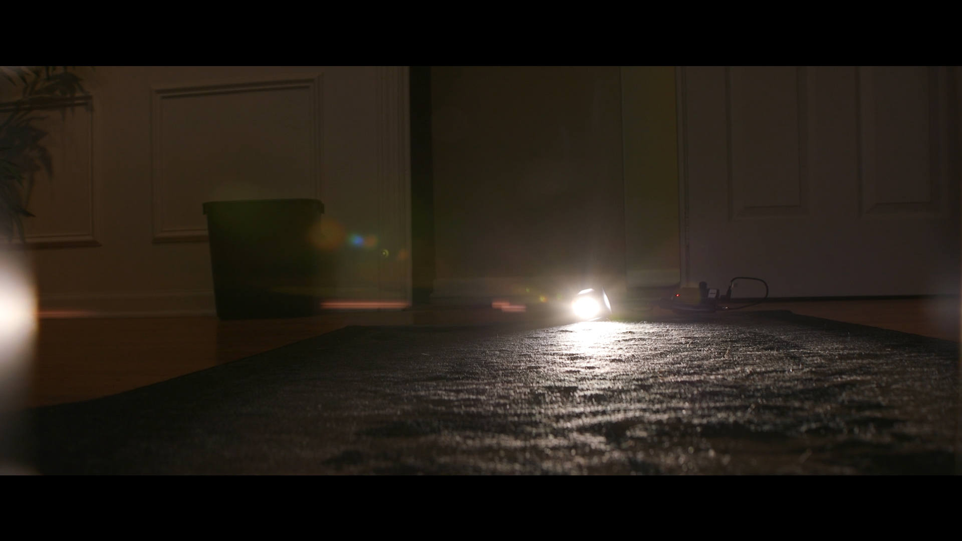

AaronChicago Posted August 5, 2015 Author Share Posted August 5, 2015 The stuff shot in broad daylight at deep f-stops looks goods, but the stuff shot in dimmer light looks questionable. Also, in the latter half of the video, you can see some clear examples of mumping. Looks like 1954-era CinemaScope.So I borrowed an Anamorphx to test. Most shots have flaring whites on the left/right. Any idea why? I'm such a noob when it comes to anamorphic. Link to comment Share on other sites More sharing options...

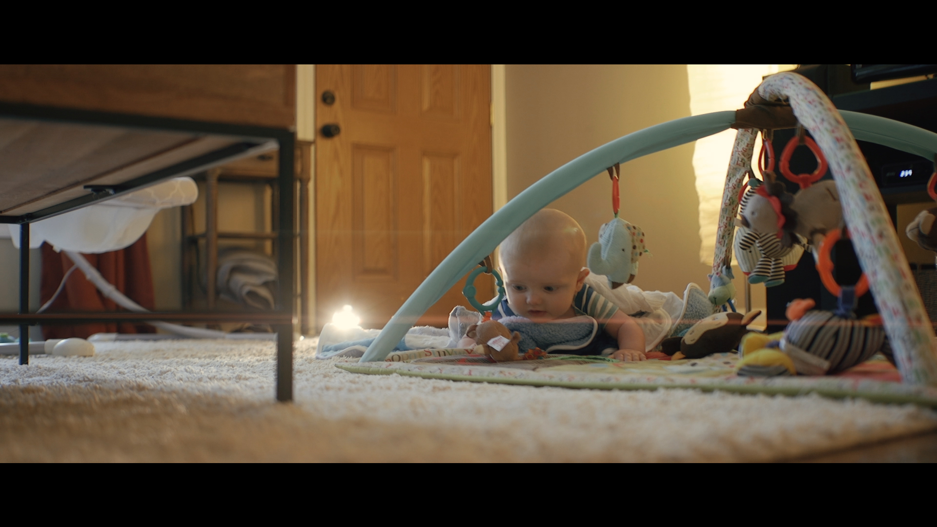

AaronChicago Posted August 5, 2015 Author Share Posted August 5, 2015 I think it was vignetting by hitting a piece of the glass. 28mm and above seems fine. This is at 35mm (of my little boy). Link to comment Share on other sites More sharing options...
BrooklynDan Posted August 6, 2015 Share Posted August 6, 2015 From what I understand, the AnamorphX came in several different versions, each with different grades and layers of coating in order to give users an option for how much fireworks they want in the frame. The type and amount of flaring you'll get is determined by which version you have at hand. That said, the Letus has a really big front element, so it shouldn't be hard for it to catch some stray light at almost any angle. AaronChicago 1 Link to comment Share on other sites More sharing options...
AaronChicago Posted August 7, 2015 Author Share Posted August 7, 2015 Did some more tests. I feel like this version is "low flare" but I'll double check. Link to comment Share on other sites More sharing options...
