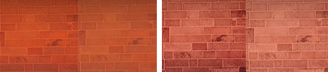

sudopera Posted August 4, 2015 Share Posted August 4, 2015 Don Kotlos 1 Link to comment Share on other sites More sharing options...
Don Kotlos Posted August 4, 2015 Share Posted August 4, 2015 Still too many words and not enough pictures on this thread!Take some 10bit ProRes and convert to a high quality 8bit codec at the same bitrate (around 250Mbit/s would be good)Then post screen shots of the image quality (hint - they will look identical) and also the grading issues you find (hint - you will never push it that far to breaking point in a real world grade)...LOG is more important to image quality & dynamic range than 10bit vs 8bit.The test should be grading a RAW still of a face and an 8 bit log frame. If someone has an A7s and willing to spend few minutes getting and posting the raw data here, it would be great so we can all try to match the two. Then after we all agree that is impossible to match the two we can move on to the 10 bit. Sudopera's test is great (thanks!) but a V-log would make the differences even larger especially when shooting fine tonalities such as in skin. So I hope he repeats the test when the V-Log gets released... I am attaching some crops from the video which I don't even have to identify. Differences are obvious. Link to comment Share on other sites More sharing options...
sudopera Posted August 4, 2015 Share Posted August 4, 2015 The test should be grading a RAW still of a face and an 8 bit log frame. If someone has an A7s and willing to spend few minutes getting and posting the raw data here, it would be great so we can all try to match the two. Then after we all agree that is impossible to match the two we can move on to the 10 bit. Sudopera's test is great (thanks!) but a V-log would make the differences even larger especially when shooting fine tonalities such as in skin. So I hope he repeats the test when the V-Log gets released... I am attaching some crops from the video which I don't even have to identify. Differences are obvious. Sorry, that is not my test it is just a video I saw a while a go. If the test was done properly, which I don't have any reason to believe otherwise, I think the difference is very clear.If I'm not mistaken, it was already posted on some topic here before, I believe some time around when Shogun came out. Link to comment Share on other sites More sharing options...
