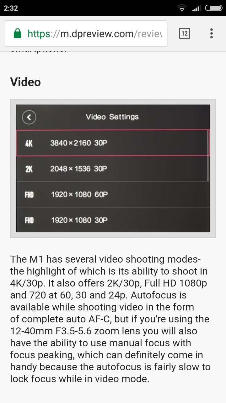

samuel.cabral Posted February 13, 2017 Share Posted February 13, 2017 The chinese m4/3 Yi M1 shoots a 4:3 2k image but at 30p. Link to comment Share on other sites More sharing options...

Justin Bacle Posted February 13, 2017 Share Posted February 13, 2017 On 2/13/2017 at 4:36 AM, samuel.cabral said: The chinese m4/3 Yi M1 shoots a 4:3 2k image but at 30p. Expand 2048*1536 is actually closer to 3K. Would stretch nicely to 4k anamorphic. The bitrate and IQ is not great however from the very few reviews I've seen. I'd like to be wrong on that though Link to comment Share on other sites More sharing options...
samuel.cabral Posted February 14, 2017 Share Posted February 14, 2017 On 2/13/2017 at 3:48 PM, Justin Bacle said: 2048*1536 is actually closer to 3K. Would stretch nicely to 4k anamorphic. The bitrate and IQ is not great however from the very few reviews I've seen. I'd like to be wrong on that though Expand Yeah... For sure. But you don't have a m4/3 camera with a Sony sensor, 4:3 aspect ratio, good 2k resolution, good colors for that price ($450 with kit lens). I think it could be a fun camera B (or even C!). And i still think a hack would be possible... Justin Bacle 1 Link to comment Share on other sites More sharing options...
