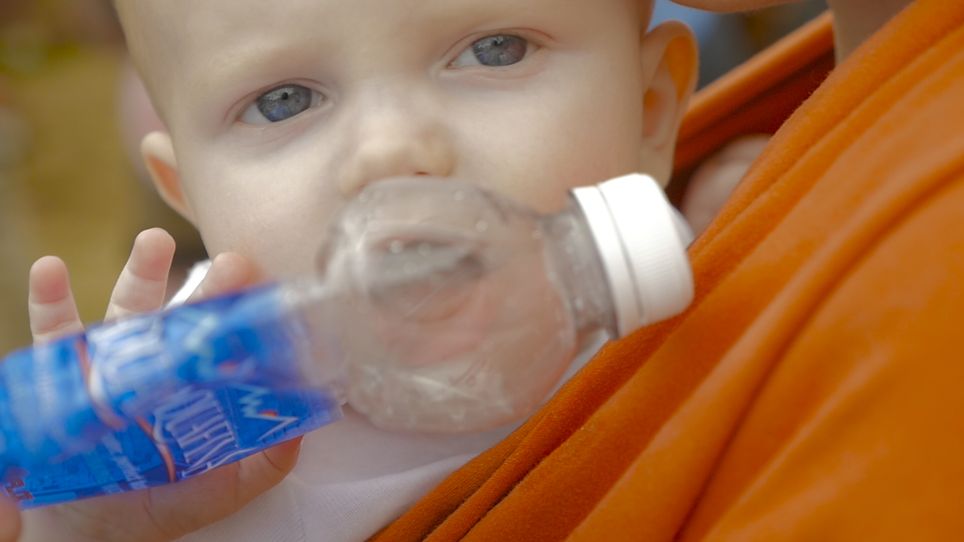

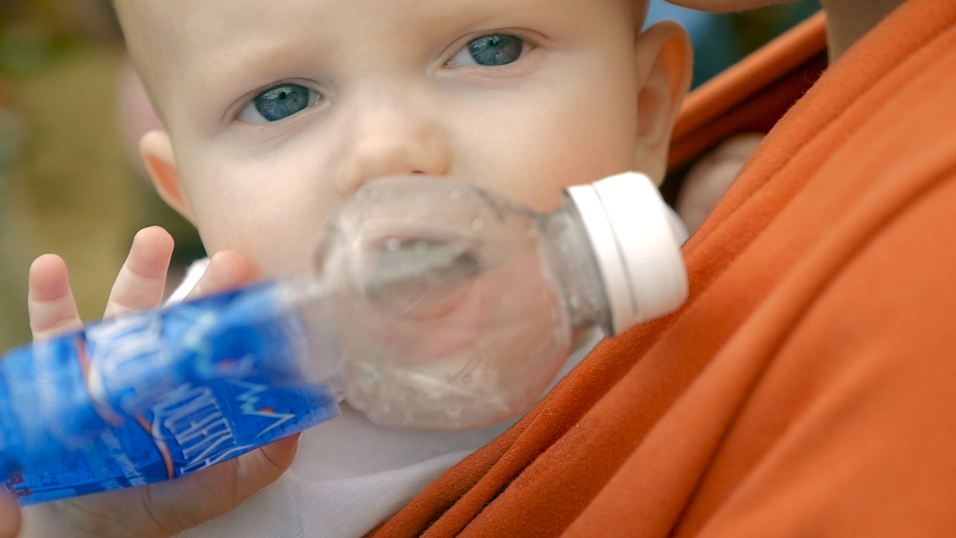

AaronChicago Posted August 9, 2015 Share Posted August 9, 2015 I took out my GH4 to a Ren Faire today testing out Portrait profile with 96fps HD. I've always used either Cine D, or Cine V, but wanted to try something different. So I shot everything with Portrait profile. After importing to Premiere CC I added Arri Alexa SL profile LUT. The colors looked really nice. I then tried just added some contrast to the original image and comparing the 2. Have a look and tell me that the Alexa LUT doesn't produce cleaner colors? Honestly do need opinions.First is Alexa LUT. Second is Contrast only. dahlfors, kaylee and Fredrik Lyhne 3 Link to comment Share on other sites More sharing options...

MattH Posted August 9, 2015 Share Posted August 9, 2015 In this frame I prefer the Alexa lut colors. Easily. That was my instant impression, and still is after close inspection. Which comes closer to your recollection of how things actually looked? Does it seem to produce better colors consistently? Link to comment Share on other sites More sharing options...
AaronChicago Posted August 9, 2015 Author Share Posted August 9, 2015 In this frame I prefer the Alexa lut colors. Easily. That was my instant impression, and still is after close inspection. Which comes closer to your recollection of how things actually looked? Does it seem to produce better colors consistently?Yes the alexa colors are near perfect from what i remember. The Portrait colors could use more magenta, but even then it doesn't look nearly as natural. Link to comment Share on other sites More sharing options...

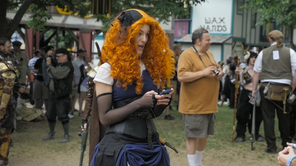

Inazuma Posted August 9, 2015 Share Posted August 9, 2015 I would not recommend Natural mode because it turns more red things into orange. And if what Zak says about Portrait being the same as natural but with just a different level of saturation is true then I wouldn't recommend that either. Stick to Standard for the most realistic colours Link to comment Share on other sites More sharing options...
Zak Forsman Posted August 9, 2015 Share Posted August 9, 2015 I'll definitely give Standard another day in court because it's been a long time since i did my tests of each profile, but I haven't had any issues keeping reds red in Natural. And I found it produced the best skintones. TheRenaissanceMan 1 Link to comment Share on other sites More sharing options...
AaronChicago Posted August 9, 2015 Author Share Posted August 9, 2015 sure. zakforsman AT gmail DOT comThanks I sent you an email.I would not recommend Natural mode because it turns more red things into orange. And if what Zak says about Portrait being the same as natural but with just a different level of saturation is true then I wouldn't recommend that either. Stick to Standard for the most realistic coloursThis is pretty much what I encountered. As you'll see the person's hair is way more orange/yellow than red in the "Portrait" clip. Of course I could do some color tweaks to fix it but I was happy to see that simply applying the Alexa S profile brought out very realistic colors.Another frame grab. First one is Alexa SL profile. Second is Portrait with Contrast and slight saturation boost. Link to comment Share on other sites More sharing options...

MattH Posted August 9, 2015 Share Posted August 9, 2015 In the second example the alexa lut again looks better. In the second one, the baby looks like a ghoul from 'I am legend'. Its a shame that the bottle top is blown out. Was it like that before any adjustment? Link to comment Share on other sites More sharing options...
Administrators Andrew Reid Posted August 9, 2015 Administrators Share Posted August 9, 2015 I'd rather have a blown out bottle top than a grey fog and terrible colour! Link to comment Share on other sites More sharing options...

Zak Forsman Posted August 9, 2015 Share Posted August 9, 2015 okay, here is the LUT I made for clips that I shoot in the GH4's Natural profile, applied to the "Portrait" camera original that Aaron sent me this morning. From here I would normally continue to tweak based on the needs of the scene or shot. But this gets me closer to the look I like by cooling things off a bit, especially the shadows, pulling the yellow out of the skin and balancing the skintones, and making the highlights a little creamier than straight white. this isn't meant to challenge the look of the Alexa LUT that Aaron used earlier. it's just an ever-evolving starting point. I see things in it I would nudge here and there already.EDIT: took some of the intensity of the blue in her outfit away. AaronChicago 1 Link to comment Share on other sites More sharing options...

AaronChicago Posted August 9, 2015 Author Share Posted August 9, 2015 okay, here is the LUT I made for clips that I shoot in the GH4's Natural profile, applied to the "Portrait" camera original that Aaron sent me this morning. From here I would normally continue to tweak based on the needs of the scene or shot. But this gets me closer to the look I like by cooling things off a bit, especially the shadows, pulling the yellow out of the skin and balancing the skintones, and making the highlights a little creamier than straight white. this isn't meant to challenge the look of the Alexa LUT that Aaron used earlier. it's just an ever-evolving starting point. I see things in it I would nudge here and there already.EDIT: took some of the intensity of the blue in her outfit away. thanks for doing that. I'm outside today and it's hard to judge colors in the sun on my iphone but will definitely check it later. Link to comment Share on other sites More sharing options...
