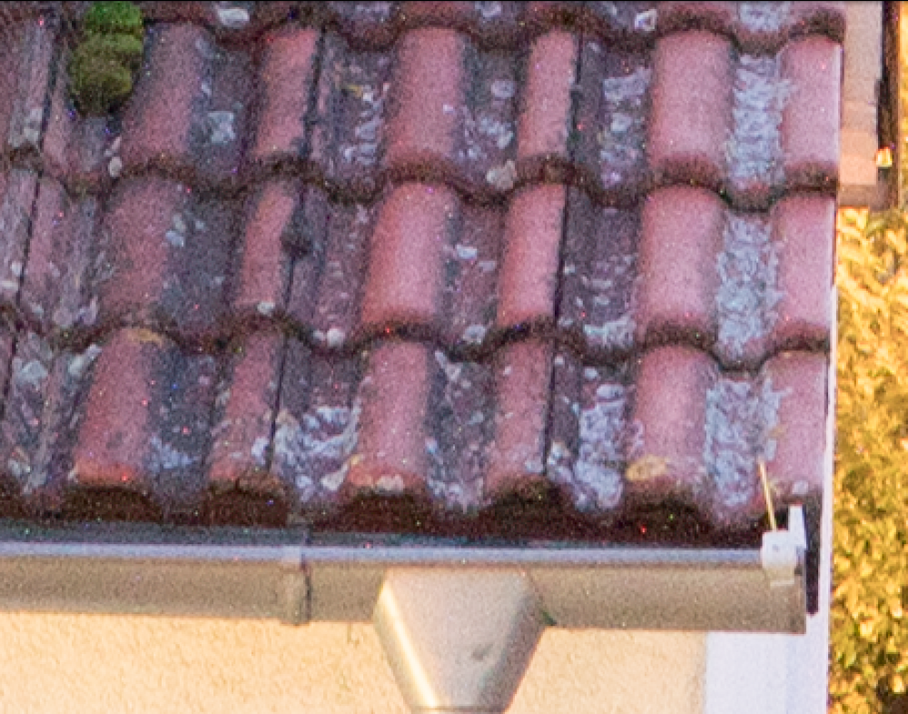

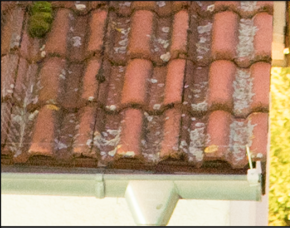

m~Daniel Posted September 21, 2015 Share Posted September 21, 2015 Hot pixel issue has been fixed in Firmware 1.1 - see my comparison pictures between 1.0 and 1.1Light is very different because the firmware update took like 30mins or so and it went completely dark by that time. So Version 1.0 had more light and F6.3... with firmware 1.1 I set it to F3.5 just because it was much darker. ISO was set to 100 and I pushed the image +5 stops in lightroom.If anyone wants the RAW files... I can upload them. Orangenz and Don Kotlos 2 Link to comment Share on other sites More sharing options...
Don Kotlos Posted September 21, 2015 Share Posted September 21, 2015 Thanks for the test. The 1.1 is the top right? Can you check whether the S35 cam be assigned to a button now?That's the only reason I dive into the menu... Link to comment Share on other sites More sharing options...

m~Daniel Posted September 21, 2015 Share Posted September 21, 2015 Yeah 1.1 is the top one. Unfortunately still no S35/FF Toggle as a custom key Link to comment Share on other sites More sharing options...
