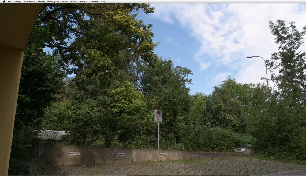

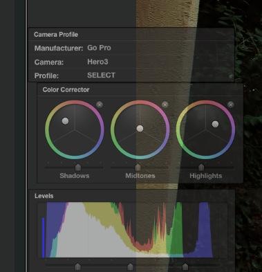

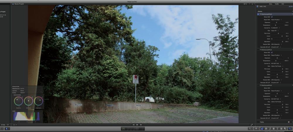

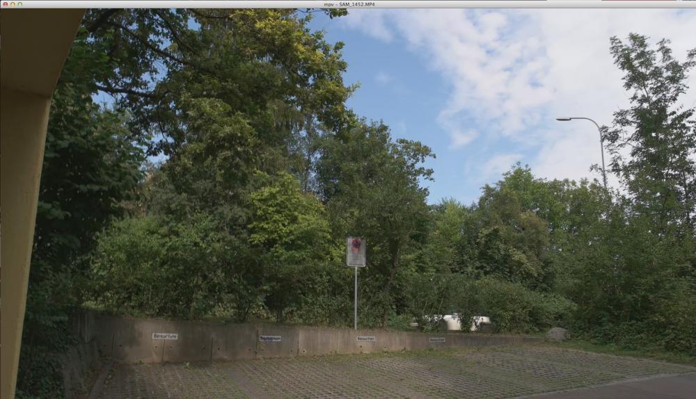

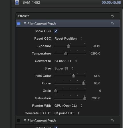

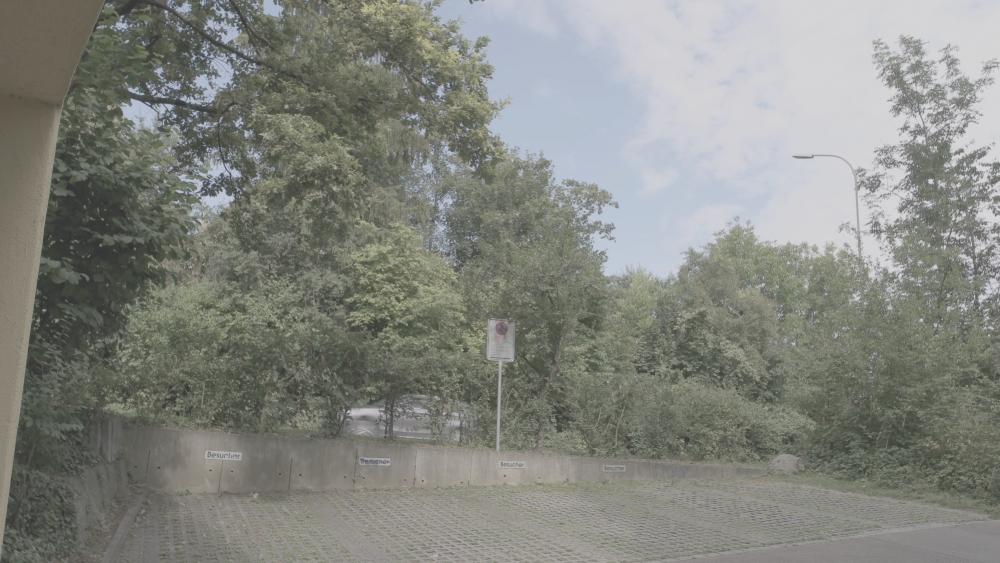

Werner H. Graf Posted August 19, 2015 Share Posted August 19, 2015 Dont know what occ is? Out of camera I used the Camer Settings Instructions from Andrew's PDFEdit ready H.265 to ProRes LT with the NX 1 cube file. I use the LG 31MU37 UHD in calibrated Adobe Colorspace, maybe this is the good greens coming from?But the FCP X Window has not the same color's contrast after exporting it to VLC and QuicktimeGrading settings here:absolutly not the same colors as exported to VLC! after export in VLC ADOBE Link to comment Share on other sites More sharing options...

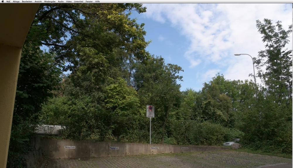

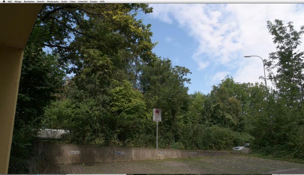

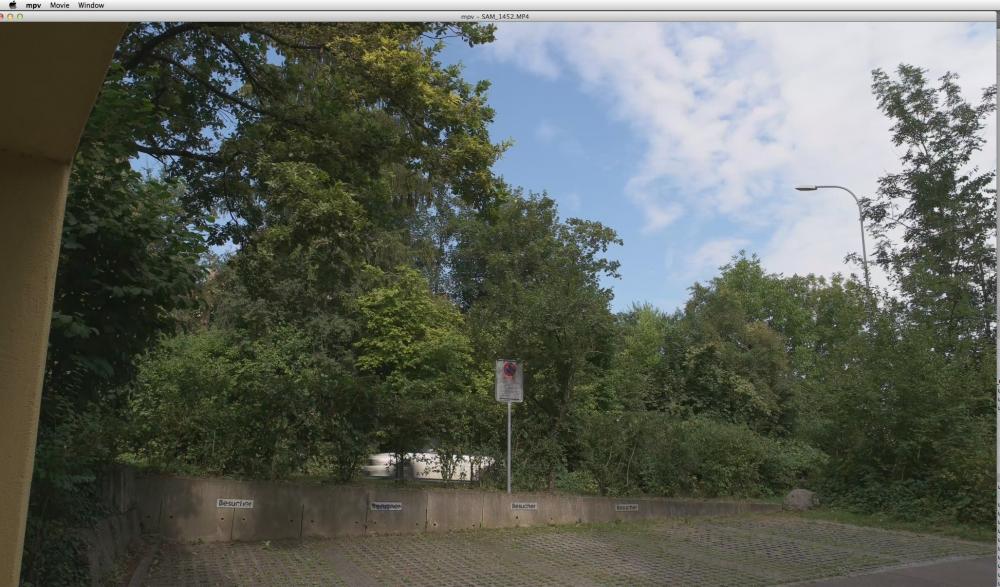

Werner H. Graf Posted August 19, 2015 Share Posted August 19, 2015 Her different Settings for Screenhots from the same camera file LG Monitor Settings changedIt's not the same colors!MPV w. AdobeVLC w. AdobeVLC sRGBVLC DC SIMULATIONVLC DCI-P3 Simulation Link to comment Share on other sites More sharing options...
