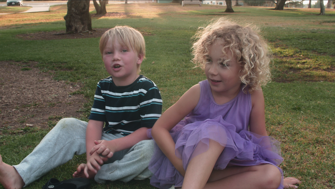

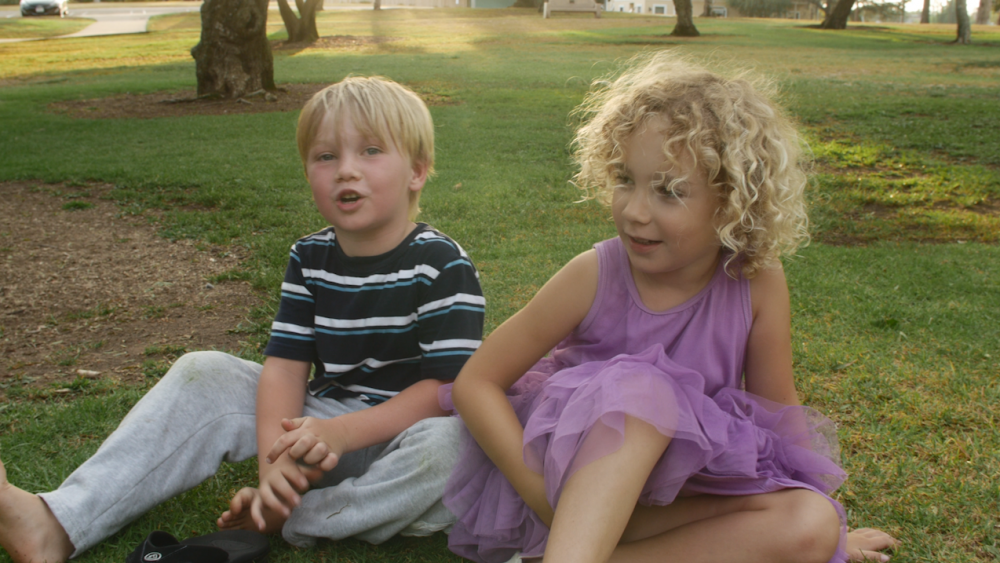

graphicnatured Posted August 18, 2015 Share Posted August 18, 2015 This is untouched aside from adding the LOG convert and 1D-C LUT and is using the EOSHD cineV profile. I used the camera's cloudy WB as there were a lot of overhead clouds, but then the sun poked through the trees here. I'd expect it to be warm and the magenta is much better, but I'm still seeing it. Any thoughts? I don't have a 1D-C so not sure if this is expected of the look. I've also attached the original with lots of green cast from the grass, but it is much brighter. Link to comment Share on other sites More sharing options...
