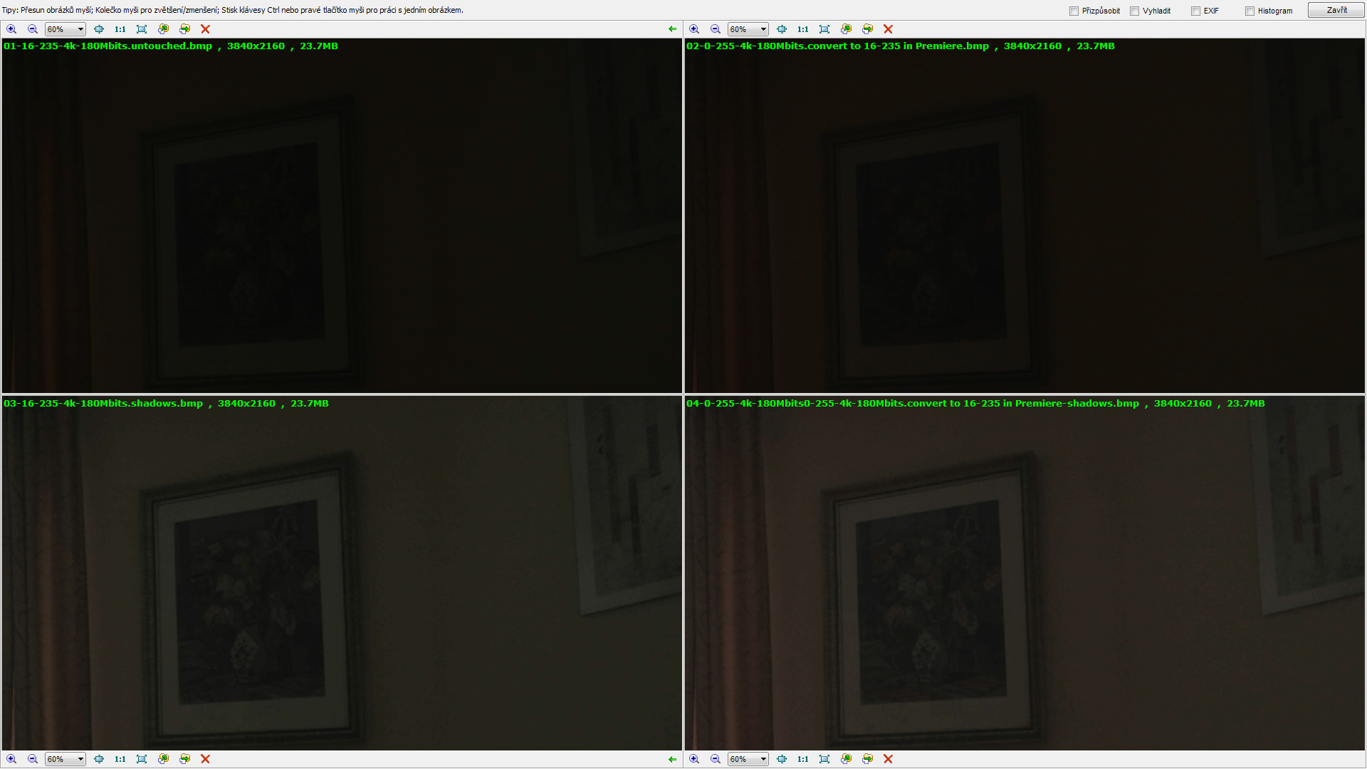

Pavel Mašek Posted April 11, 2016 Share Posted April 11, 2016 Below is comparsion of 16-235 and 0-255 (converted in Premiere to 16-235 according video above) + same images with lifted shadows in Lumetri. Both same exposure, WB, Standard profile, 180Mbit bitrate, ISO 320 I think that converted 0-255 looks better, it has at least more accurate colours (wall is more orange in reality) in shadows, otherwise it looks same in to me (even in video) Don Kotlos 1 Link to comment Share on other sites More sharing options...
