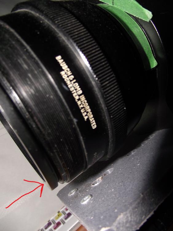

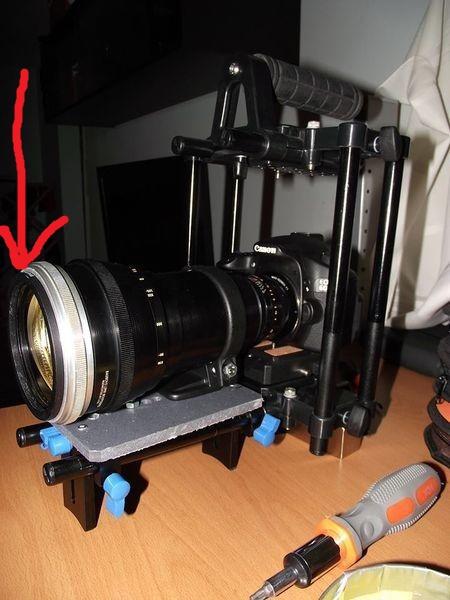

enny Posted August 26, 2015 Share Posted August 26, 2015 1 ebay, local camera shoops creglist.2 was wondering my self but i attached my to the front just to be sure3 i super glued industrial one not that wall mart crap to the front of the lens 95 to 80 step down ring and just Screw 80mm filters to it. some examples of it Art V. 1 Link to comment Share on other sites More sharing options...
Bear Hanrahan Posted August 27, 2015 Author Share Posted August 27, 2015 Good idea to glue adapter right on the lens! I never would have thought of that.Do you have a link where I might find the ring? Link to comment Share on other sites More sharing options...
ken Posted August 27, 2015 Share Posted August 27, 2015 Good idea to glue adapter right on the lens! I never would have thought of that.Do you have a link where I might find the ring?All rings are available from eBay, step up or down one should work. The glue is better to use hot melt glue, getting it with the gun from digikey. That way you can easily remove it. Link to comment Share on other sites More sharing options...
