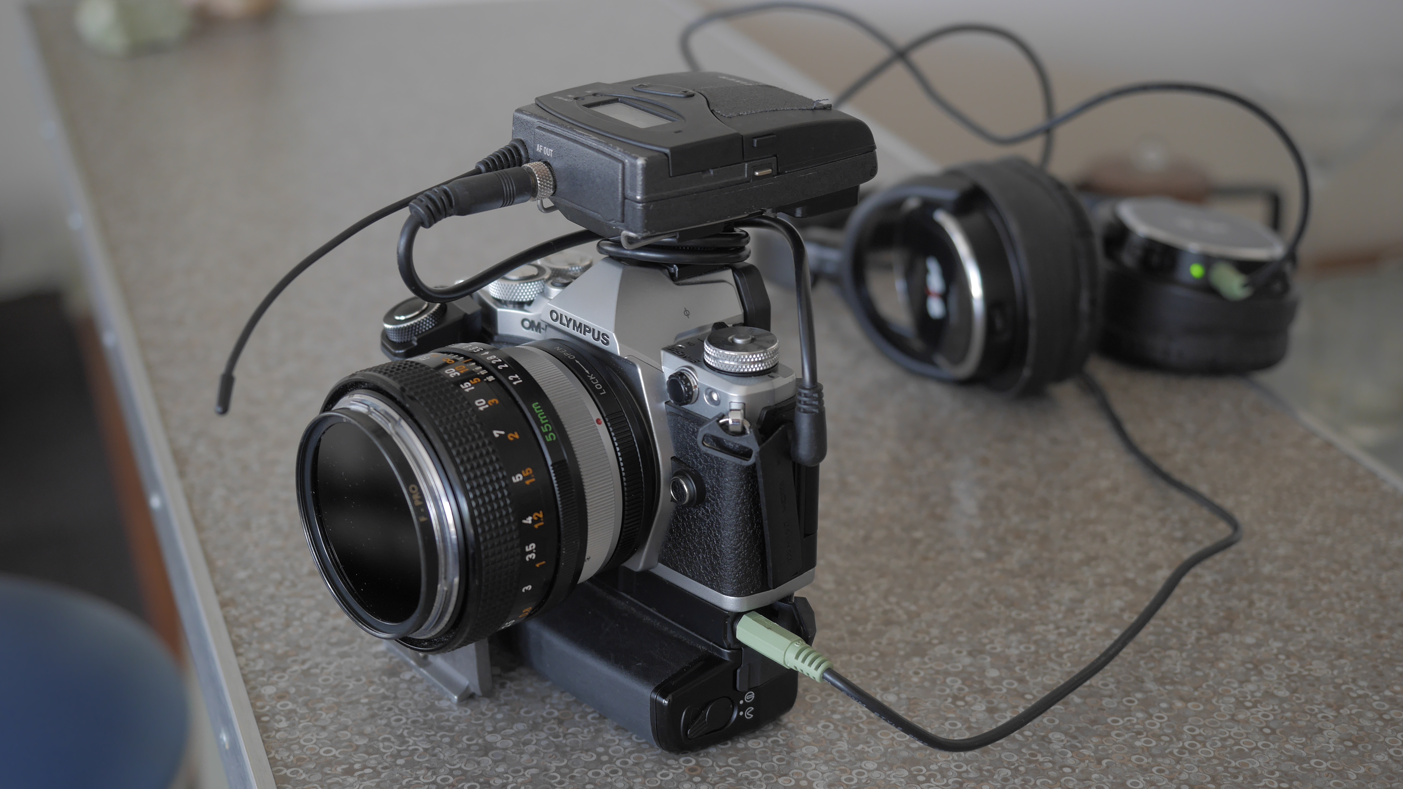

fuzzynormal Posted August 30, 2015 Share Posted August 30, 2015 I don't know what the EM-5 II's battery life is like in video mode, but it could actually be a nice documentary cam.FWIW, I record audio directly to the EM5II camera using a Sennheiser wireless Ew100 system. The preamps built into the camera are on par with a Zoom H1, I think. Not great, but very useable if you take care. Send a strong audio signal into the camera and it'll stay clean(ish). You can knock down the floor and make it work. If you want things to be REALLY quiet, you'd record on something different than a Zoom or an EM5II anyway, but I've been doing doc work following a comedian around as he does shows. Lots of ambient noise so you never hear the preamp hiss.That last EM5II video I posted on this site in a different thread was shot using the internal audio recorder of the camera for the interview, check it out for a listen if you want. You can tell it's good, not great. Here's something else, combined with the HLD-8G Hand Grip with Headphone Jack and HLD-6P Battery Holder, you get "power on" battery hot-swap --as well as audio monitoring with headphones. My 3rd party bats have been giving me at least 2 hours shooting with video and the fast battery change without power interruption is nice.Seems to me that the EM5II is a under-rated video camera since the IQ is slightly behind the curve. Everyone got all bothered when the camera was released because the image had limitations and isn't the best IQ on the market. Big deal. You work within the limitations and go do stuff, IMHO.IQ is most definitely not the only thing you need to consider when doing docs. Getting what unfolds in front of the lens and getting it well is paramount. The 5-axis helps in this regard. Shooting simple and easy to keep everything under control matters. So, small and efficient combined with 5-axis stabilization that allows for useful handheld shots? Not bad and worth consideration.I don't know exactly what you have planned, but I find unassuming gear works best for following people around in public during a documentary. It's not intimidating. Most people don't even realize you're shooting video. You just look like a weird photographer hanging out with someone. I'm using the EM5II to finish out a documentary shoot this summer and it's working for me.As for the codec, I don't shy away from 8-bit on my doc-film work. My last doc was shot on a Panasonic GM1and looks great as far as I'm concerned.Another note: The handgrip makes holding the camera feel really solid and reassuring. Combined with older metal FD lenses with some serious mass, the set-up has a comfortable hefty feel that actually allows for better shooting, I think. It's small but dense, which I like.Finally, the moiré that's prevalent on the EM5II with modern lenses is almost nonexistent with older glass and a speed booster. You could buy a full set of FAST cheap prime lenses for the cost of a brand new lens and significantly reduce one of the shortcomings of the camera. Not a bad deal.I'm not proselytizing for the EM5II per se, just saying it can work for you if you want it to. All the other suggestions here are legit too. TheRenaissanceMan and Flynn 2 Link to comment Share on other sites More sharing options...
