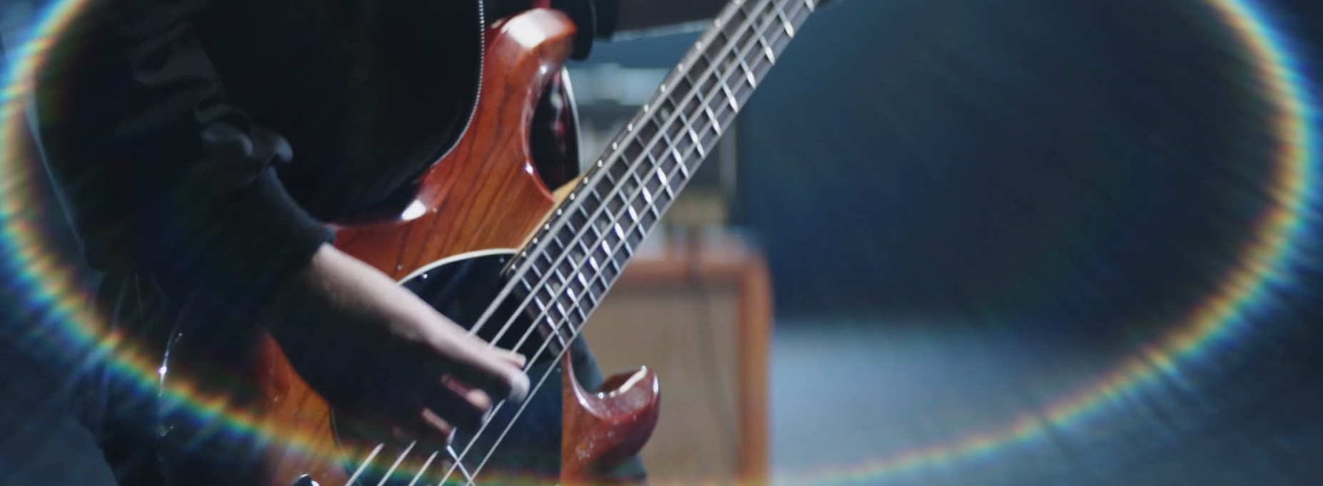

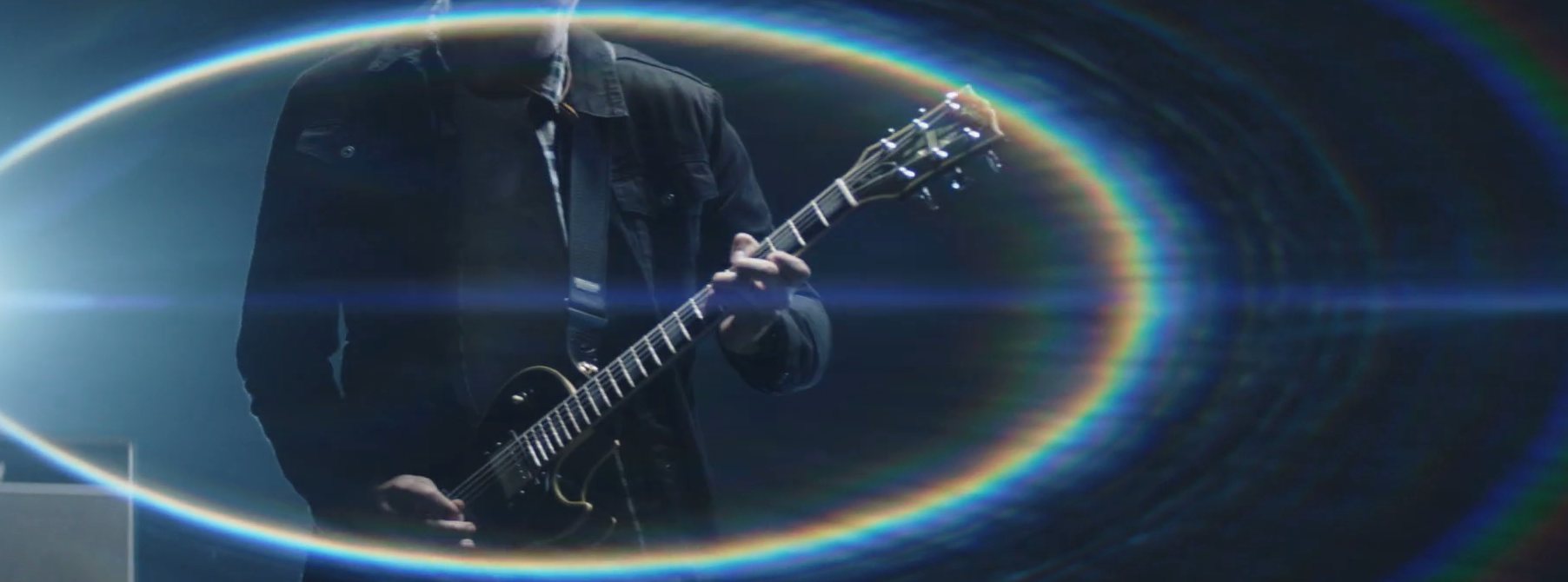

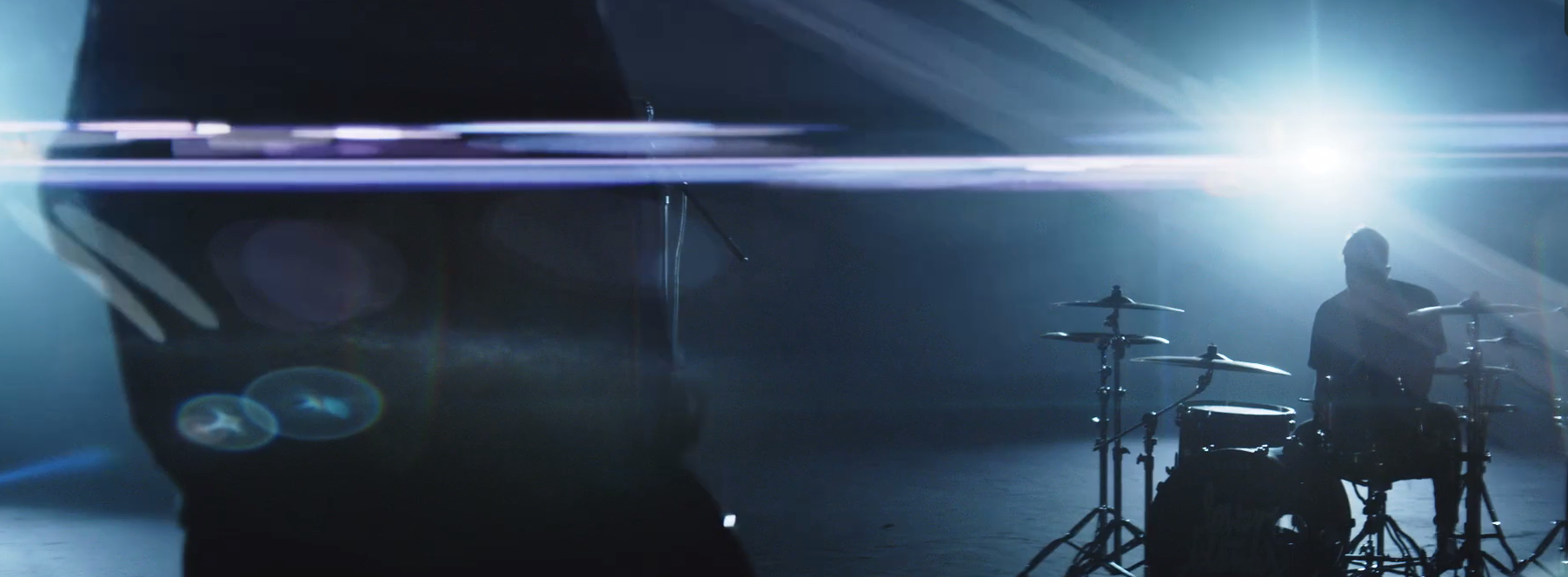

Oliver Daniel Posted September 1, 2015 Share Posted September 1, 2015 I've never shot anamorphic, it's always been on my to-do list and the time has finally come. A client has specifically asked for "in-camera anamorphic lens flares like J.J Abrams", and they are very adamant they want this as the main visual feature, with a load of spotlights and LED striplights flashing and creating a sci-fi, distorted, visceral look. (the genre of music is dubstep mixed with metal!)I don't have much time to sort this out (little over a week!), so I'm looking for advice regarding an anamorphic solution that "just works", as I don't want to risk a cumbersome fiddly DIY solution on this job. It's not so much the aesthetic you get from the squeeze, it's more the streaky organic flares that's required (although I do love a bit of squeezy vibes!). The camera is likely going to be the FS7 as high frame rates were agreed in the treatment. I've attached screen shots of the aesthetic I'm looking at. Any advice is much appreciated. Link to comment Share on other sites More sharing options...
Rudolf Posted September 1, 2015 Share Posted September 1, 2015 I would shoot spherical and apply all that flares in AE. You can achive this look much easier with videocopilot stuff or similar... And if it has to be anamorphic - maybe the adapter from SLR magic is the one to go with as it produces blue flares and looks modern/"artificial" or clinic and is just easy to use I think. richg101 and Oliver Daniel 2 Link to comment Share on other sites More sharing options...
richg101 Posted September 1, 2015 Share Posted September 1, 2015 Unfortunately I think you might do well to look at high quality flare overlays rather than risk shooting anamorphic last minute. Unless you can budget for a nice and clean 35mm lomo squarefront and the required rigging. There are not really any offerings apart from the SLR magic that flare similarly. On the flip side, and i don;t like plugging dso here personally, but I would actually suggest a trump58 and trump38 in combination with a speed booster. a few nifty oval apertures, with the intention of overlaying the horizontal flares in post.password= trump Being in the UK, I could rent you a TRUMP body and attachments for a few days... Oliver Daniel and Zak Forsman 2 Link to comment Share on other sites More sharing options...

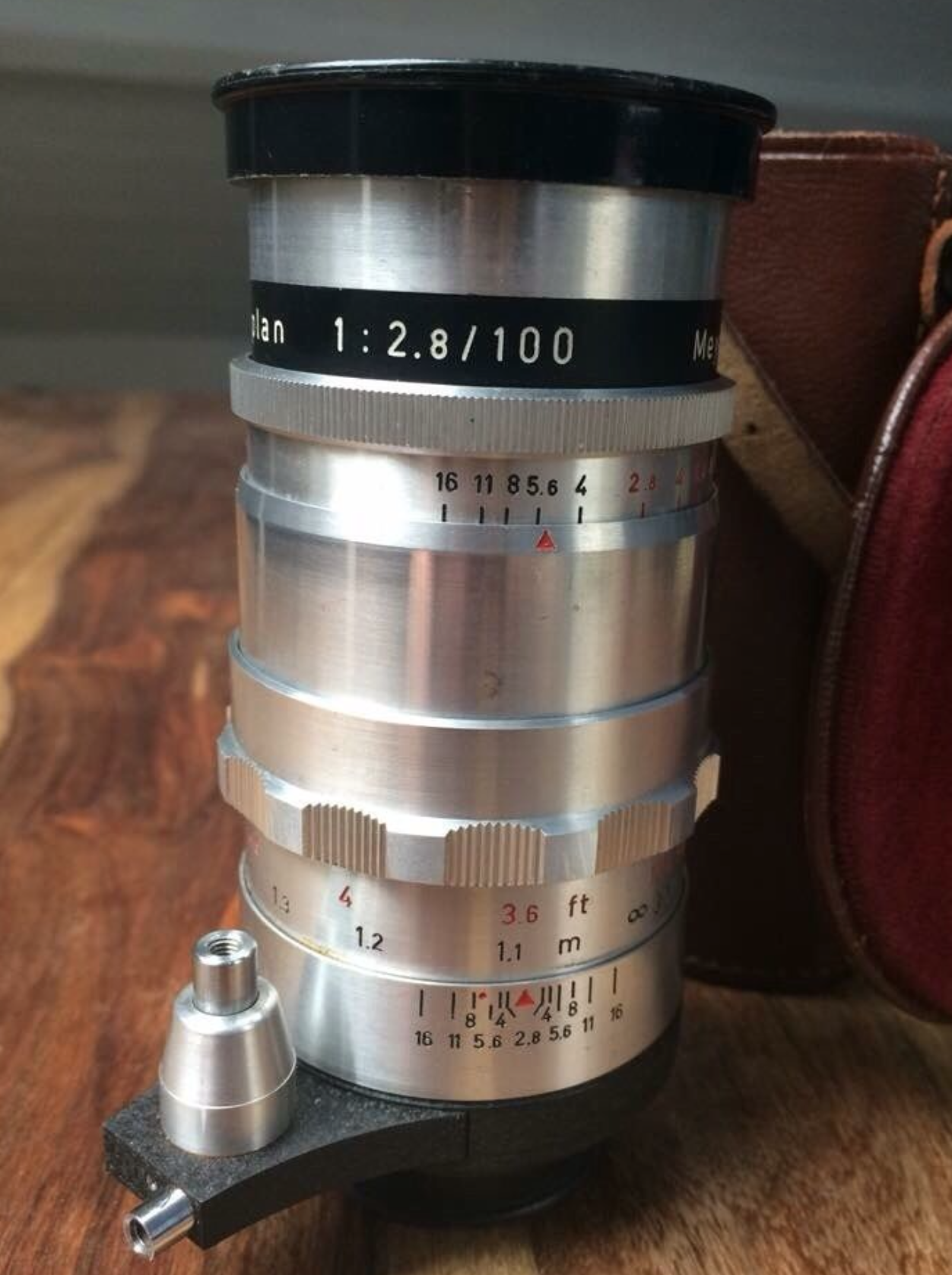

Bioskop.Inc Posted September 1, 2015 Share Posted September 1, 2015 Thanks for that!With the anamorphic, I'm doing the effects in post. I'm curious to use it properly the very near future though.Wow - that Helios is crazy. I have to get one of those. The bokeh is amazing. Also, the Meyer Optik looks beautiful. Is the attached screenshot the correct lens? (p.s what on earth is that weird thing sticking out the bottom?)Sensible to do it in post, especially considering your timescale - but give anamorphic a go at some point, as it really does have a different look (its not all flares).Yep, the Helios really does produce the most unusual/amazing bokeh - the Trioplan is the only one that comes close to trumping it.Meyer-Optik lenses are small gems & well worth having a look at - very similar to vintage Zeiss & i think that i prefer them (colour, contrast & bokeh).Yes correct lens & that's an Exakta Mount - avoid like the plague. Also comes in M42 mount, which you can buy an adaptor for most other mounts (think Nikon is a problem).There's a wealth of vintage lenses out there that a lot of people ignore, but are fantastic. It just seems most people want sterile sharp multi-coated modern lenses. The link below is an aladin's cave of vintage lenses - lots of pictures & the forum members are really helpful/nice (I think there's a 20/30 page thread on the different versions of the Helios 44 alone!)http://forum.mflenses.com/ Link to comment Share on other sites More sharing options...
Oliver Daniel Posted September 2, 2015 Author Share Posted September 2, 2015 Sensible to do it in post, especially considering your timescale - but give anamorphic a go at some point, as it really does have a different look (its not all flares).Yep, the Helios really does produce the most unusual/amazing bokeh - the Trioplan is the only one that comes close to trumping it.Meyer-Optik lenses are small gems & well worth having a look at - very similar to vintage Zeiss & i think that i prefer them (colour, contrast & bokeh).Yes correct lens & that's an Exakta Mount - avoid like the plague. Also comes in M42 mount, which you can buy an adaptor for most other mounts (think Nikon is a problem).There's a wealth of vintage lenses out there that a lot of people ignore, but are fantastic. It just seems most people want sterile sharp multi-coated modern lenses. The link below is an aladin's cave of vintage lenses - lots of pictures & the forum members are really helpful/nice (I think there's a 20/30 page thread on the different versions of the Helios 44 alone!)http://forum.mflenses.com/Cheers for all the info. Never heard of Exakta Mount, but I'll make sure to avoid it certainly. Guess it's not adaptable? i've been looking at Helios... and even though I have a 44-2 version of the 58mm, what's the difference between the models? Does the lens have a specific honeymoon period? Also wit the 40-2 85mm, seems like it's only the "new"version available on eBay, do these differ from the earlier version in any way? (I'm finding a lot of conflicting information online with Helios). I'm not to happy with my Helios and Mir 1B. The focus ring on the Helios is very tough, and the Mir-1B aperture ring feels too loose. I'm happy to look at other versions/models of the lenses so I can get them without these niggles. Generally I'm re-building the Russian set at all focal lengths with unique character in mind. It's quite brain blitzing knowing HOW to look. Link to comment Share on other sites More sharing options...
