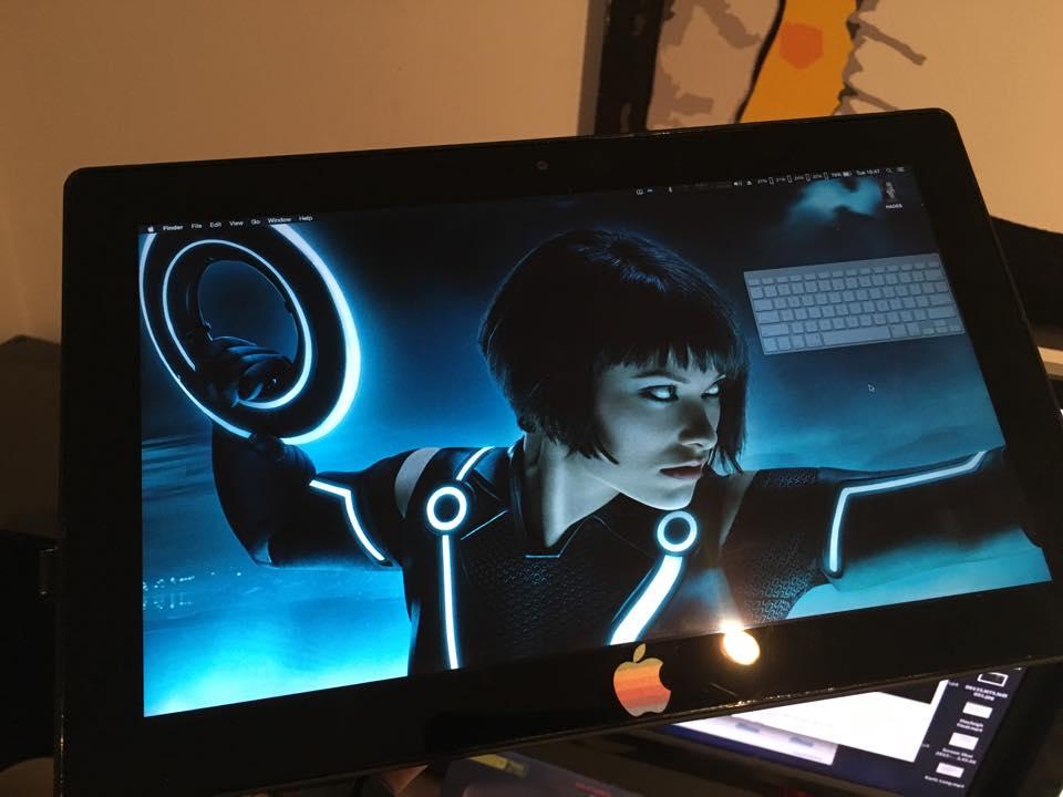

Calum MacPhail Posted November 2, 2015 Share Posted November 2, 2015 On 10/31/2015 at 5:39 PM, Andrew Reid said: I used to have one but it never felt 100% reliable.I would agree with you, to go down the hackintosh path you definitely need to be up for tinkering to run one on the regular. I've got various different systems, my main rig, which I find myself using more than my Mac Pro these days, works brilliantly and I've taken it with me multiple times to show projects to clients, without fear of it kicking up any problems.Picking the right parts is by far the best step you can make, its hard to go wrong with Gigabyte motherboards for example. Theres almost always kinks in the beginning as you say and again I totally agree with you on the usb soundcard point.I would say that for anyone that wants a powerful mac without the worry of Hackintoshing, for a reasonable price, look at the 2009 mac pro with two CPU sockets. With a firmware upgrade you can transform it into the 2010 model, allowing for faster ram and the ability to replace the dual quad cores, with dual six cores that still have significant wallop. In the end, Hackintoshing can transition into a slightly weird but enjoyable hobby. As I mentioned above, I hackintoshed a Surface Pro (that i picked up for 120 quid as it had a cracked screen), after fixing the screen, I now have a 1080p, i5 tablet with 128gb of storage, a usb3 port and a bloody fast card reader that is great for backing up and reviewing footage in the field. Kicks the shit out of the 11 inch air screen. kaylee 1 Link to comment Share on other sites More sharing options...
Administrators Andrew Reid Posted November 2, 2015 Administrators Share Posted November 2, 2015 Nice idea for the Surface Pro!! Link to comment Share on other sites More sharing options...
