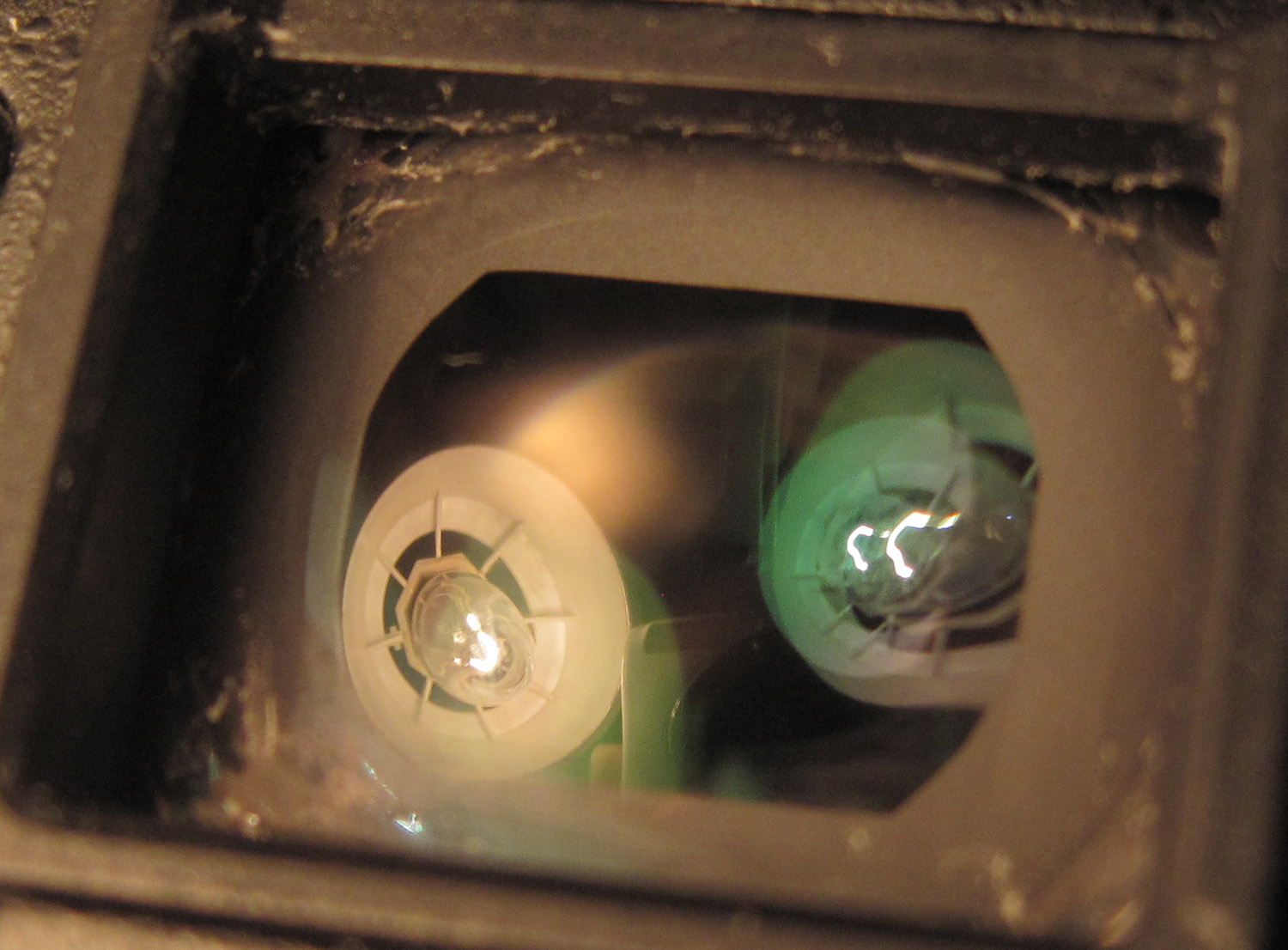

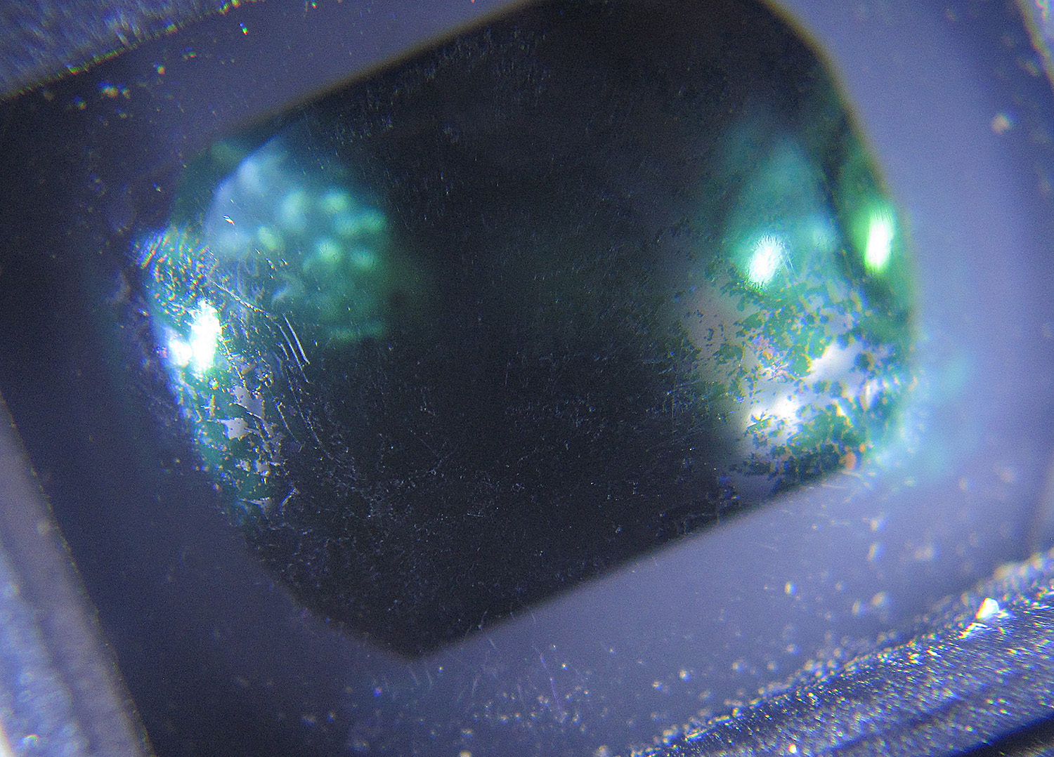

darrellcraig Posted September 16, 2015 Share Posted September 16, 2015 I just had the same problem with scratches/abrasions on my GH4 EVF and found a much cheaper solution that worked.I got a quote of $300-something from both Panasonic and local repair facility as it is all one integrated unit apparently.I was motivated to research a bit and found that the GH3/4 cover glass is plastic - which is common to some other cameras both EVF and OVF - and that a number of people had luck removing defects with Novus #2 polish. If you do a search, you'll find step by step instructions using the polish and some cotton ear swabs on a Pentax forum somewhere. I followed those instructions and ended up with a like-new GH4 EVF. For the $10 bucks or whatever it cost me for the Novus #2 plastic polish. Edit: Here's the relevant forum discussion I followed... and I used to throw my GH4 in a bag with no protection over the EVF, but I'm more cautious now that I know it is a fairly soft and scratch/abrasion prone plastic cover glass.http://www.pentaxforums.com/forums/6-pentax-dslr-discussion/39249-scratched-viewfinder-k100d.html If you have a scratched up viewfinder, buy Novus Plastic Polish #2. It is an amazing product. Here is how I polished my viewfinder:1) I took out five or six cotton swabs (the kind you might use to clean your ears) and set them down on a clean surface. 2) I took my air blower bulb and blasted out any dirt that might have still been on the viewfinder.3) I placed a small amount on polish (about the size of half a green pea) upon the cotton swab's head.4) I very gently rubbed the polish left and right, then up and down on the viewfinder screen.5) I wiped away the polish from the viewfinder with the clean side of the cotton swab.6) I took a new swab and put some polish on that one too.7) I rubbed to polish in small circles all around the viewfinder, again, very gently.8) I wiped off the excess left on the viewfinder with a clean cotton swab.And thus my viewfinder was fixed.I'm still baffled over how well it worked.Read more at: http://www.pentaxforums.com/forums/6-pentax-dslr-discussion/39249-scratched-viewfinder-k100d.html#ixzz3dSMUT4F8 Link to comment Share on other sites More sharing options...

julianbruyns Posted November 10, 2015 Share Posted November 10, 2015 Thanks a million for this post saved my camera. I can 100% vouch for this Novus #2 method. its like new!! Link to comment Share on other sites More sharing options...
Vesku Posted May 6, 2016 Share Posted May 6, 2016 I fixed my foggy GH4 EVF too with Novus2 polish. The EVF coating has peeled away itself after skiing trip in humid days. The result is excellent, like new. zetty 1 Link to comment Share on other sites More sharing options...
